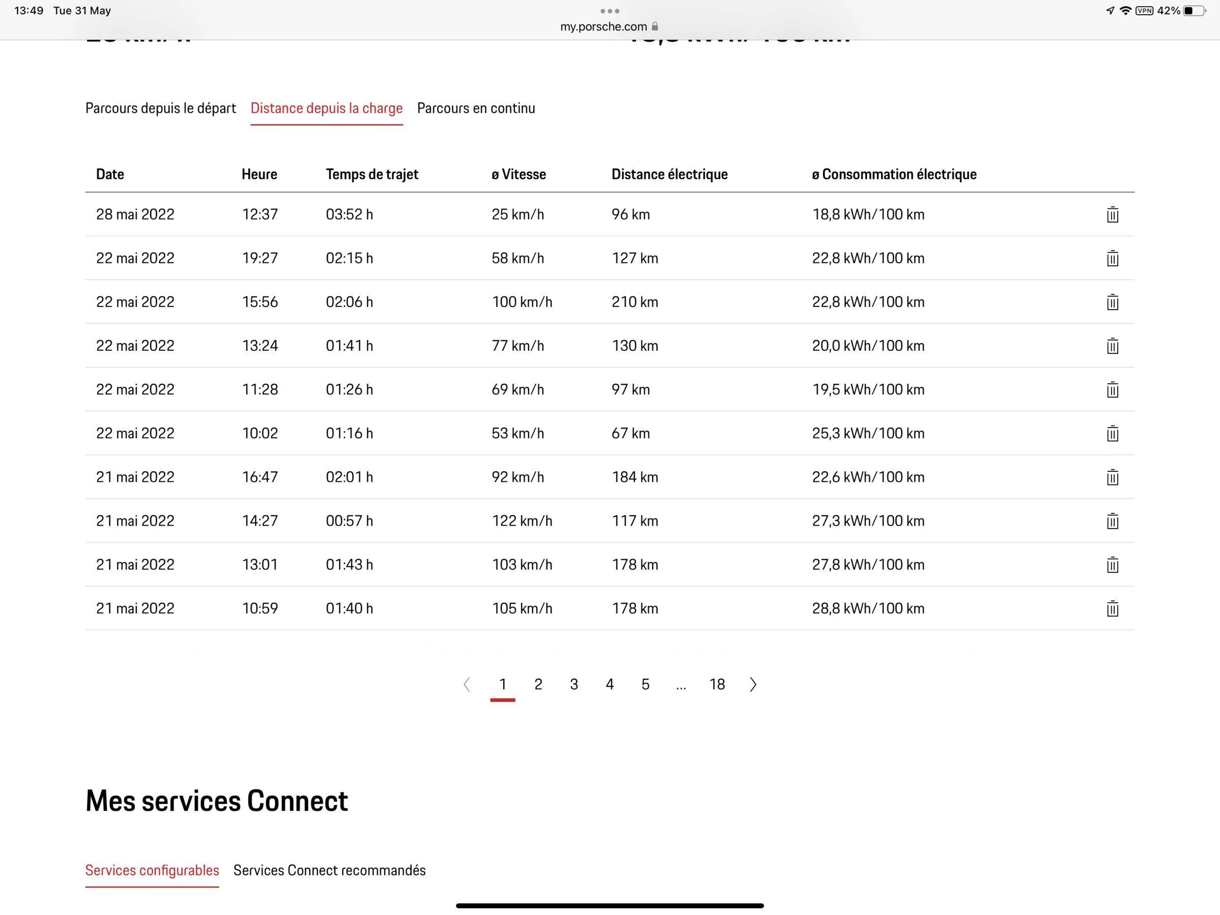

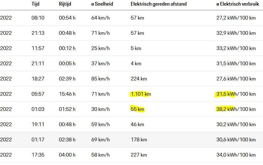

After 12.000kms, my average is 27.5KWh @61kmph... not loaded, no rooftop, but 21".
Below 38,2 is autobahn / 31,5 is mixed autobahn & regular highway

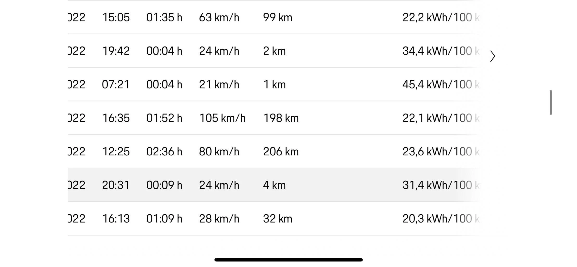

I have done some longer trips. It wasn’t too difficult to get this numbers. I was driving in normal mode and normal AC settings. Some longer parts 130-135 km/h in France (the 195 km average 105 km/h part). 20 inch wheels 4 persons and a dog. 23 degrees outside.
For longer trips and multiple chargers I would take max 300 km when leaving fully charged and preconditioned and then indeed 10 SoC to 85 SoC = 75 % battery.
