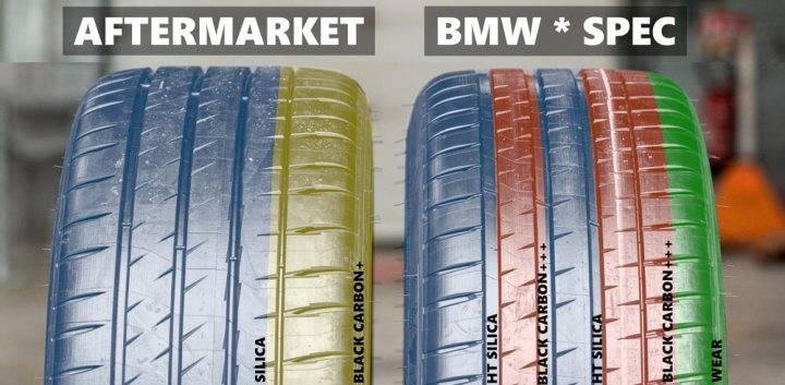

Funnily enough there is a similar argument ongoing on a BMW forum I visit, with regard BMW * rated tyres.
Someone posted this up (admitted it makes little sense to me) which supposedly shows the differences.
Porsche Taycan Rear tyre wear RPorGnLR
