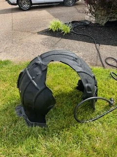

Unlike the hard, smooth plastic 911 wheel arch liners that are sound-deadened in the Resonix video (above in this thread somewhere), Taycan liners are made some soft (yet tough) synthetic material which requires a different approach than the Resonix procedure. The extracted wheel liner is pictured above.

After removal of the liner, I gave it a good soaking with a garden hose to remove any dirt and grime that had accumulated.

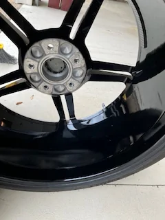

While waiting on the liner to dry (it takes a while), I used the downtime to spiff up the inside of my wheel and clean the exposed area behind the liner. I also vacuumed out some of the gravel around the front fan. I was surprised at the amount of little gravel chunks that had accumulated.

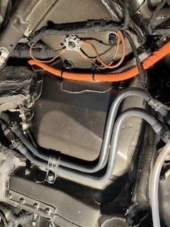

Pictured is the inside of the wheel well closest to the cabin. My intent here was to tap around on surfaces and treat anything that made a drum-like sound with Resonix CLD. The area under the orange high voltage cable and the underside of the front fender were, I determined, the panels most likely to resonate.

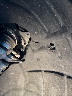

Above is the flavor of Resonix that I selected (Lite CLD). I do not know if it was the best choice or not, time will tell. But I went with the lightest CLD offered to minimize added weight. The box of 10 panels only weighs about 15 lbs and based on the amount used, it should be about enough for the entire car, so maybe it would not have mattered much if I went with a little heavier CLD.
Porsche Taycan Road Noise 1716726751054-h

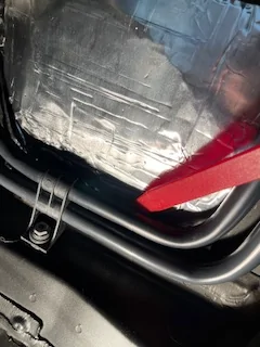

Above is Resonix being installed on one of the referenced panels. Quite easy to install; Resonix sends a free roller with the purchase of their CLD. You will however need a tool (like the interior trim tool pictured) to smoosh some edges into tight spaces.

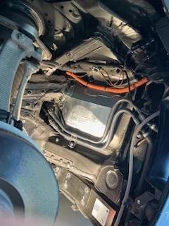

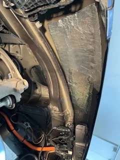

Above is wider angle shot of the Resonix post installation.
Porsche Taycan Road Noise 1716727399315-jz
Above is a shot of the Resonix applied to the inside of the fender. Damn near impossible to get the CLD positioned over 100% of fender interior surface area due tight spaces and a very sticky substance. But you can cover enough of the surface area, especially where it counts, near the wheel wells. After my application, I did a finger tap comparison between the treated driver's side and the untreated passenger side and the difference was significant.

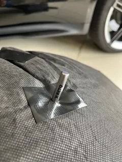

Pictured above is my now-dry liner outfitted with a custom-tailored 3M Thinsulate sound-absorbing vest. As a side bar, I purchased this stuff from a place called "Vanlife" (which appears to be a site dedicated modern nomads who buy stripped down Sprinter vans and convert them into living quarters) rather than from Resonix for a few reasons: Resonix non-woven sound absorbing material is sold with adhesive pre-applied, nothing however will adhere to the fuzzy Taycan arch liners so the adhesive and release-liner would just cause problems; there is nothing magical about Resonix non-wovens as I am 100% certain that Resonix is just "private-labeling" someone else's product (probably 3M); the 3M product is melt-blown HDPE with a polyester backing (the black layer) which makes it ideal for this application; and, the 3M is only about $2/sq ft which means you can experiment with different cuts, patterns, etc. and not waste a bunch of money in the process.
Porsche Taycan Road Noise 1716729013539-u8
Another angle of the arch liner's 3M vest. You can see where I used Gorilla tape to hold everything in place on the liner. The Gorilla tape will stick, barely, to the 3M but hardly at all to the wheel arch liner. This is a good thing because you will want to make some wedge-shaped cuts on the Thinsulate to make it as flush as possible with the arch liner before re-installing. After removing wedges, I "sewed" the seams together with a couple pieces of Gorilla tape. As I was placing the jacketed arch liner back into place on the car, I easily removed the Gorilla tape which I used to hold the jacket in position.

After re-installing the arch liner -- which is crazy hard with one person because the 3M is quite puffy and needs to be re-compressed to get all the screws back into place -- I decided to cram a couple pieces of the Thinsulate sound absorber into the air vent to help absorb tire noise from the vent. My thinking here is that the Mission E's are already so aerodynamically challenged that the benefit of the air vent in terms of range is negligible. And if I feel like it, I can pop out the Thinsulate in the winter, to maximize range, after the 20 inch Sport Aero wheels with Pirelli Scorpions go back on the car. By the way, the Scorpions are not NFO, but they are super silent, supple, really grippy, and don't kick up nearly as much road gunk through the vents as the wider Mission E's with GoodYears. In my case, the black Thinsulate matches the car so it was a no-brainer to attempt.
Conclusion: I took the beast out for a test drive and dB's seem pretty much as before, still with a 3-4 dB increase when the meter is held in close proximity to the lower driver's side door versus the middle of the cabin, thus confirming my theory that I will get more bang for the buck once the door panels are properly treated. Interestingly, the tire noise from the rear seemed more noticeable now that I have muffled the tire noise closest to the driver's seat. Perhaps this is just my mind playing tricks on me. I will keep posting as I continue this project.
