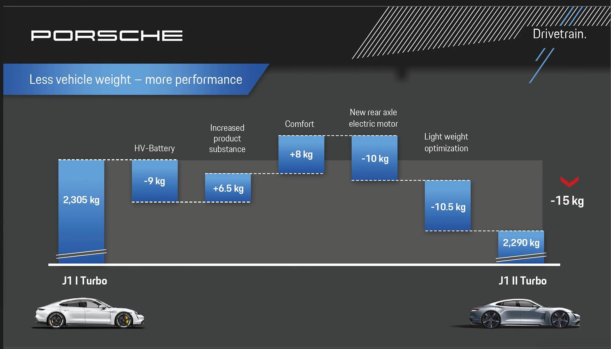

Regardless of this annoyance I still ordered the updated Taycan, this time with the noise insulated glass. Perhaps it helps a little. And perhaps the new tires will be less noisy.
I have noise insulated glass on my CT (20" wheels) but had a GTS loaner recently with standard glass (21" wheels). The extra noise in the cabin was noticeable for me, tyre noise slightly, but more just general outside noise, other cars passing etc. I think you'll like it on the Gen2.
Gen2 also has improved 'comfort' and 'product substance' by adding weight (14.5kg), I assume this will be sound deadening amongst other things.

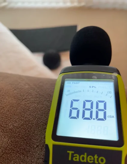

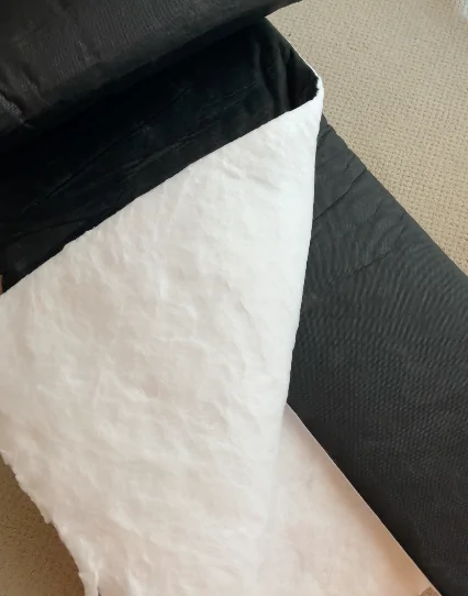

A quick update on Tsingtao's sound deadening project: I ordered Thinsulate and CLD (from separate suppliers) during the first week of May. The Thinsulate arrived and looks great (pics below). The CLD from ResoNix is still in process. FedEx tracking number indicates that a "label" has been created. Maybe this is an anomaly, but if you are ordering from ResoNix do not be in a big hurry. While waiting for delivery of the CLD, I took the opportunity to conduct a most unscientific, but satisfying, experiment with the Thinsulate sound absorber. I politely asked Alexa to play some music through her little noise ball thing. I placed my dB meter on the bed about three feet from Alexa's ball and had her turn up the volume until the dB readings bounced between 68 and 70 (just about where they range in the Taycan at 70mph.) I then covered Alexa's noise ball with the Thinsulate (nothing special, just laid it over top of the ball) and observed the dB readings. Conclusion: The Thinsulate dropped the noise level by a good four to five dBs. I would not take these results to the bank, but certainly a step in the right direction.
