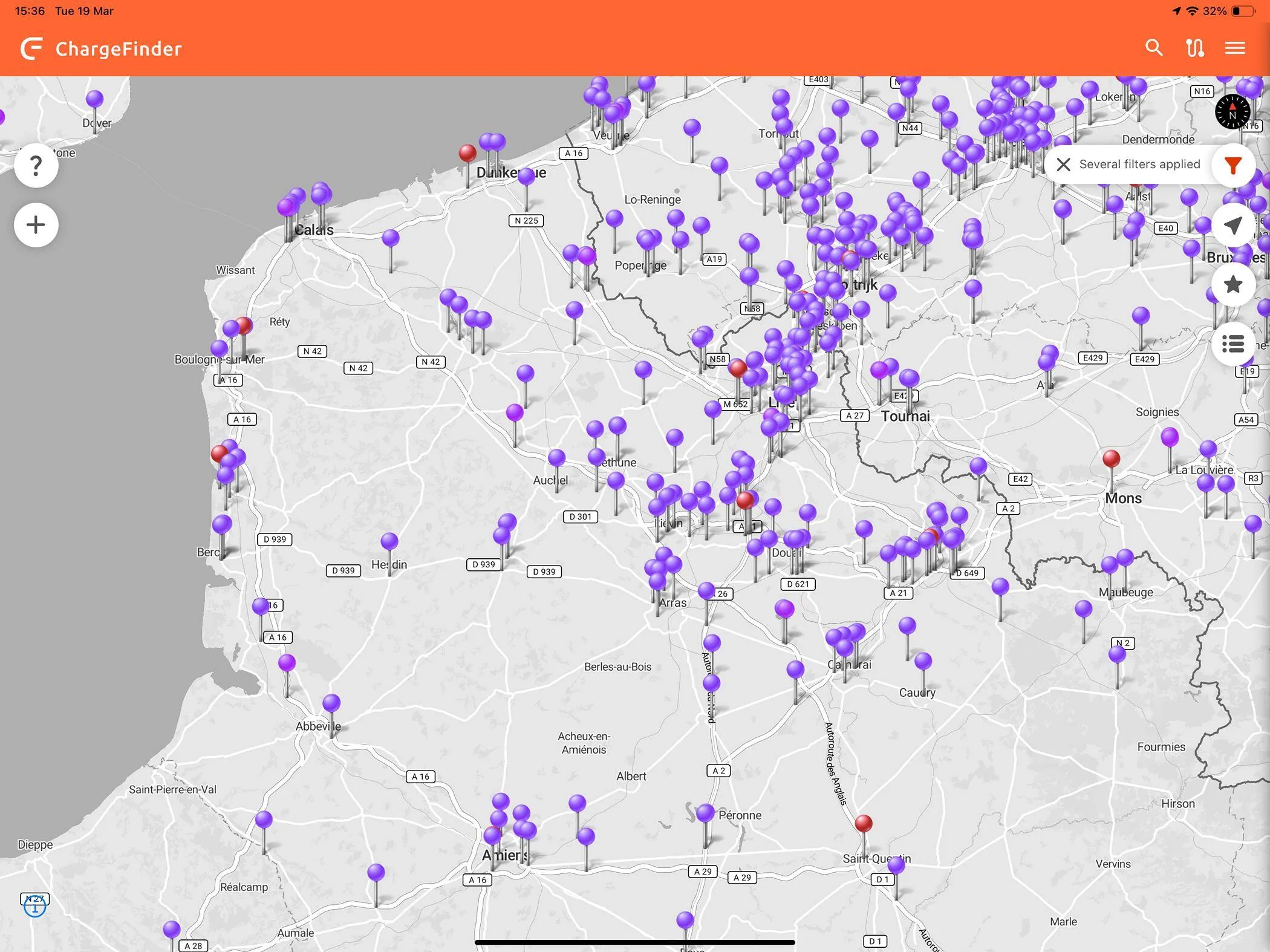

There are a few areas in France , like the north west, where there is a lot of new stations popping up. Apart from that it is a very dense network of high power chargers. Along the main large routes from Calais to Barcelona or the Italian border, I have seen about 30 km between high power >150 kW charging stations. It is more a question of finding the correct app or payment method that is the problem. Porsche Charging Service with app or Card, will easily cater for most needs along the main corridors. But in some more rural areas there can be a need for other methods of payment.
The main providers are Ionity, Total, Fastned and Allego. But in many Lidl outlets as well as Carrefour supermarkets you will find great chargers as well. And Tesla open for all are plentiful.
It is not at all like the U.K. where the infrastructure is quite substandard. Much better in France.
Below a screen shot of stations with more than 150 kW chargers between Calais and Reims. If I try to zoom out the graphics on the iPad can not handle all the stations available!
