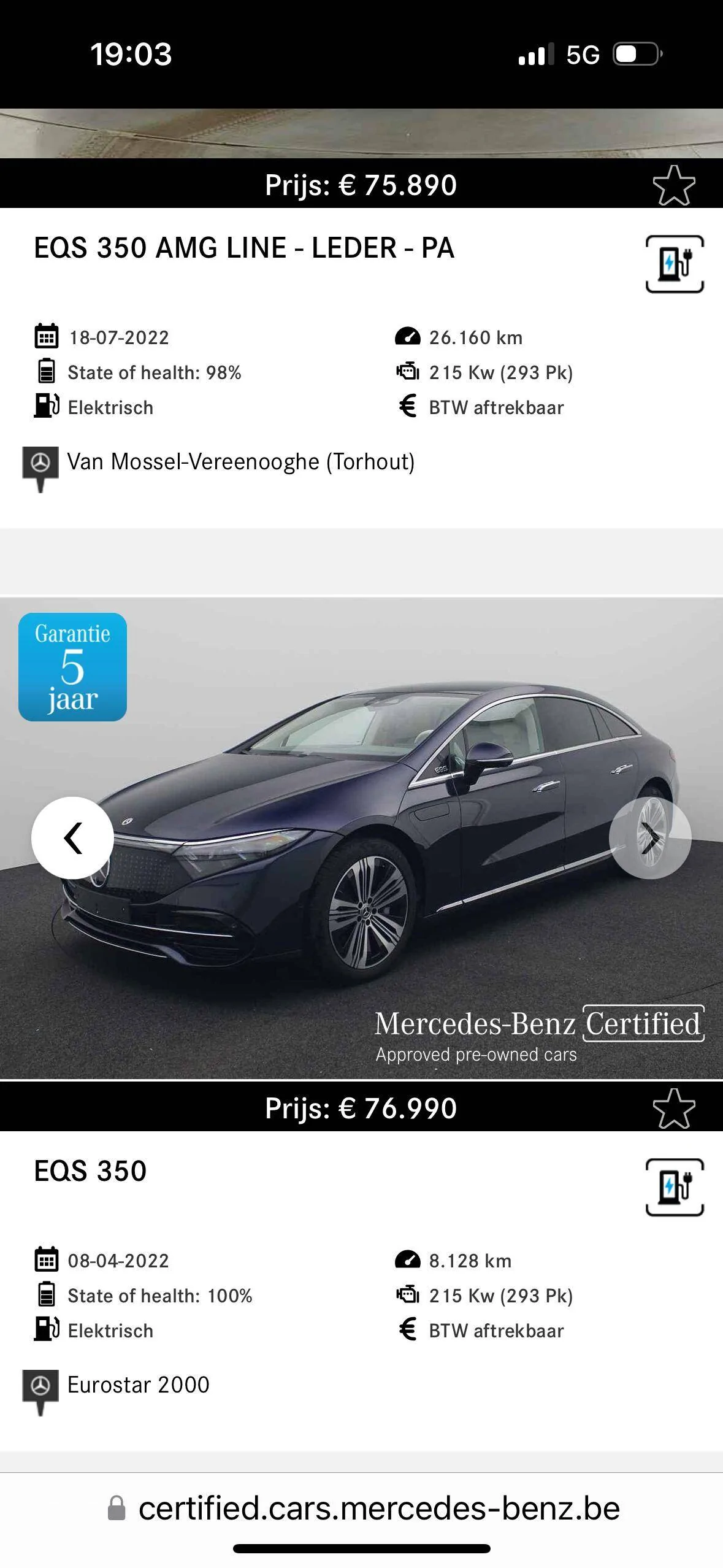

I briefly looked at a used EQS. Mercedes at least in Belgium publishes the SoH in their website. This is one of the things that should be know before buying a used EV.
Porsche Taycan SOH request denied IMG_0568
