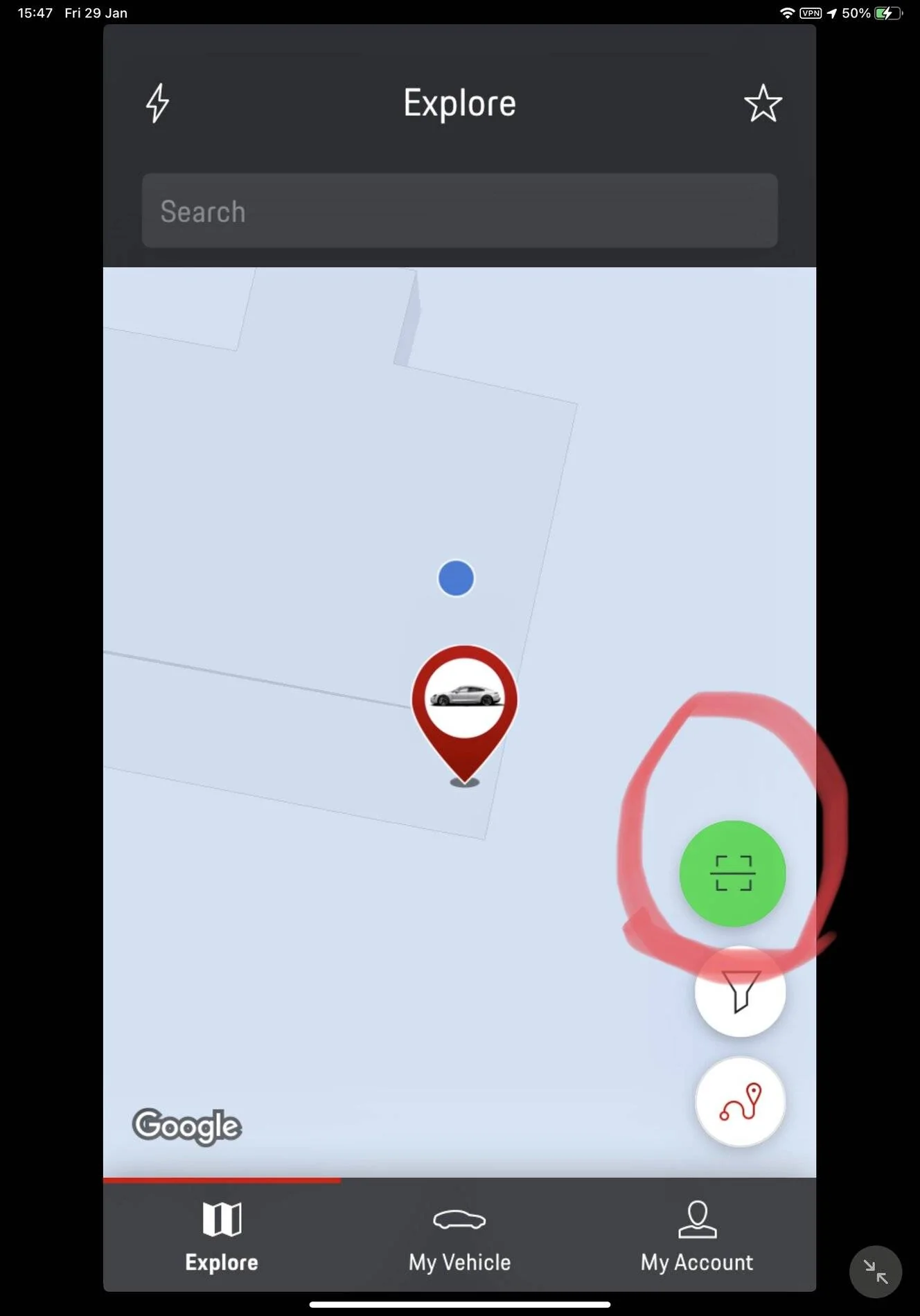

i even took my charger upstairs to my apartment so i could connect to wifi and check for any updates- none. i couldnt sign into my Porsche Connect account on my charger, it kept asking me to scan the QR code, i had from no idea where in the app that facility is
3,907
3,553
If you have an iPhone (> ios11), you have three choices
1. use the camera
2. use the Connect app see photo below
3. use any app that can scan QR codes!
Porsche Taycan Taycan 12V drain issues - caught in the act? 309A1DFB-B4E3-4249-9419-B080AB21506F
The same scan option in the Connect app works with charging at Ionity
