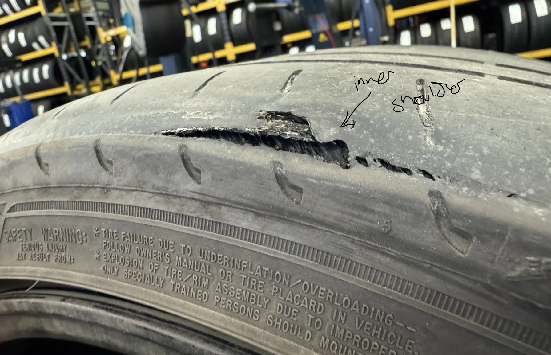

Is there anyone else not experiencing this issue? What car/tires/wheel size are you running? Maybe we can figure out the trend here.
I
If this is the case, then shame on Porsche. Selling a car with a suspension adjustment that, if chosen, will result in a catastrophic tire failure is about as bad as you can get from an engineering standpoint. I'm not as sure as you about the cause... Has anyone done an alignment measurement in the lowered position?
You can't officially adjust the front camber (though it must be set/regulated from the factory by virtue of the bolt positions) - only balance it out from left to right:

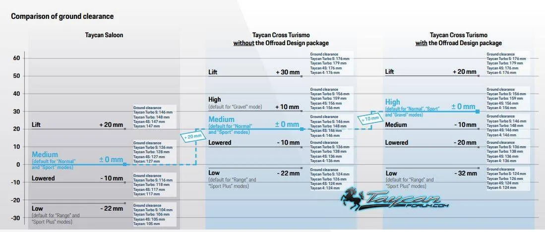

Porsche claim to have resolved an initial build issue (excessive camber) by presumably adding slotted joints in the BiW:
https://static.nhtsa.gov/odi/tsbs/2021/MC-10187852-0001.pdf
@TaycanRob showed camber angle increased by 0.345° between normal and range (-22mm) on a 2025 Turbo:
https://www.taycanforum.com/forum/t...l-catastrophic-tire-failure.16788/post-311337

.345 deg increase in camber doesn't strike me as enough to cause inner sidewall failure. Possibly the toe adjustment is off - I guess there is a special tool required, and inner sidewall is very sensitive to toe adjustment. I'd ask more experienced minds to weigh in here.
You can't officially adjust the camber (though it must be set/regulated from the factory by virtue of the bolt positions).

Thanks so much for these references. I was using the door sticker information, figuring it was specific to my vehicle‘s weight and configuration.

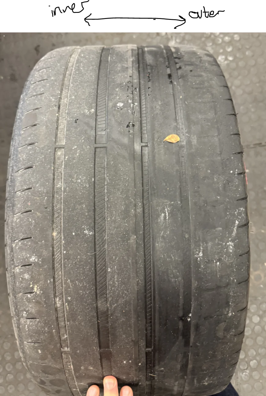

I had both rear tyres replaced today and wonder if my findings show excessive tyre shoulder wear is not due to camber settings? To explain:
Both (original) tyres were well worn (to legal limit-ish) having done now ~16,000miles. The wear was 'relatively even' but not perfectly even:
- the left rear showed 1-2mm more tread wear on the inside of the tyre (indicating negative camber as we'd expect). There was inner shoulder wear causing delamination most the way round the tyre.
- the right rear showed 1-2mm more tread wear on the outside of the tyre (indicating positive camber), yet still the tyre had significant inner shoulder wear (not as much as the other, but enough to show cords and tread delamination).
So even if you (wrongly) set up your car with positive rear camber, the inner shoulders will still wear prematurely.
Going to speak to some specialists about doing geo's (as my right rear is clearly wrong) but I'm loosing faith adjusting camber will ever prevent the problem (particularly as on the front, you can't reduce camber, only balance it):
https://www.taycanforum.com/forum/threads/geometry-done-at-center-gravity.28453/
I have to agree - if it was a camber problem, you’d see uneven tread wear. I didn’t see that on my tires, and haven’t seen it on posters tires. Something very strange…
Most people in these threads DO have uneven tread wear. If you have it on both inner and outer, then your tires are just underinflated.

I don't believe Claude as:
1) I don't have RWS on my GTS (but the tyres that just came off tell me there is something very wrong)
2) The air suspension does not 'constantly' adjust height - only when going through set points etc. I don't see how this is any worse than normal bump/roll camber (which may be the root cause), but not because of air suspension - which is usually just trying to reach a set-point.
I agree with Claude's recommendations, but wouldn't flip tyres (against tyre design) and personally will be running higher pressures.

If Claude's diagnosis were accurate, every single Taycan would exhibit this issue. It is only a small percentage and almost all of those have verified that they run their car in the lowest suspension setting which is more indicative of camber creating the uneven wear.
Surely can't be camber - here's a (badly set up) tyre (with wear indicative of positive camber) that also exhibits the excessive inner should wear.
Porsche Taycan Taycan Problem - potential catastrophic tire failure 1767113322835-77
Porsche Taycan Taycan Problem - potential catastrophic tire failure 1767113354450-gy

Running high tire pressure might ameliorate the problem, but we still don’t have the cause. Could it be rws? Anyone see this problem without it?
Fish Fingers
Feb 20, 2021
50
2,534
3,285
Sold
I had the problem and didn't have rear wheel steering.
I also had a RWD without Sport Chrono, so there was no Sport Plus setting and I very seldom used it in Low ride height or Range mode.
