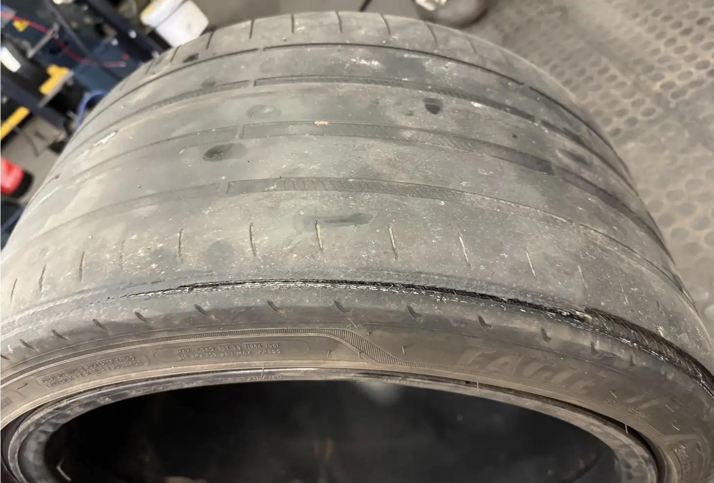

I'm going to throw this out there - it's an interesting possibility. What if we're not looking at a shoulder wear problem, but a separation of the tread/sidewall due to excessive stress?
acull2000
Sep 17, 2024
56
Warwickshire
Taycan GTS
I'm going to rule that out since there's always wear (externally) in a similar pattern around the shoulder, before the separation occurs. Even if it's not uniform, the wear always seems to be a precursor to the separation (eg from other tyre today):

Heres how mine looked.
Porsche Taycan Taycan Problem - potential catastrophic tire failure IMG_9943
Front.
Porsche Taycan Taycan Problem - potential catastrophic tire failure IMG_9944
Rear.
As i say - given my experience of performance cars I feel this is actually good for the use.
