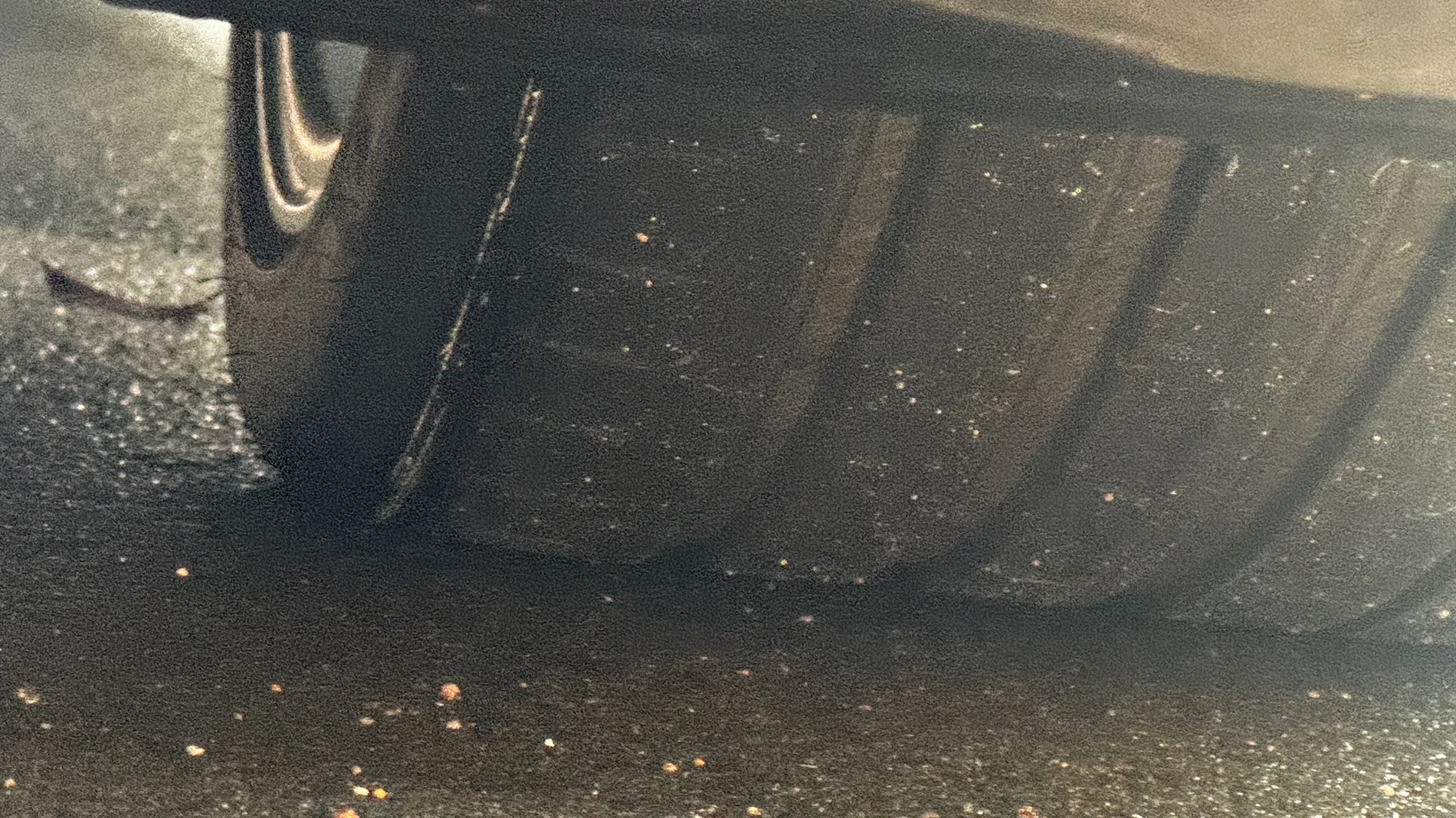

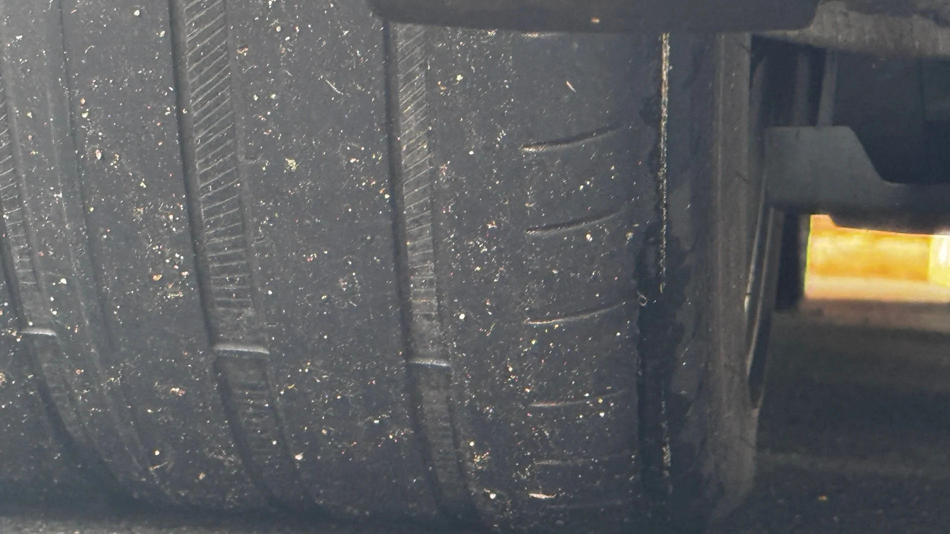

I have just experienced the same wear on Bridgestone Asymmetric 3 NF0's. Car is a GTS.
BUT - I have had the fronts on for circa 17,000miles and the rears for circa 19,000miles. This is a 2tonne+ 600Bhp car; I see that tyre wear and ultimate giving up as acceptable.
To put this is perspective my C8 RS6 would eat a set of Pirellis in about 15,000miles. Thats a car of similar weight and performance.
I have read a few instances on this thread of people complaining about wear after 20k?? These cars are not 190bhp fwd diesels. The tyres are fighting for their life from the moment they are fitted.
Heres how mine looked.
Front.
Rear.
As i say - given my experience of performance cars I feel this is actually good for the use.
Cheers.
Totally agree - my rears did ~16000miles which I’m happy with, given the tread was worn down pretty evenly to the minimum (eg I got my monies worth, and am not being needlessly wasteful).
What we’re trying to avoid is ‘premature’ failure that only some people seem to get on the inner shoulders. Yours look down to wear markers on rear and close on the front, so I’d say this is fair game. My fronts had to come off after 8000miles with still 4-5mm tread on them, due to the shoulders being down to canvas 🫣

This doesn't look like wear to me, it looks like a structural failure of the tire causing delamination. Your wear bars are still indicating some good tread left on the inner shoulder. As I said earlier, I don't think this is a tire wear issue, I think it is a stress issue where the tire delaminates due to excessive stress. The stress may be caused by improper alignment in certain settings or situations. I can say that my delamination was NOT caused by agressive driving. I don't drive my car like that on public roads.
This is a very interesting question - what is the cause of the delamination? It is definitely a basic defect in the car, and I would encourage everyone who has experienced this to report to the NHTSA.
