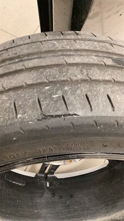

Once again, delamination of the r.f. tire with plenty of treadwear remaining. My original post was the r.r. tire. Of course, I'll have to buy a brand new tire. My main concern is how do I inspect for this so I don't have a catastrophic failure. I have absolutely babied this car for the last 3 years - not one inch of hard driving, and NO launches, no 'lowered settings'. I can't do anything else. This is just nuts.
Porsche Taycan Taycan Problem - potential catastrophic tire failure Image 6-23-26 at 3.17 PM
acull2000
Sep 17, 2024
61
Warwickshire
Taycan GTS
Not a lot to do with hard driving or modes.
When you have the new rubber on, get toe checked and adjusted to spec on all four wheels. Then make sure your tyre pressures never fall below the minimum pressure specified.

Alignment and TP have always been checked ok. And most importantly - it these were an issue, it would show up in uneven treadwear. Treadwear is exactly as you would expect with properly aligned and inflated tires. This is clearly a delamination of the tread from the sidewall.
acull2000
Sep 17, 2024
61
Warwickshire
Taycan GTS
What TP do you run (on which wheels/tyres, which body shape and which version of Taycan eg turbo)?
