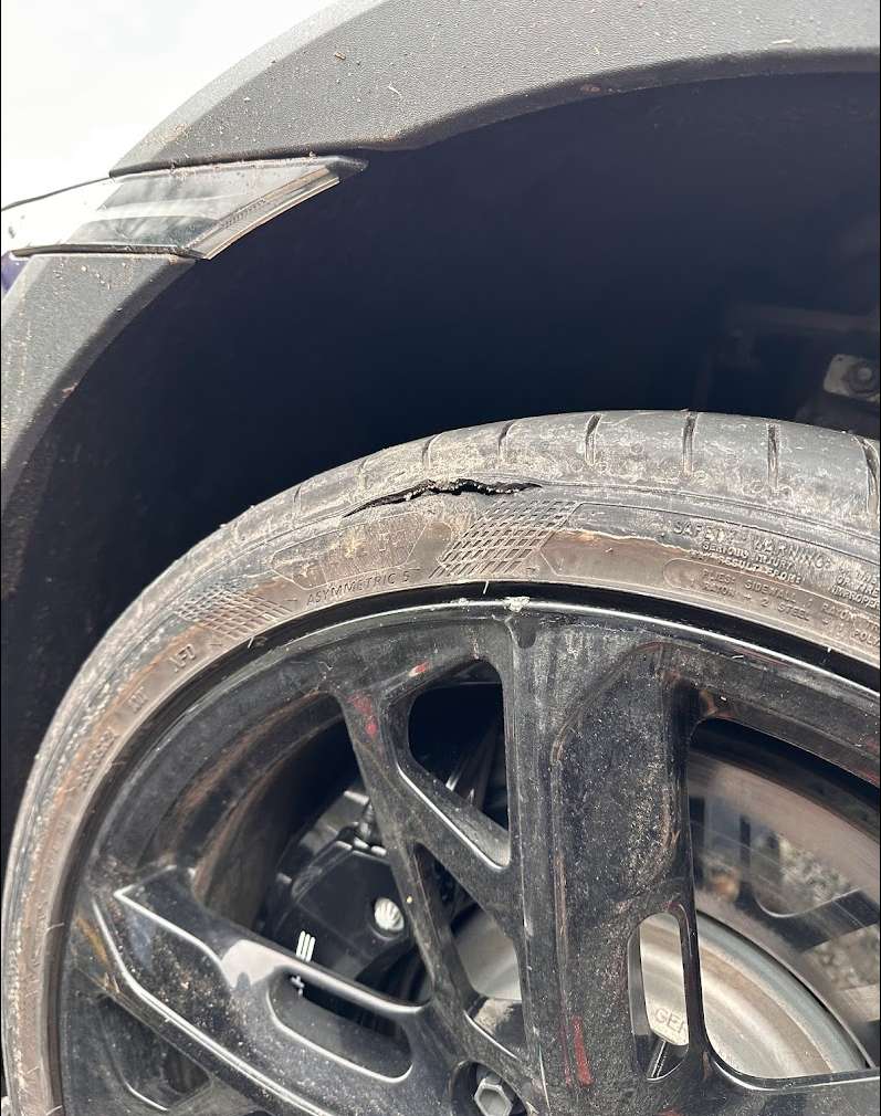

Count me in to the club! I've had both fronts fail on me in the past couple of months with weird inner shoulder punctures, so I was even keeping an eye on the tyres generally, but there's just no way to see the very inner edge on the rears without it being up a lift or crawling under the thing. Both rears were holding pressure fine and appeared evenly worn and with plenty of life left, yet both have completely failed at the inner shoulder which was only apparent when it went in for service. This car is 99% used in Normal mode and 95% of its life cruising on the motorway.
We have lots of experience with performance cars and with wheel and suspension setups where I work and still this is a surprise. On an alignment rig, the toe and camber appear fairly normal when the car's stationary, though we note 1 degree of negative camber at regular ride height and 2 degrees negative at the lowest setting. I see a lot of people suggesting this is solely wear due to negative camber, but in our experience Toe Out is always a factor.
My personal suspicion is that due to the weight of the car and the compliance of the bushes, the dynamic alignment is quite different to the static one and either when accelerating hard or simply when cruising at speed, we're getting an increase in Toe Out combined with the negative camber which the relatively low and stiff sidewalls of the tyre aren't able to compensate for.
Use on motorways might actually exacerbate the phenomenon as I believe the Taycan automatically drops to one of the lower settings at 50-60mph. And as I think you're intimating, I'm convinced, the lower settings is a good part of the problem.
Are you able to set toe and camber at the lowest settings? "Logically" (I think!) if this is dialled out when likely to be at its worst, it should prompt wear the other way at higher chassis settings? (Though presumably at the expense of some handling characteristics?).
The seriously irritating thing, as your measurements show, is that there's likely about a third of the wear left across the rest of the tyre. At £1,200 a set (ish) that's serious money being spaffed on each set. Not to mention not exactly being great for the environment.

Yeah, I'm currently on £1,700 on tyres in the last 3 months as both fronts went on the inner edge, I then had to buy the rears at the dealer and to top it off I hit an unavoidable pot hole yesterday which meant instant tyre death ?
Porsche Taycan Taycan Problem - potential catastrophic tire failure zzzscreengrab1739735281001
At this stage I'm just feeling like the 21" wheels are too fragile a solution for this car and UK roads. I'm going to spec up something good looking in 19" where I can run some chunkier tyres and probably not go as wide in the rear cos there's no way I need a 305 width tyre there. I'm going to try a few options we have at work, see what clears the brakes and work out what widths and offsets I need for them to sit in roughly the same place as the current wheels.
