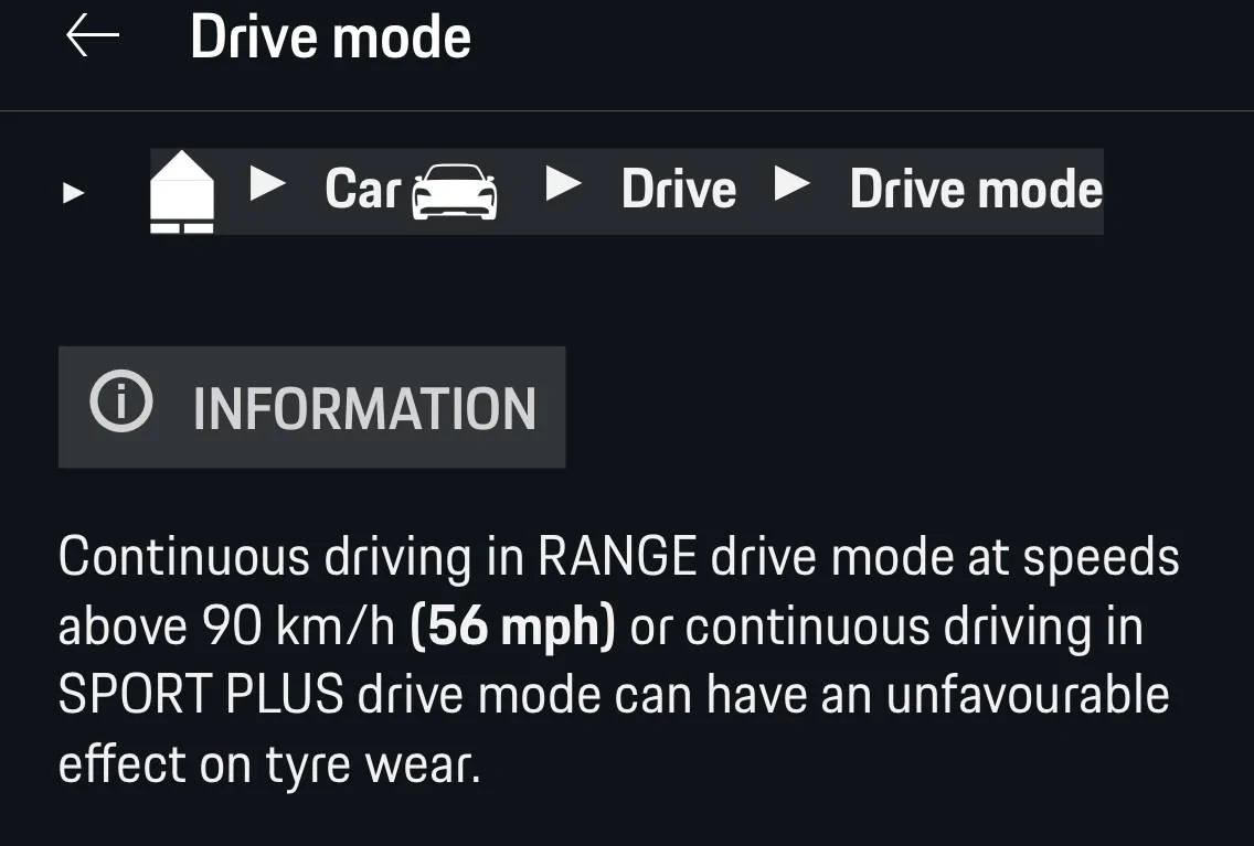

2025 manual now acknowledges excessive tyre wear in range and sport plus modes
Saves money on engineering I guess.
By MY30 they might be saying "and you should look to replace your tyres after only 1in of the inside of your tyres are worn. Please check for canvas every 5k miles."
Have they also changed the software so it doesn't automatically drop the car at speed?

Almost a year after OP first posted about tire wear problem, and reported it to NHTSA, Porsche has resolved the problem by changing the owners manual.
Edit: no change for 2022 manual in MyPorsche app so tire wear problem limited to MY2025s..... :facepalm:
@daveo4EV This is similar Porsche response to PMC+ overheating. "Operate it at 50% capacity"

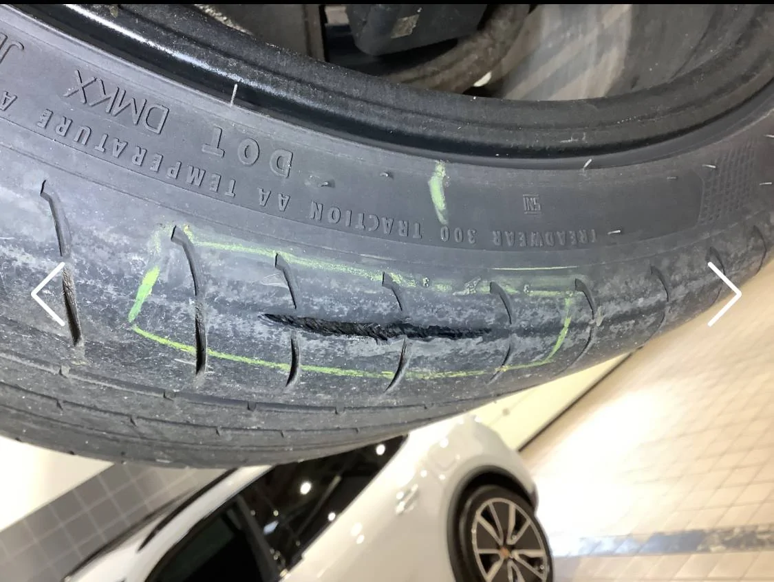

The crazy thing about this kind of tire 'failure' is that conventional inspection methods don't work. The inner tread line doesn't indicate any excessive wear, which would occur if the camber were out of spec. The tires in the photo were inspected at Porsche before they were installed, and they failed a few thousand miles later. Definitely, the inner cord was almost exposed when the tires were installed, but the tread depth across the tire was normal.

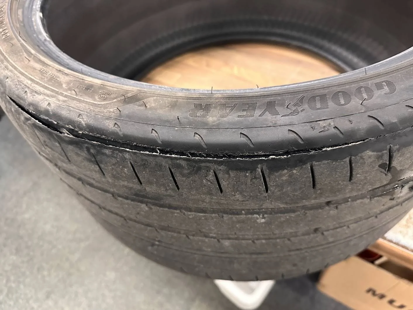

Just had to have both my rear tyres replaced on my 2020 4S; nail on OSR and down to cords on shoulder on NSR. Wear across the treads was as expected. Ive owned the car for 11mths. No unusual pressure warnings. When the car was in for brake pipe recall in October the tyres were within spec but getting towards 4mm. They did note that all tyres were Goodyear 5’s, except NSR which was a Goodyear 3, so recommended a pair of years.
i chose not to have tyres done at this point and expected to need them now around MOT time. I’ve done 2-3k miles since October. Car has now been aligned in Normal and Sport+ height and only slight adjustment to toe was needed.
We have put this wear down to catching the inner edge on something like a pothole. I have a vague memory of telling the wife I was annoyed one day for clipping my wheel, I believe it was a rear inner edge but can’t recall now exactly what and when. But seeing this thread maybe it was not that ?
i mostly drive in normal mode but car is then often lowered from driving 60+ from that setting.

Unless you're driving constantly on a pothole, I doubt that's the cause.
Too many of us have had the exact same way, in different countries, specs of car etc.
The other thing I forgot to note is tyre pressures.
Am watching mine carefully at the moment, and keeping the rears above 40psi.

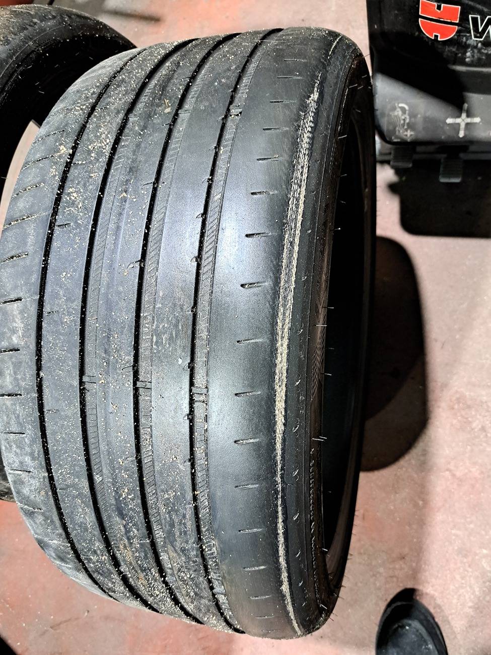

I too am trying to avoid the range and sport plus modes, but after 15,000 km the fronts are as in the photo.
Porsche keeps telling me that the GTS and Turbo S are "just like that".
This seems like a rather evasive explanation to me.

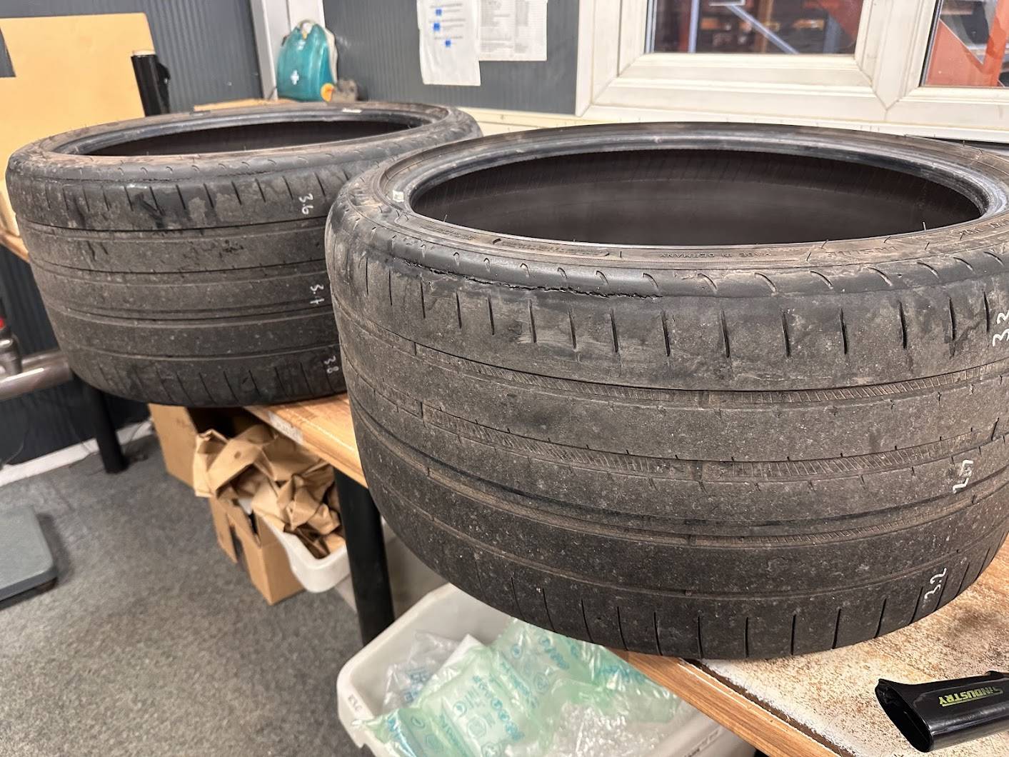

Count me in to the club! I've had both fronts fail on me in the past couple of months with weird inner shoulder punctures, so I was even keeping an eye on the tyres generally, but there's just no way to see the very inner edge on the rears without it being up a lift or crawling under the thing. Both rears were holding pressure fine and appeared evenly worn and with plenty of life left, yet both have completely failed at the inner shoulder which was only apparent when it went in for service. This car is 99% used in Normal mode and 95% of its life cruising on the motorway.
We have lots of experience with performance cars and with wheel and suspension setups where I work and still this is a surprise. On an alignment rig, the toe and camber appear fairly normal when the car's stationary, though we note 1 degree of negative camber at regular ride height and 2 degrees negative at the lowest setting. I see a lot of people suggesting this is solely wear due to negative camber, but in our experience Toe Out is always a factor.
My personal suspicion is that due to the weight of the car and the compliance of the bushes, the dynamic alignment is quite different to the static one and either when accelerating hard or simply when cruising at speed, we're getting an increase in Toe Out combined with the negative camber which the relatively low and stiff sidewalls of the tyre aren't able to compensate for.
It seems to be a performance EV and low profile issue which isn't isolated to the Taycan.
Tesla model S (especially Plaid) has exactly the same wear issue with its 21" wheels and tyres it seems. Many of those are solving the issue by either swapping to the 19" wheels and tyres or spacing out their suspension top arms to reduce the negative camber with adjustable arms or products like this https://teslamotorsclub.com/tmc/thr...on-2021-model-s-lr-plaid-w-evpe-shims.324812/
