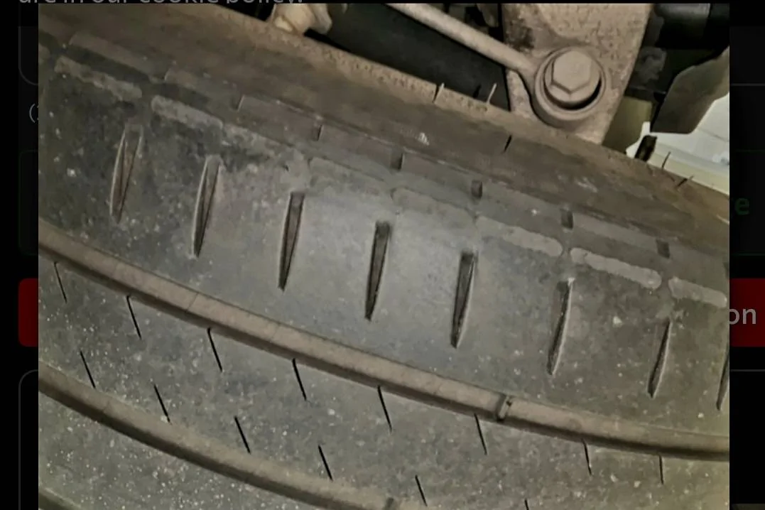

Was the wear on the rears at the inner shoulder? I'm wondering if this has anything to do with 4 wheel steering, or some combination of 4WS and/or lowered ride height.
Yes... It was the same wear that everyone else reported. Inner side/shoulder particularly on the rears.

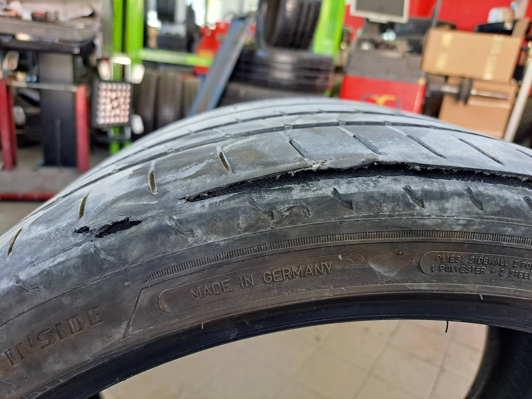

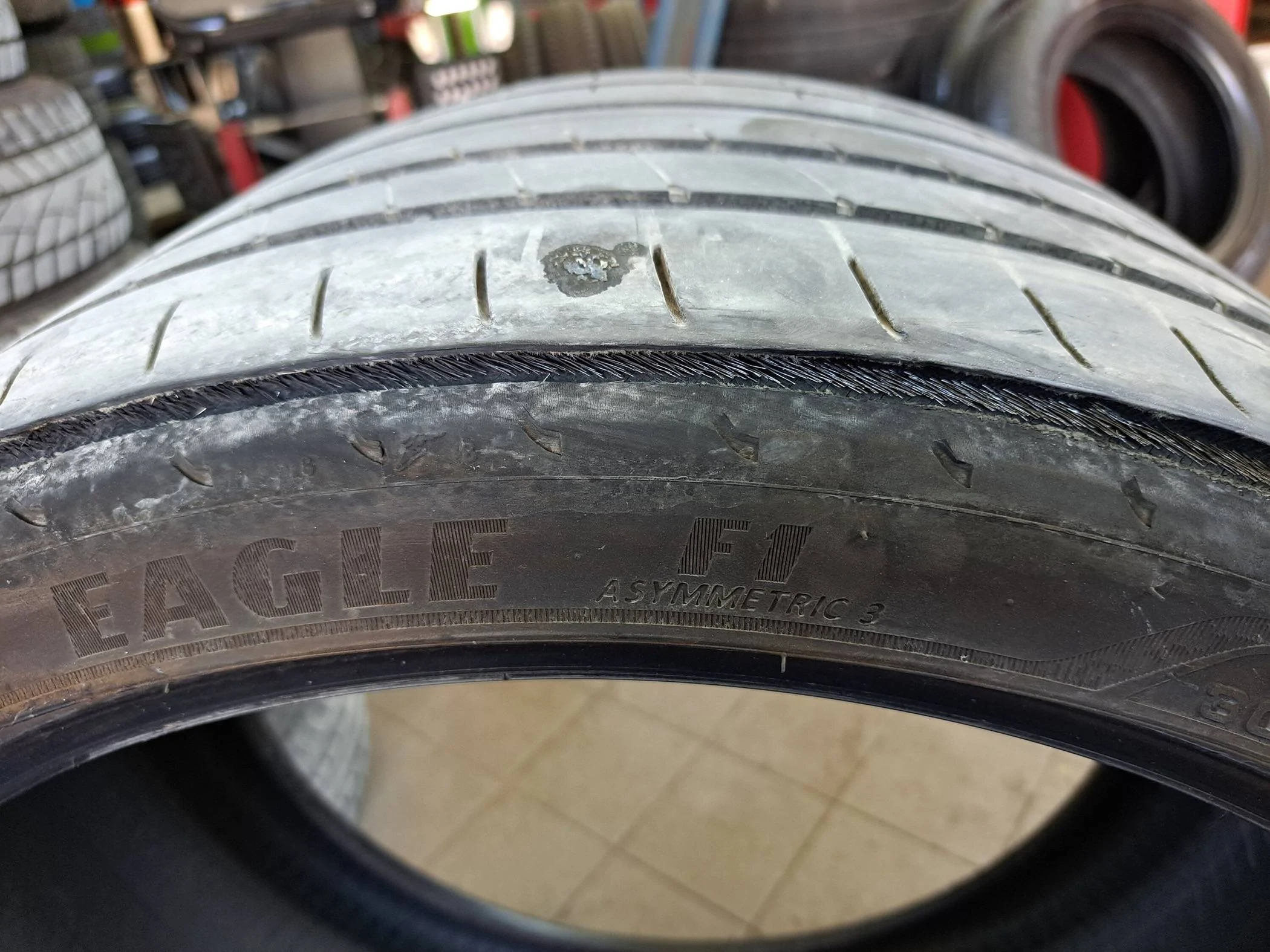

I'm reposting the pics of my Goodyears that had the severe failure. Note there was virtually no unusual wear on the inner tread. The tires were both still in spec if you just measured the tread depths. I was driving in 'lowered' mode most of the time, and do have 4ws. This is definitely a serious issue, just not sure about the cause.

I'm reposting the pics of my Conti's that had the severe failure. Note there was virtually no unusual wear on the inner tread. The tires were both still in spec if you just measured the tread depths. I was driving in 'lowered' mode most of the time, and do have 4ws. This is definitely a serious issue, just not sure about the cause.
That looks like a manufacturing or design defect?? Did you do track days on this tyre?
submatrix
May 14, 2021
609
436
2021 Taycan
Those are Goodyears, no?

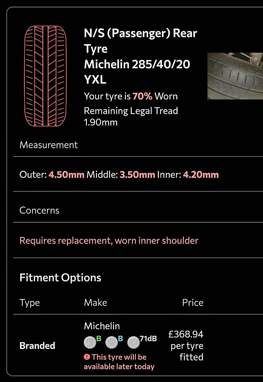

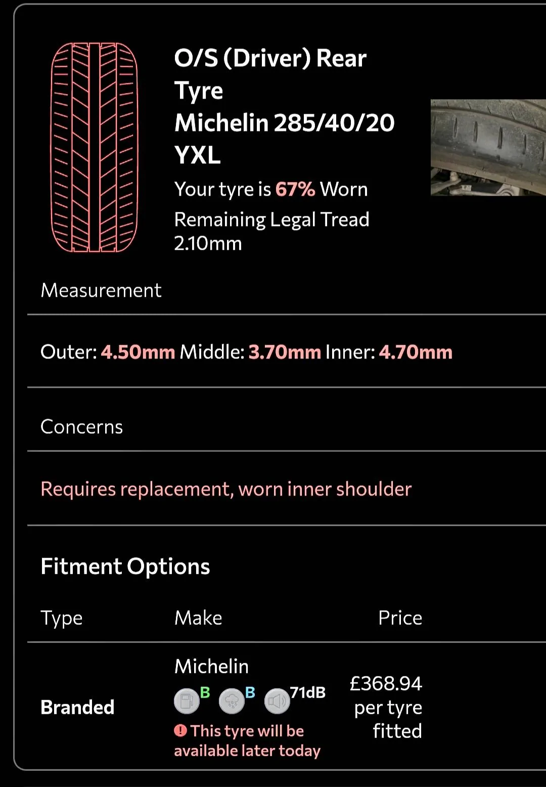

I know I am answering my own post here, but these were the tyre reports for these tyres (noting the tread depth readings).
Porsche Taycan Taycan Problem - potential catastrophic tire failure Screenshot_20240119_051638_Samsung Internet
Porsche Taycan Taycan Problem - potential catastrophic tire failure Screenshot_20240119_051651_Samsung Internet
Thought I corrected the post, but they are Goodyears. And no - never tracked or even really stressed the tires. I race the car pictured, and get plenty of G force on the track. No way I'm going to push this 5000 lb+ car around the track - I'd go through a set of tires in an hour.

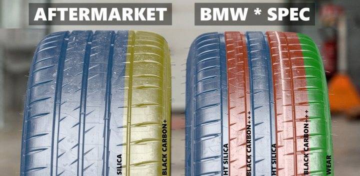

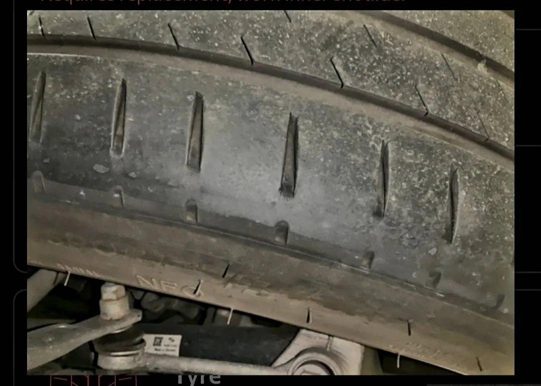

Just trying to look into this a little further.....
On the other thread about it, the OP @DerekS said he was told it was the compound on the inner tread.
https://www.taycanforum.com/forum/threads/check-your-tires.8611/post-202307
I remembered tyres were also being discussed on a BMW forum some time back and whether BMW * marked tyres were actually any different.
Someone posted this pic (from Tyre Reviews) showing the different compound between the * tyres and standard.
Interesting that the BMW * marked tyres are highlighting the wear on the shoulder in green.
I am no expert on these things(!) just trying to find some definitive answers, as generally I nurse my tyres quite well and my knackered Taycan tyres at 16k was a shock.
Could it be something to do with the NFO tyres?
I have non-NF0 on the rear now (Hankook Ion Evos...but diff. size to the ones just Porsche approved) so will see what happens with those....I suspect it will take a while to find out though (likely 12mths at least).
