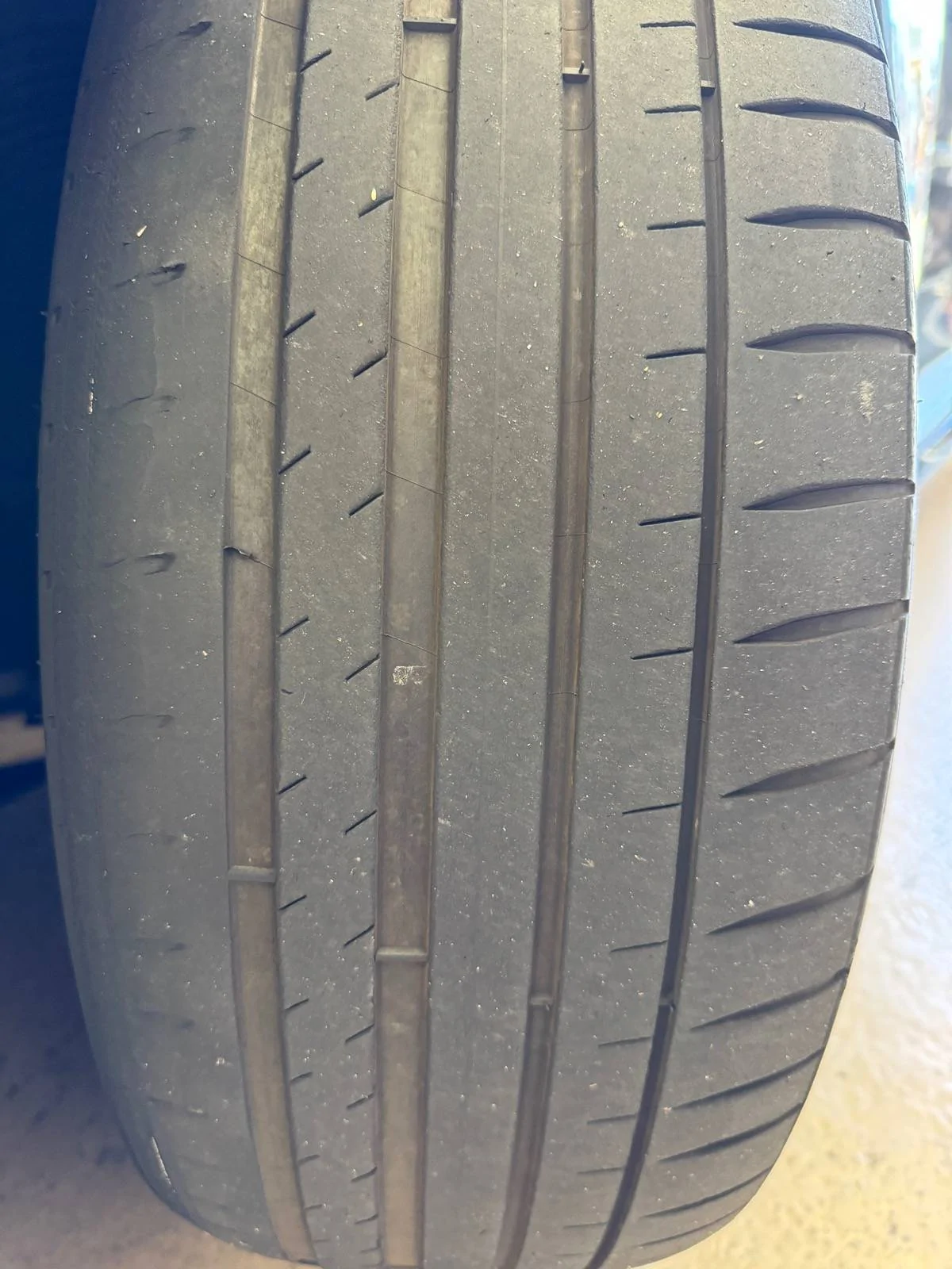

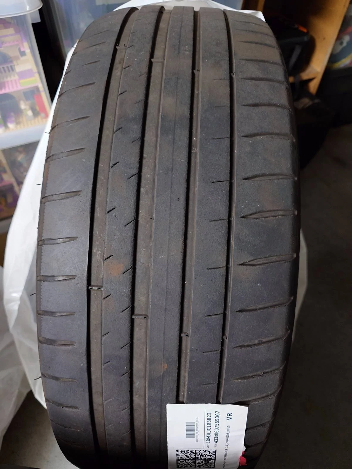

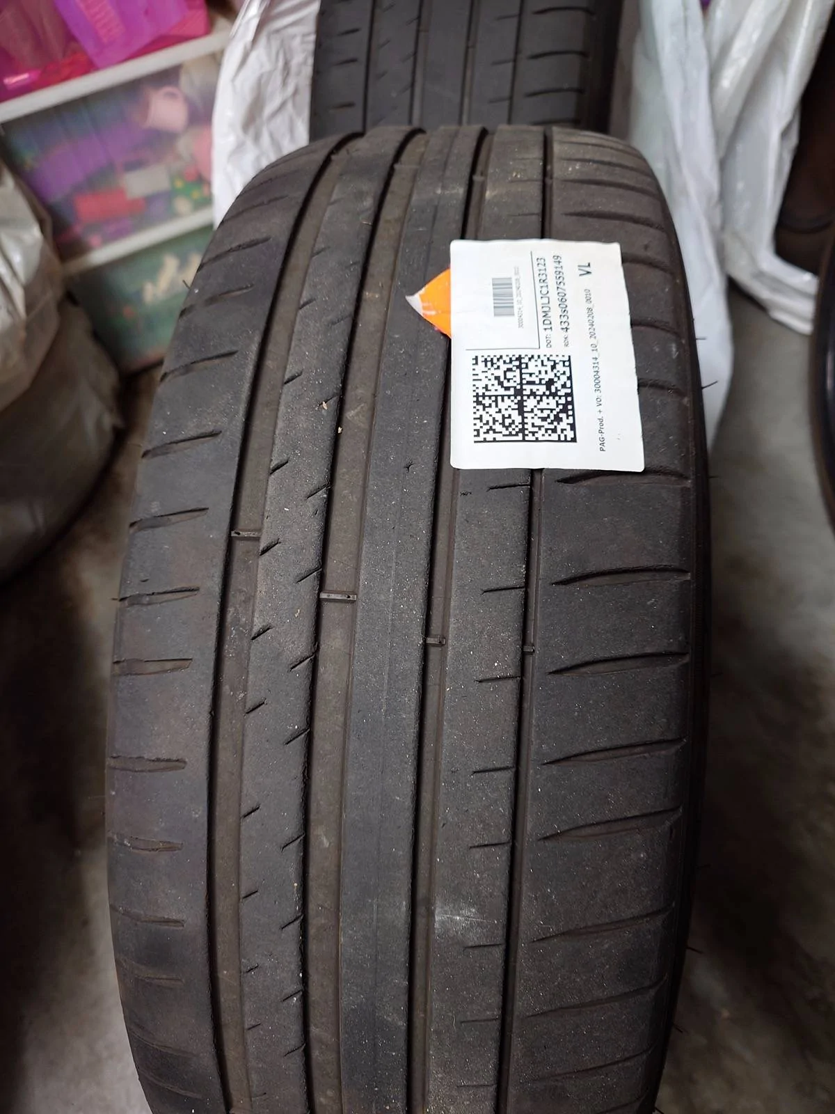

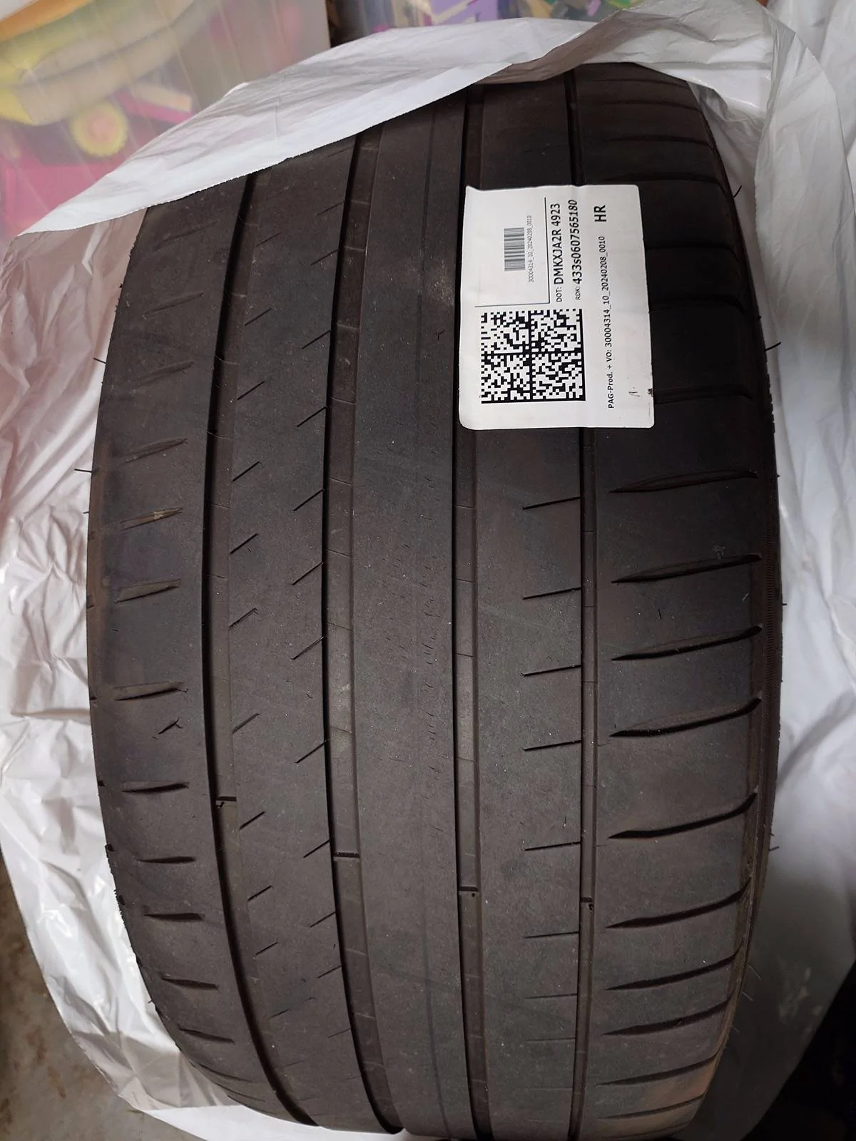

after 56k km / 35k mi , about 75% in lowest setting (range/sport plus) on highway
I find the range mode excuse a bit easy from the dealer.

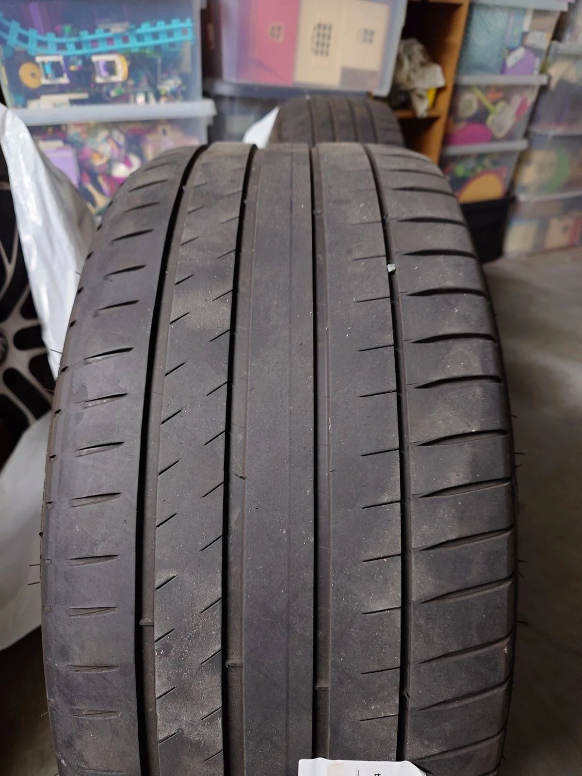

This is very interesting data. I wonder if the 'inner shoulder wear' on the rear tires is due to driving in 'lowered' mode? I did that on a regular basis, and had an actual separation of the sidewall from the tread on both rear tires without significant wear on the tread. For everyone who's seen this - are you driving a lot in lowered (range) mode?

I guess the difference in height between "normal" and "sport plus" is pretty significant, so without some other automatic adjustment, it's going to be out of alignment. But like Vim, I've never seen wear like this - it's almost like the car's riding right on the inside corner of the tyre....or something's catching it.
