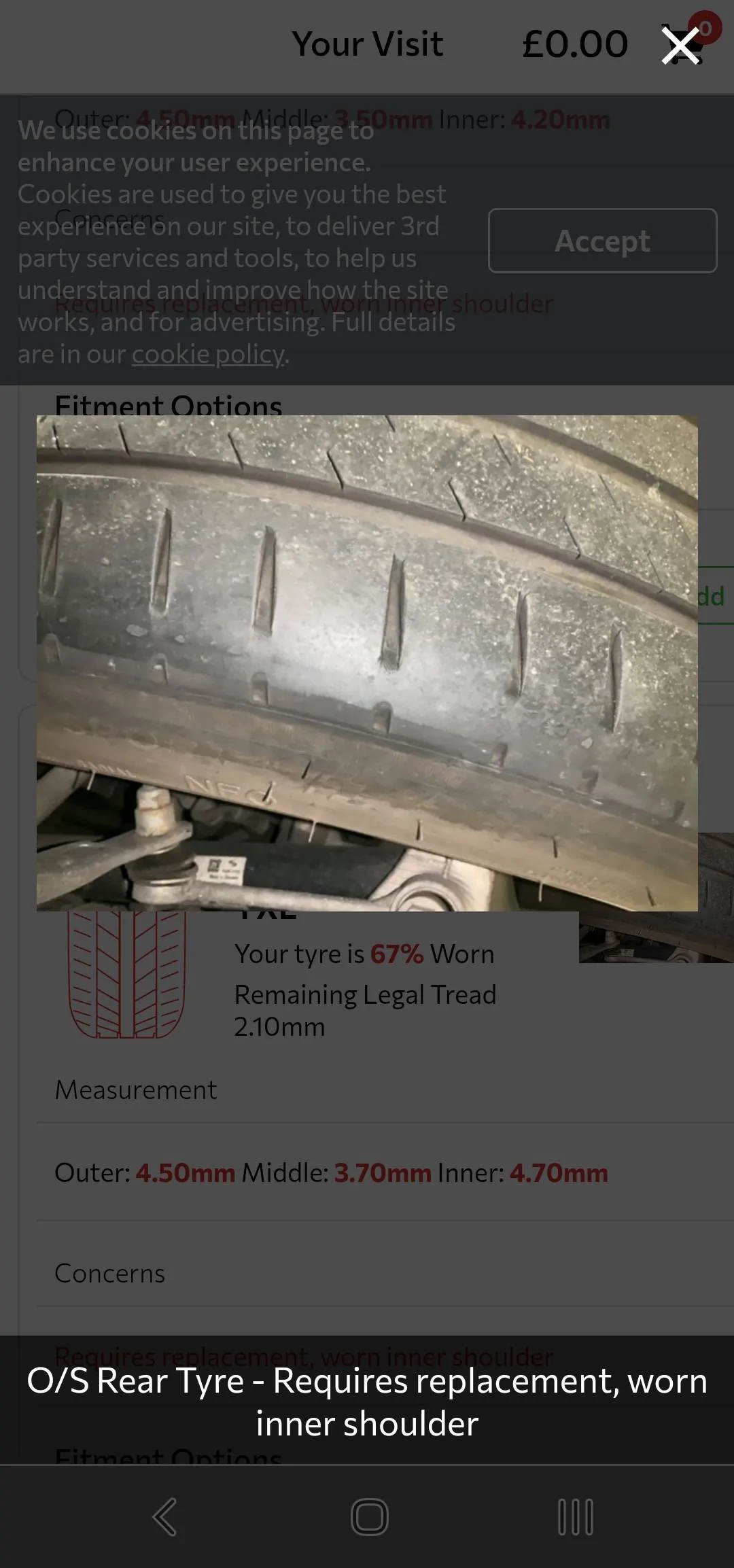

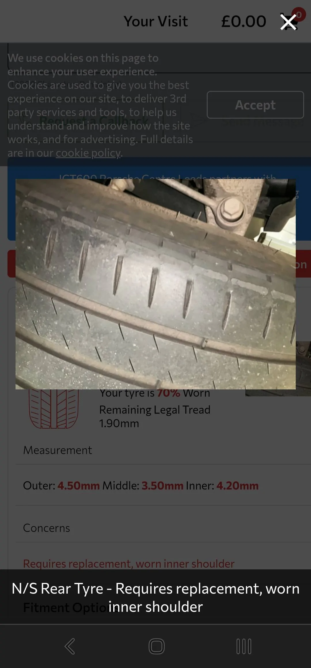

My rears were replaced last week after it's 1st service.
RWD / 20" / no RWS / Michelin PS4 / 16k miles.
I knew they were ready for change soon (states 70% worn) - but it was both inner shoulders that I was unaware of, until it was up on the ramps for service.
This was from the dealer service report.
I'm seeing the beginnings of a separation of the tread and sidewall in this pic. This is a massive problem...:oops:
