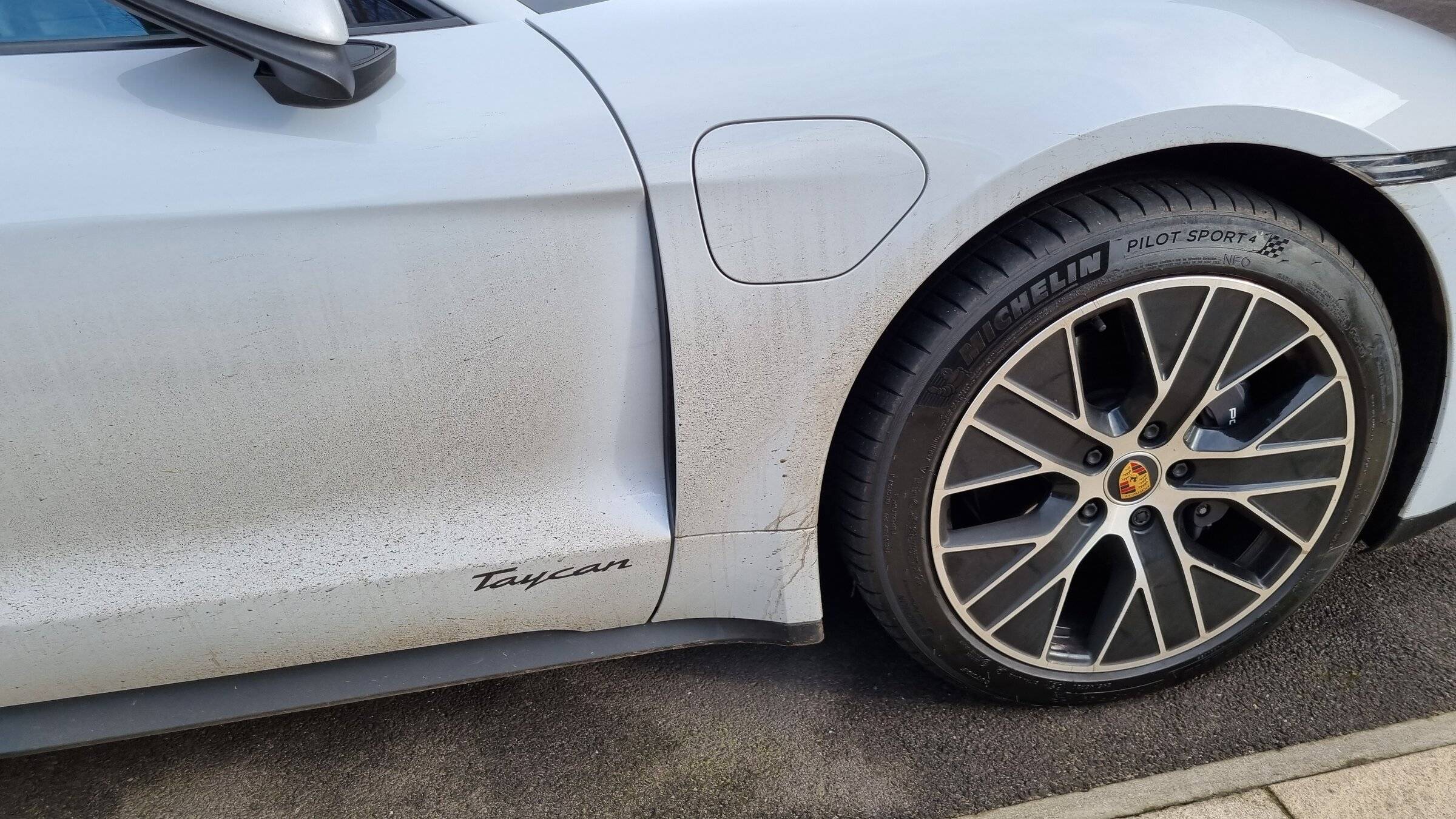

My 20" Turbo Aero wheels came with Michelin Pilot Sport 4s as standard. NFO rated.
