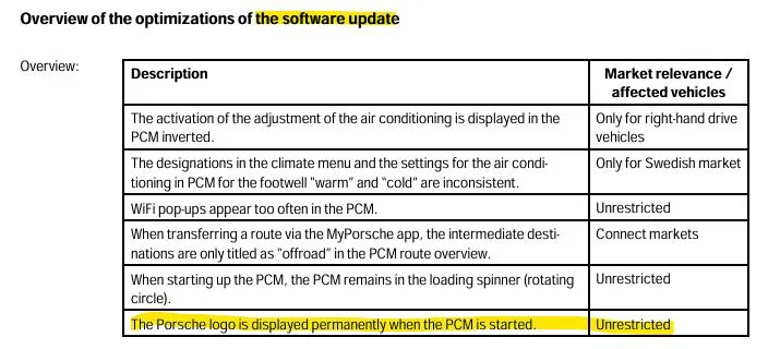

Wasn’t there a workshop on this somewhere? I am asking my dealer to look at this while my car is in this week…
