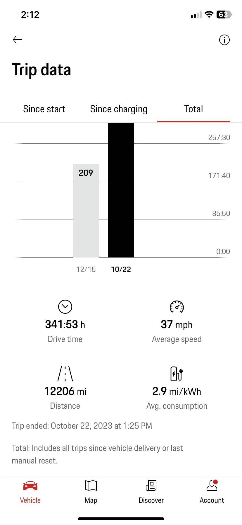

... really surprised to see a range of only 220 miles when fully charged ...
As many others have said, the guess-o-meter range will improve as you drive. The amount of improvement depends on how you drive. Here's my latest tracking chart. Enjoy your Taycan!
Porsche Taycan What Range should I expect 1698164256703
