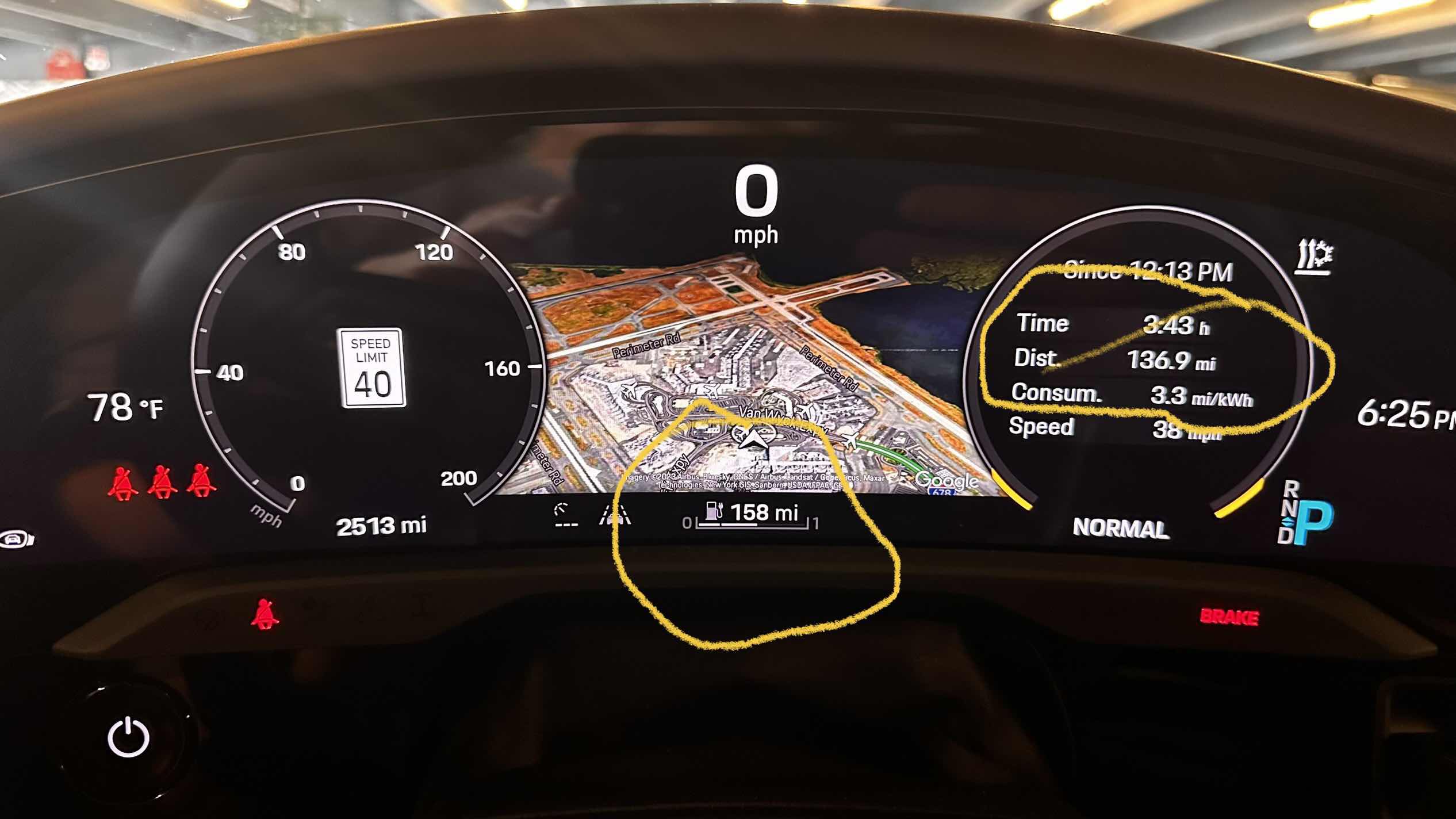

Porsche Taycan What Range should I expect IMG_7705
Taken prior to leaving JFK for the return trip. The Taycan can be driven efficiently if necessary.
I have never seen my consumption ever go above 2.7 miles/kWh... and I just have a 4S... and I have done similar miles (~2,500)
3.3 miles/kWh in a Turbo !!!

It's amazing how bad the transportation options are to/from JFK. The first 100 miles to JFK took 1:30, and the last 30 miles took 1:45. Hopefully AA continues to expand international flights from PHL, so we can be done with NYC.
It all depends on how and where you typically drive. Also, the miles/kWh function in the Taycan always overstates range.
290 miles is possible in a Taycan in perfect spec/conditions/driving style. But it’s not near typical for Taycan owners, and anyone paying attention to the many threads on this topic in here would know it. The vast majority of posters on here see less than 240 miles.
To be fair, a big part of my profession is energy management, so it might be easier for me to operate at the end of the bell curve when the mission requires it.

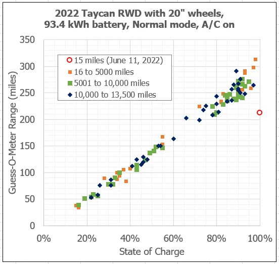

... really surprised to see a range of only 220 miles when fully charged ...
As many others have said, the guess-o-meter range will improve as you drive. The amount of improvement depends on how you drive. Here's my latest tracking chart. Enjoy your Taycan!
Porsche Taycan What Range should I expect 1698164256703
