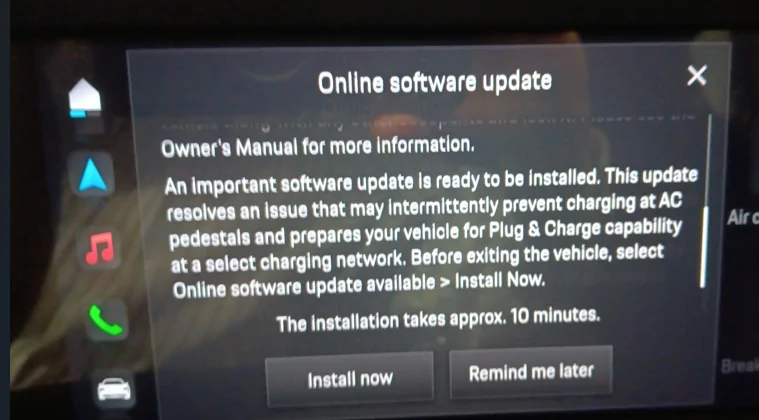

One obvious impact of not installing the update is that your car does not get the improvements described in the third image in prior post 13.
