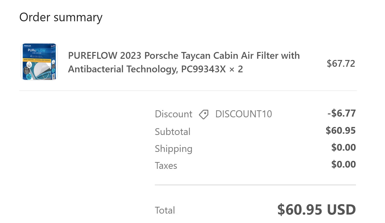

We can send you to the thread but this is the quickest. Happy to help you over the phone with the process.
Steps: 2 plastic pins hold the trim, so you need a plastic edge tool to pull on the middle to loosen them, then it is simply a snap off of the cover, note air flow of old filter!, and replace.
https://rennlist.com/forums/taycan/1259681-2020-taycan-cabin-air-filter-change.html
This is the best one that I use that just recently in stock and 10x better than OEM and I bought 2x and should have bought more as when they are out of stock it may be a long time:
https://highflow.com/products/porsc...elling_plan=6235324630&variant=44036170711254
My view, replace every 1 year or no more than 10k miles or you are breathing mold.

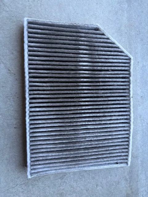

Thanks everyone! I replaced the filter on my own and if there was a "proud of myself" emoji I'd splash it across this post. Here is a pic of what I removed. I am at 40K miles. I assume it was replaced by Porsche before during regular maintenance? Still, this is a lot of yuk and glad I did it. My back is not so sure!
