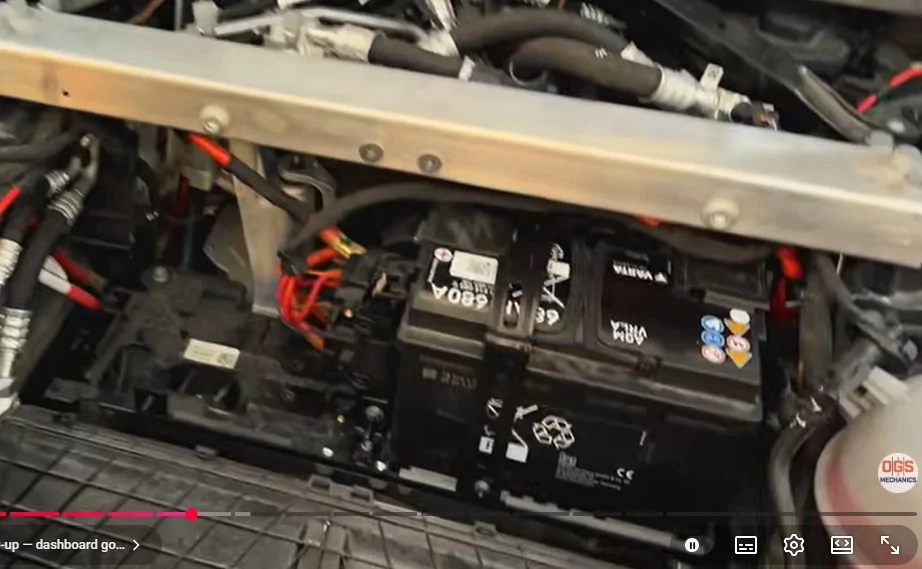

Following on from this topic I happened to watch the recent OGS YouTube video on a new Macan and it looks like it has a lead acid battery.
Porsche Taycan 12V battery died Screenshot 2026-07-27 113928
Not surprised. If you are making to a budget Lithium Phosphate batteries are massively more expensive.
