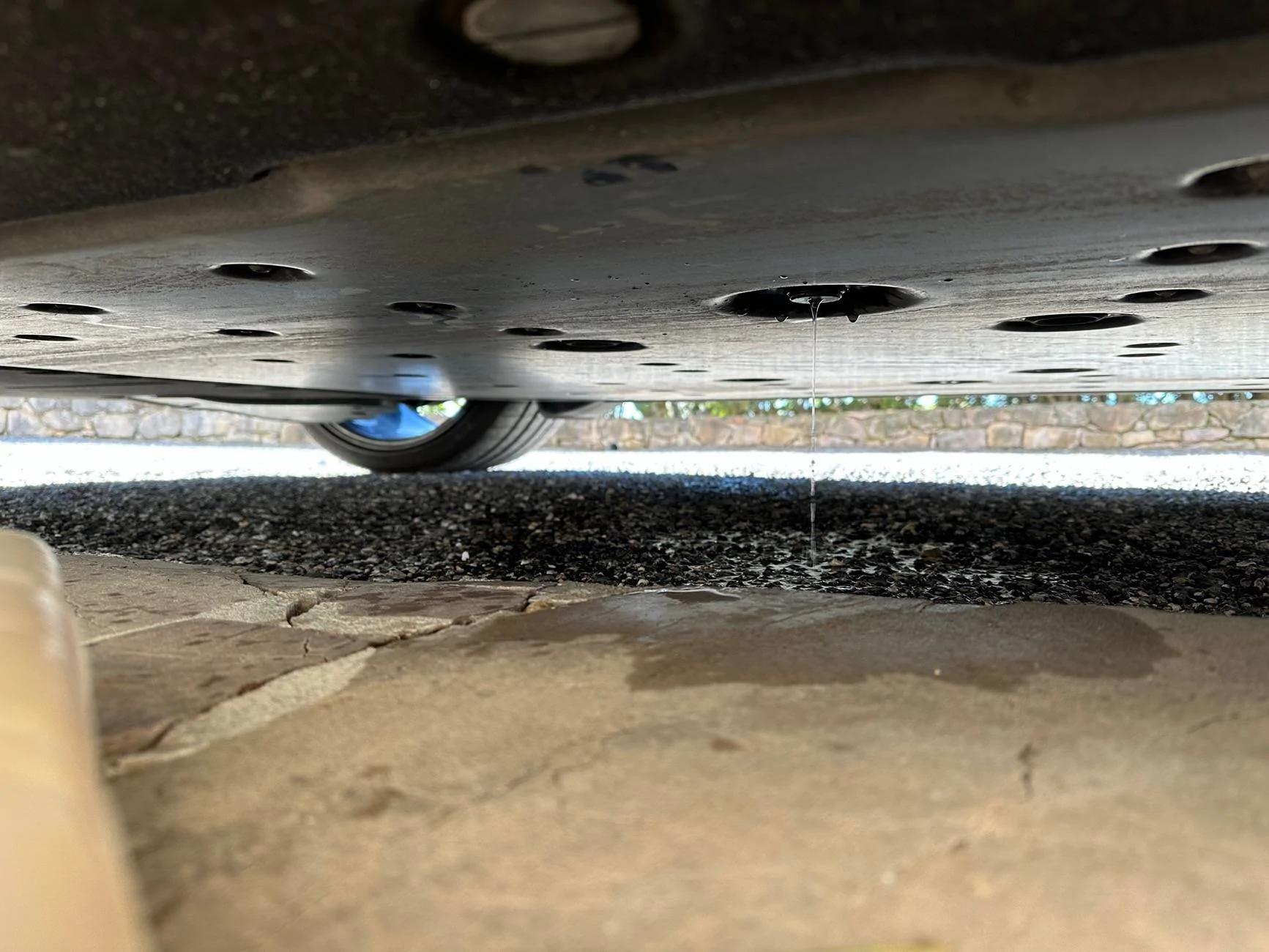

Well the service bulletin worked wonders. Below a picture of the flow of water after I managed to loosen the drain halfway. This was after about 5 minutes of flow and it kept going. That drain plug was quite full of dirt.
well worth doing , getting done, because there was quite an amount of water in there!
easy to do as well.
I would like to do this as well. How did you get the seal out? Wiggle by hand or a tool? Thanks!
I just used a flat screw driver to carefully release the holder from the car. I used a car jack to just lift the car a bit and then got easy access to see and work on it.
Then I just followed the link that was provided in an earlier post.
https://static.nhtsa.gov/odi/tsbs/2021/MC-10191715-0001.pdf
Good Luck.
[/https://static.nhtsa.gov/odi/tsbs/2021/MC-10191715-0001.pdf
see this service bulletin how to remove the drain seal. My dealer removed it when they repaired my car. For futher info see my post Water under drivers seat. Porsche already stated the drains are defective but they don’t have replacement drains developed at this time. The fix is remove the seal and use Porsche‘s new adhesive to seal battery compartment.
