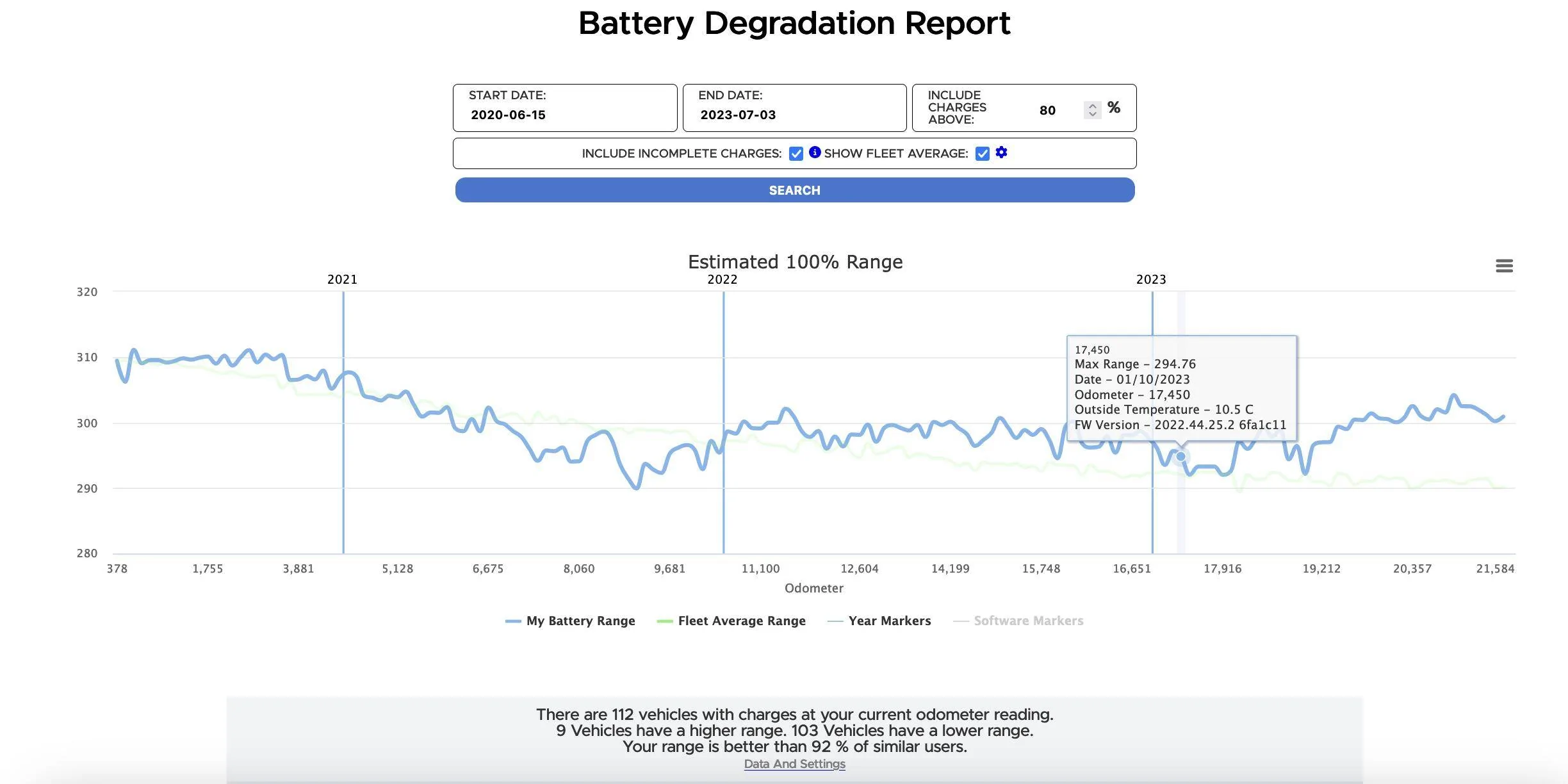

Finally below is how my Tesla performed over its near 4 year life, one of the better battery performances compared to its peer group. 70% charging was AC and 30% DC. Of the AC charging, I would estimate 20% of the time I took it to 100% overnight – and drove it the following day. My car was in the top decile of battery performance for the peer group.
Porsche Taycan Charging to 80% or 100% Screenshot 2023-10-15 at 11.56.37
I would contend that charging to 100% overnight and driving the following day does little to degrade your battery.

I’m at 36,000 miles in a smidgeon under 2 years and my usage profile has me charging to 99/100% a lot as this works best for my current needs. Occasionally due to Octopus Intelligent/cancelled work this has left the car in 100% charge state for a reasonable period of time. I’ve not got an ODB reader but I’ve noticed no appreciable loss of range in this time. My sense is that you’re right that Porsche BMS is quietly beavering away in the background looking after things, with the caveat that I’m not an engineer. Also, most of that charging has been done on Ionity fast DC.

That's good data. I would worry a bit about high power charging as you approach 100% as the voltage rises in each cell at a faster rate at higher amps in. Avoiding high individual cell voltage is therefore easier at lower power. These cells however significantly restrict the flow of power in as you get over 80% and at 99% will have throttled back a lot. On the boat, if I am charging at 100A (on a 12V system), then by the time I reach 95%, the power in drops to around 10A.
What sort of kW of power in do you see when you get into the high 90's of SoC on a DC charger? I never went that high on the Tesla on DC charging - only every got to 90% and usually was down to 50kW by then.
Good to hear your retention of range is so good.

Ha, don’t know!
I’ve noticed that the charging curve drops away dramatically towards the 100% on HPDC and had always assumed this was partially BMS protecting the system integrity and the battery. It tends to run 250kw to around 50% (often then the temperature of the battery approaches 50c and turtle mode will light on the dash), thereafter 100kw then into about 60kw at 80% to around 93-95% and then c 30kw until full
