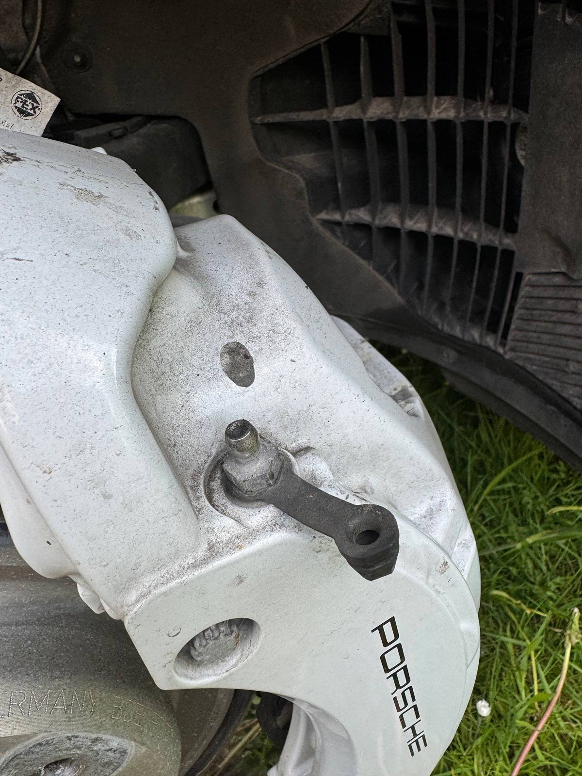

Did you have any brake “campaigns” applied recently? I had wpk0 that involves bleeding of brakes. I have just discovered they left all 4 dust caps on calipers dangling open. Probably not too serious, but what else can these “expert technicians” forget? Feel free to pm me with the name of your dealer to see if these could be the same…

OK - so following pressure to the dealer from Porsche GB to determine cause quickly its been diagnosed as a split brake hose (nr side)
no evidence of impact or damage, just component failure
I think they need to start checking other cars ASAP ? this could be a killer

Opc casually suggest ordering and fitting a new pipe ………. no regard for the other 3 same age / same quality pipes on the car or the thousands of other Taycans that could have a similar failure
they honestly expect me put my wife and children in this car again without as much charging all the flexi pipes
i reckon there should be an immediate recall on all cars with this component, it should not fail at this age

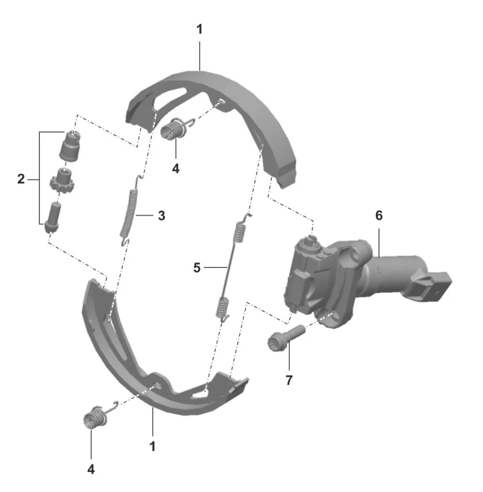

So I tried holding down the (P) button today at 30mph (no other cars). It works well. It stops the car vigorously and promptly, but also smoothly. It is a stand-alone, separate system. It does not also trigger regen, which is expected because this is a backup system and should remain simple. What it does do is apply electric servos to rear drum brakes, as with many other EV and ICE cars.
From that French site here, I got the parts diagram:
Porsche Taycan Complete brake failure !! diagram
And the parts list description for 6 (servomotor):
Porsche Taycan Complete brake failure !! partslist
I'm not going to play around too much, but it is probably a good idea to try this once or twice in a parking lot to get the feel for it and code your brain that this is an option.
