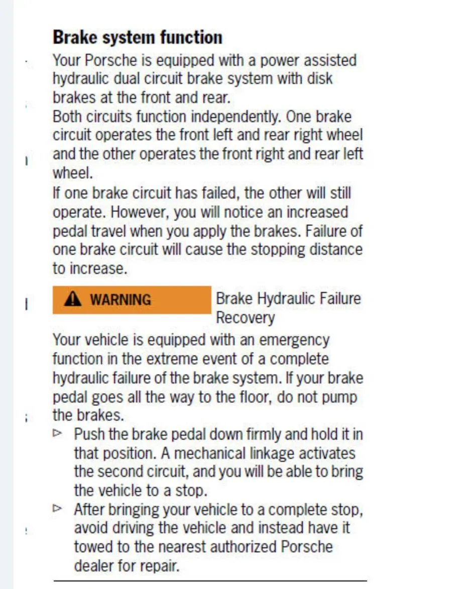

It is possible to drain the brake fluid by pumping the brake pedal several times. In old Porsche documentation (Macan ) it states that the pedal will go down very far but then mechanically engage the second circuit. However they warn that if you pump the brake pedal you might loose ll fluid?
And I guess pumping the brake pedal a few times would be a natural reaction. Question is how many times you can do it without loosing all?
Here is some text from Macan manual.
Porsche Taycan Complete brake failure !! IMG_2080
Since the Taycan has brake by wire, the strong recuperation by the motors should still work, but not a low speed of course.
