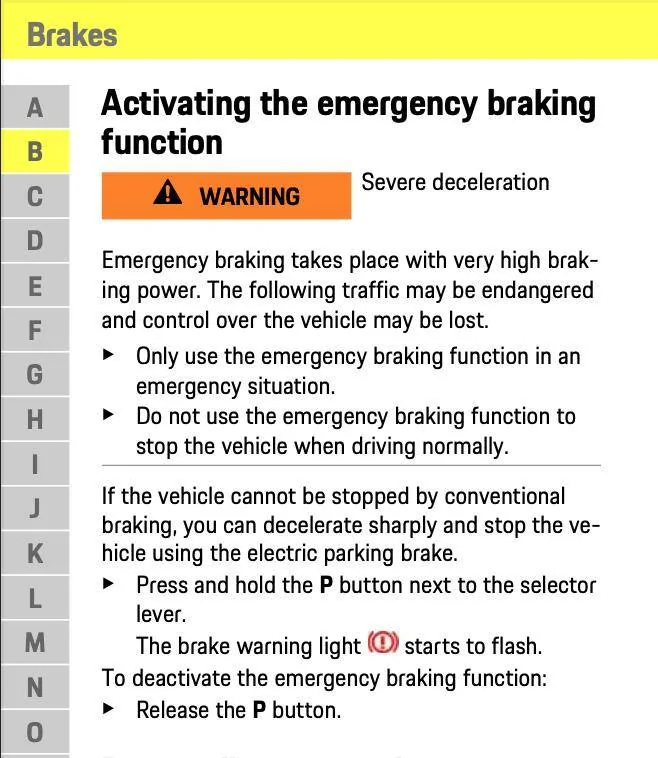

The practical takeaway as posted upthread is to know that the park button will initiate an emergency stop if you press and hold it.
