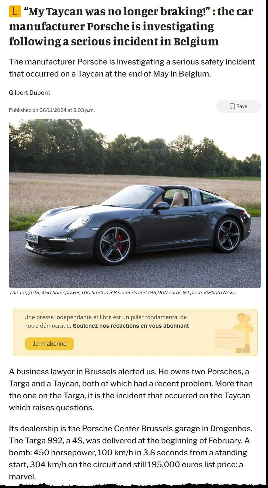

very similar incident happened recently in Belgium, now in the news
(article in french ?)
88
8,372
7,382
link
Title about the Taycan, article starts off about a 922, or is this just an news AI hallucination? Or has Google Translate decided 922 Targa is a Taycan?

he had 2 problems. one (noise) with the Targa, not solved, and then the brakes with the Taycan
The headline talks about the Taycan, no mention of 922. The article starts off with multiple paragraphs about 922. I lost interest after that, just assumed it's just an AI generated hit piece, filled with unrelated (to the headline) story about unrelated Porsche issues, designef so they can display more adds for the reader to scroll through before getting to information relevant to the headline. Or maybe it's just a style of the news outlet - ramble on about tangentially related stuff before getting to the point of the headline.

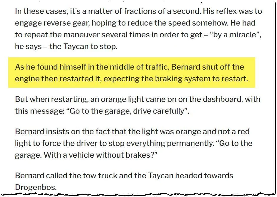

Ok so I went back out of curiosity to see how far down is the headline information buried in the article. Than I came across this:
Porsche Taycan Complete brake failure !! 1718181138016-rd
I do not speak French; is this a translation issue, or do French Taycans have engines they can shut off and restart? How do you start the engine on a French Taycan?
Good catch!
I am not sure I have an engine in my Taycan, but will go down and have a look for it!

owner was told the problem comes from the braking circuit and the flexible pipe that could leak. very similar to what happened to the OP.
He was pissed they do recall for other minor things, and nothing for that very serious issue.
