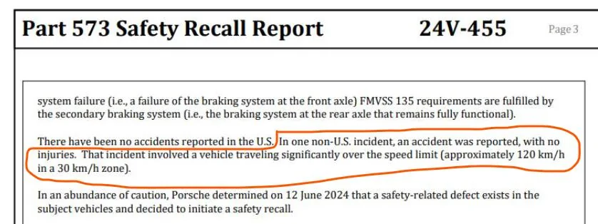

This looks like exactly your problem. The front brake hoses split when “driver sets them at the wrong time at the wrong angle”
wow ! so it’s triggered recall !
not sure what the mean by “driver setting” though, my car was only ever worked on by OPC technicians

Sorry I tried to be sarcastic. They apparently say that hoses “only” split under certain driving/suspension conditions.

is it a global recall or just USA ?

I have been informed by Porsche Reading that “only 365 cars” in the UK are affected… It doesn’t sem right as worldwide, it seems Porsche is likely going to look at all cars manufactured prior to May 2024.

So seven cases in the USA. Seems Porsche is being very proactive.
Porsche first received reports of the front brake leakage issue in June 2023, per the NHTSA report. The automaker has seen seven cases of such leakages in the U.S., though none have resulted in accidents. One report outside the U.S. did include an accident, though there were no injuries, and featured a vehicle traveling significantly over the speed limit at approximately 120 km/hour.
https://www.fastcompany.com/91146891/porsches-ev-ambitions-threatened-by-taycan-recall
i’m not impressed with Porsche GB who categorically told me they had no other similar incidents whatsoever and basically tried to fob me off as a one off freak case
despite the tech saying in the initial inspection video it was clearly i damaged 24hrs later i was being told by porsche its was probably damage and not a component failure …….. 24hrs later i was being told it wasn’t damaged by porsche and would be replaced as a good will gesture (note NOT warranty)
i suspect my report to the DVSA woke them up on this
