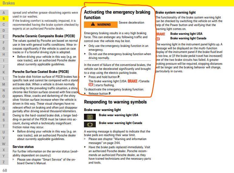

That must have been very frightening and glad everyone was safe.
The thing all Taycan drivers should try to remember in case of a failure emergency is that the emergency brake (regen only, does not use conventional brakes, is intended for conventional brake failure) is:
hold the P button to brake, release to stop regen braking.
The owner’s manual warns that this will be “severe braking”, presumably the max the system is capable of.

I'm curious what the system logic is behind this. I'd assume the car would go to max regenerative braking down to the point where deceleration would taper off to the point where the mechanical parking brake system be more effective by locking the rear wheels up to complete the stop.
Next, I wonder what the process is for moving the car from that point? Would selecting "D" allow the car to be driven? There must be some process to allow this, but I can see the corporate liability-focused attorneys arguing the car should remain disabled wherever it stops once an emergency brake application is performed. That could be far from ideal, depending on where the emergency stop was completed.
I guess there's one way to find out...but I'm not willing to do it. ?
It is likely not regen at all. It is likely similar to ICE cars that have an an electric parking brake (EPB). The button activates an electric actuator that applies the mechanical brake pads to the rear wheels. Have you activated the HOLD mode and felt the thunk when it releases? The manual says with the car moving, you can hold down the P button and this will trigger the electric actuators. When you release the P button, they will retract. I think you could try it at low speed in a parking lot to feel the effect, like you might with an ICE cable parking brake.
I think this is about the only useful post in this thread.
I can't imagine the car would only apply the parking brake at 80 m.p.h., when regenerative braking is available, and probably more effective at that speed.
