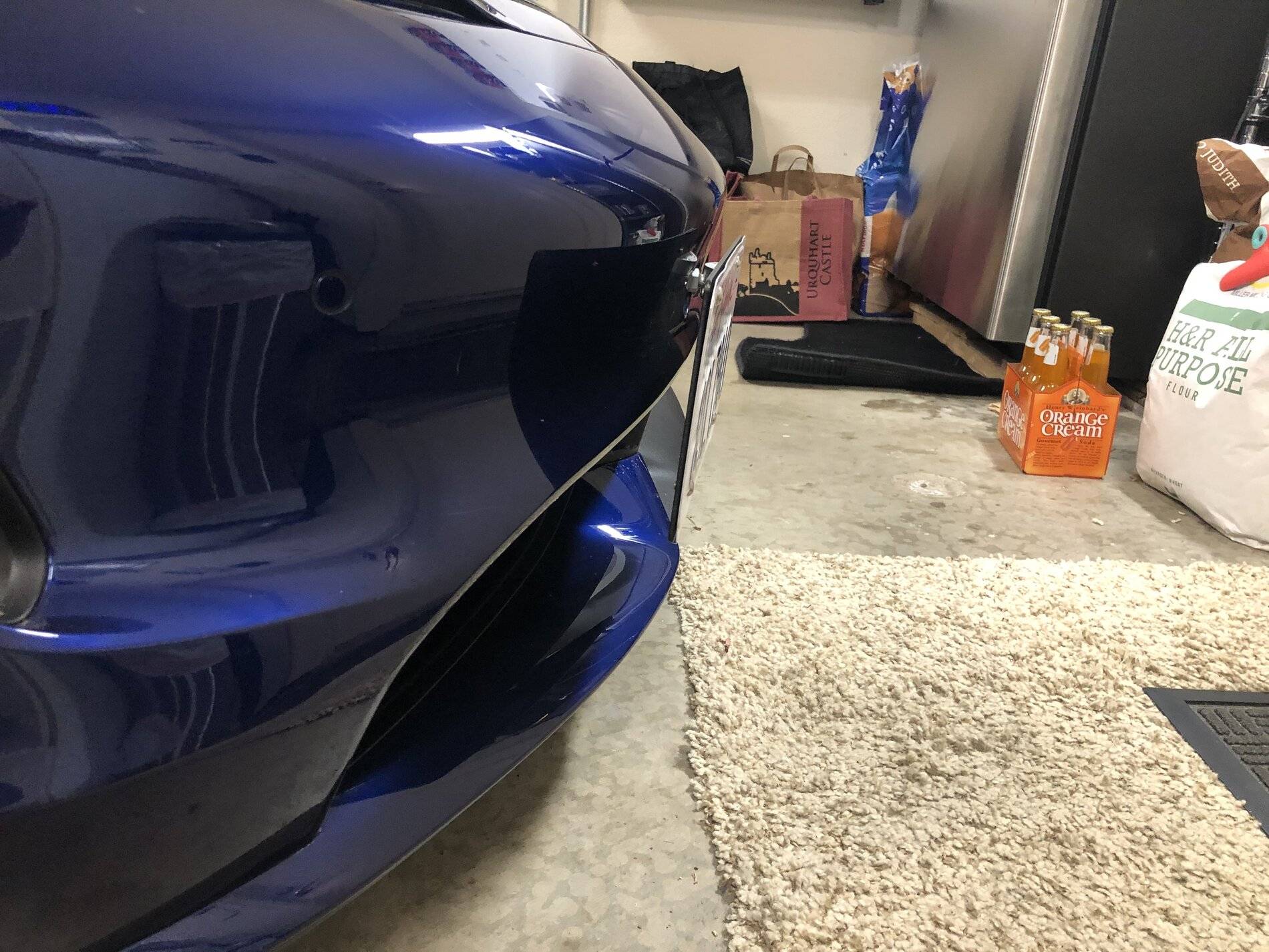

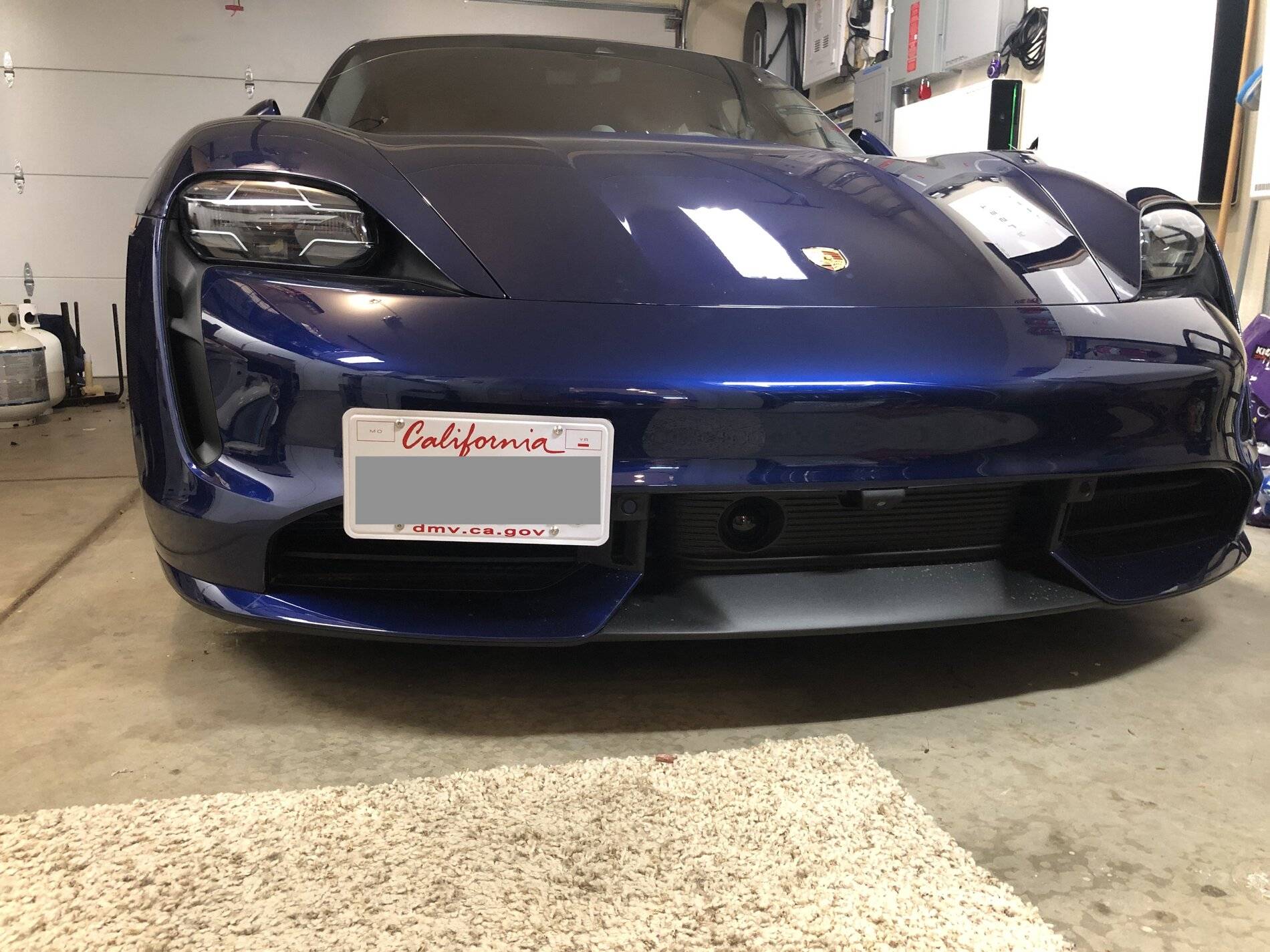

front plate from RennLine works well - solid - adjustable - and easy to install - so far in 10 minutes of testing no interference with the parking distance sensors - but I haven't yet had extensive time to test - I'll update after a few days, but so far so good!!
see pic's

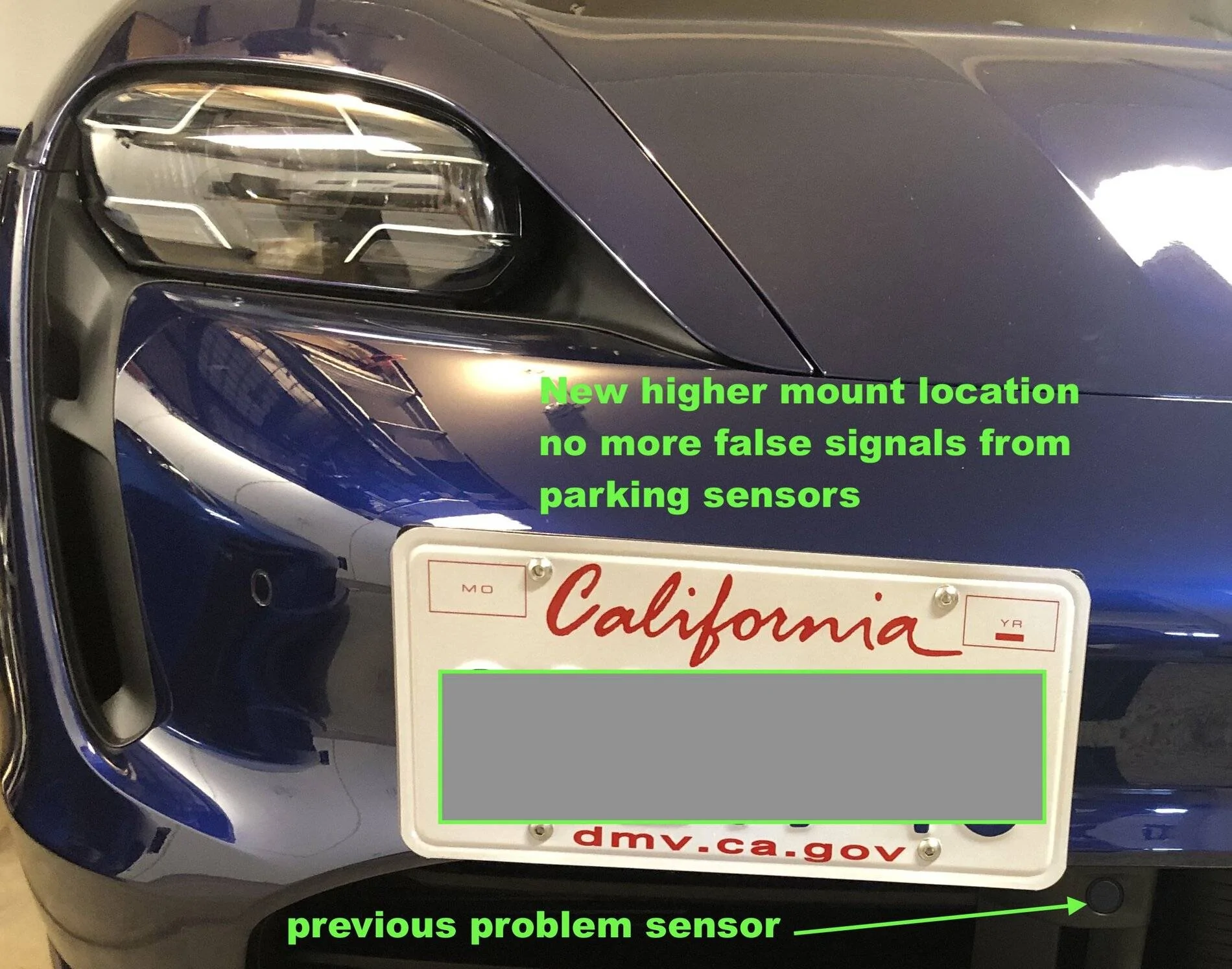

Update…
I have confirmed the front plate mount I purchased can work for the Taycan - but you have to mount the plate higher visually that I would like to avoid false positives from the ultrasonic sensor visible in the right of my pictures.
I was able to rotate the backing plate and mount the plate higher on the car and the bottom of the plate now clear the sight-line of the ultra-sonic sensor - a 30 min low speed parking lot test confirmed no more false positives with the plate mounted in it's slightly higher position.
prior to raising the height of the plate I was getting false positives from the one sensor that would be nearest the plate - these were annoying but manageable - I believe the plate could be mounted one notch "lower" and still avoid the sensor, but I ran out of time today to play with it - if I get motivated I might take it all apart again and try the one notch lower and see if I can get away with it.
however there are at least two mount heights that clearly mount the plate high enough on the bumper to avoid interference with the parking sensors.
YMMV - but so far this is working for me.

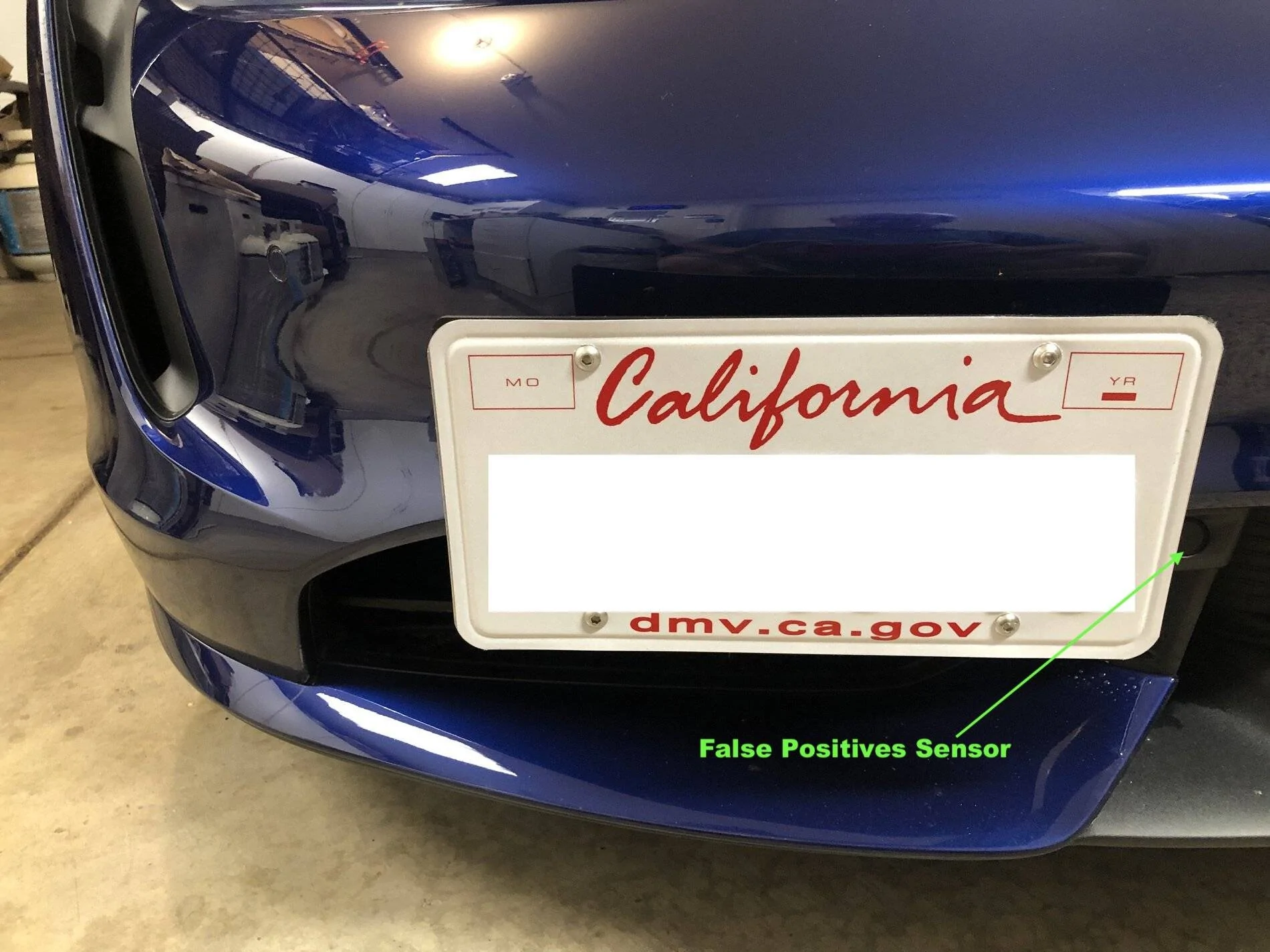

this is a picture of the previous plate mounting location - too low - and the sensor with the green arrow was providing false positives at low speeds - annoying -but not devastating - I've moved the plate to a higher mounting location - see next post.

higher mounting location - no more false positives from that one sensor - still looks ok - but I preferred the lower mounting position - but I prefer the lack of false positives from the sensor so we'll go with the higher mount position.

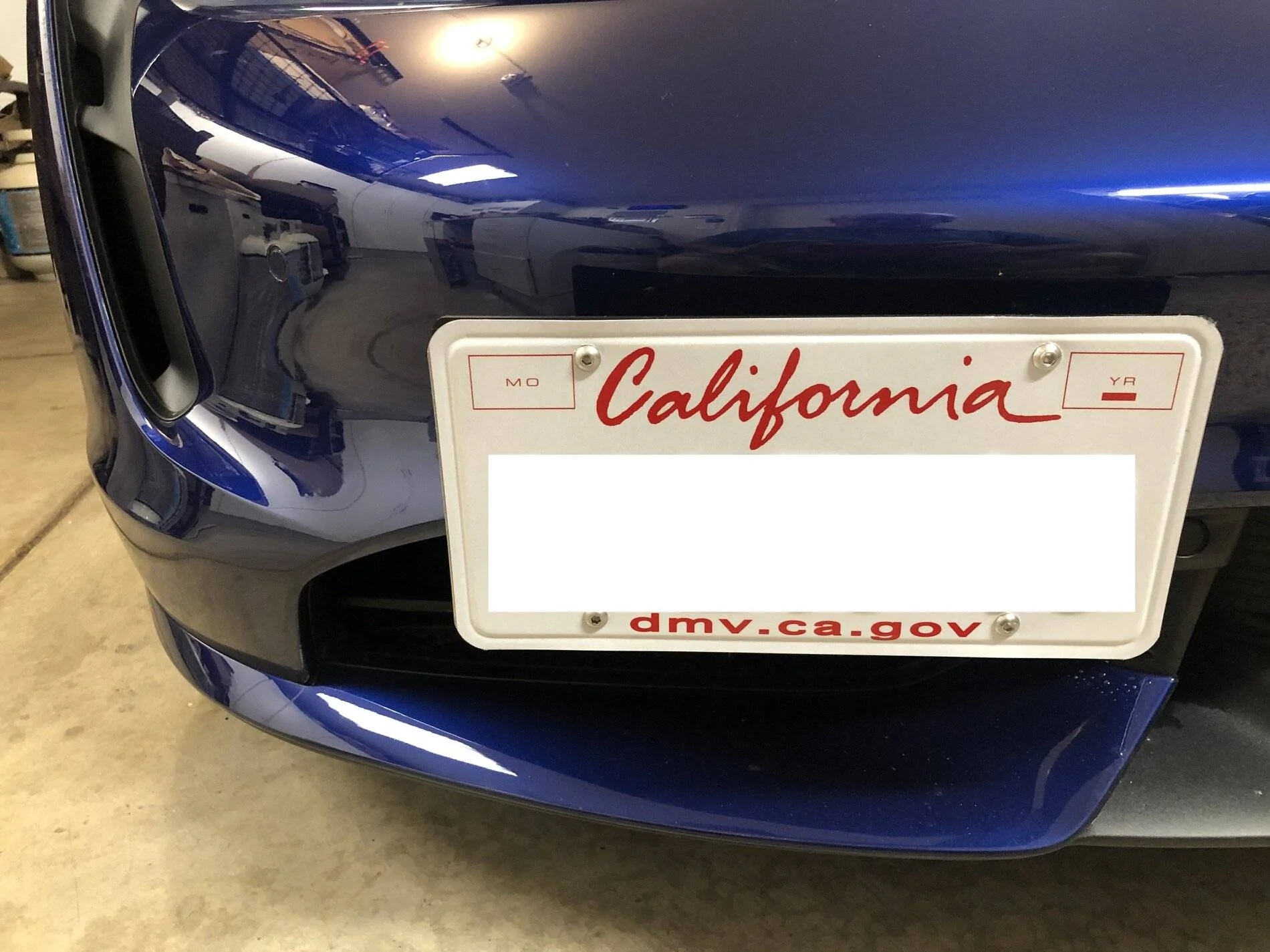

counting from the bottom:
row #1: not tested, but higher mount position than row #2 - so this would definitely not interfere with parking distance sensor
row #2: my current mounting row - 30 minutes of low speed parking lot testing - no false positive signals from the one sensor - Lower plate position visually which I prefer - so we're going with this mount location for now
row #3 - looks like it may also clear the sensor - untested at this time - but would be a lower plate mount position and therefore in my mind visually more appealing - I have not tested this mount location as of this posting
row #4 - definately too low and will interfere with the parking sensor.

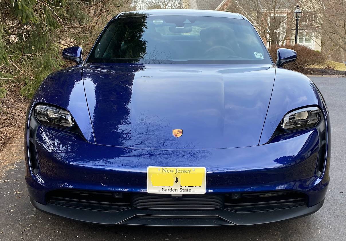

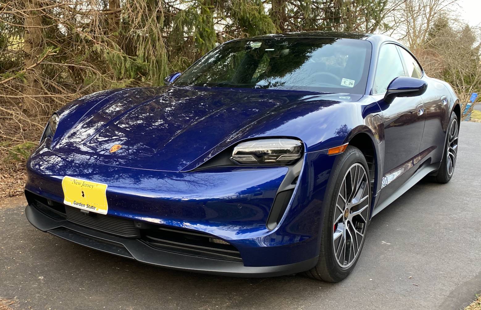

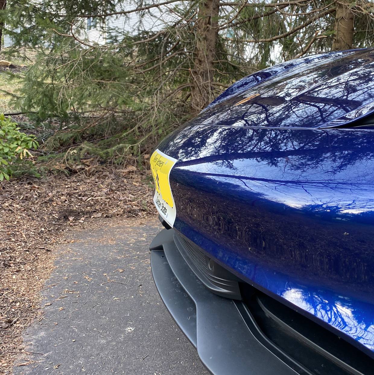

I purchased an adhesive replica from customlicenseplates.us that looks identical to the original plate but was just a sticker. I think it looks great and from the front it's almost impossible to see that it is actually just a sticker.

while it looks good it is illegal in NJ and some sharp eyed cop could give you a ticket
