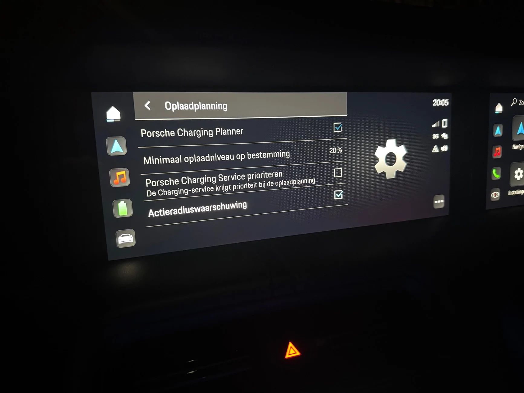

I noticed that Porsche Charging Service has been turned off. (Perhaps it’s unclear, but the first three options in the photo are grayed out, and you can’t change the settings. It will indicate that the feature is not available at the moment.) I reenabled it and drove for 10 minutes, but the issue returned.
The strange thing is that I no longer have LTE, but I have 3G. Apple Music works fine, so it seems like I’m getting enough bandwidth. Has anyone experienced the same issue after the latest “fix”?

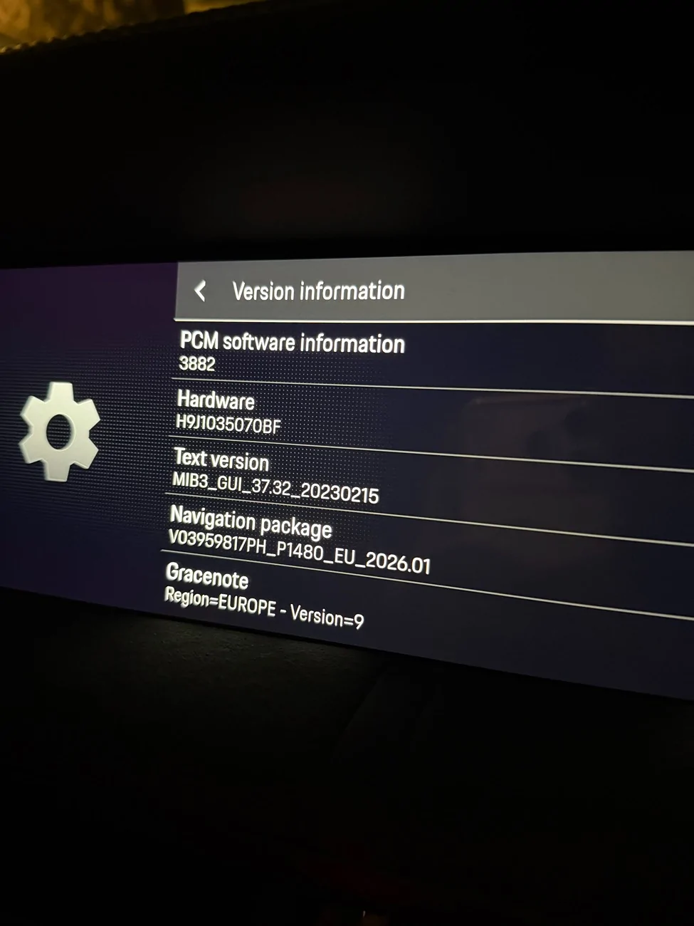

@Matt-Taycan To recap, your Taycan is a J1.1 and Porsche (which service center?) installed a new PCM on warranty in response to your complaints about the nav? Can you tell us what software version that new PCM is on?
Correct. J1.1 GTS
Porsche Sheffield.
Software Pic attached:
Porsche Taycan EU/UK: Ongoing navigation issues [Solved with PCM v3892] IMG_6921
ovonrein
May 7, 2025
280
86
Porsche Taycan S4 Cross Turismo
@Matt-Taycan That is the same s/w version I have. Need to verify my h/w. (Unsure, though, whether that h/w id is a revision number or the unique serial number of our units.)
