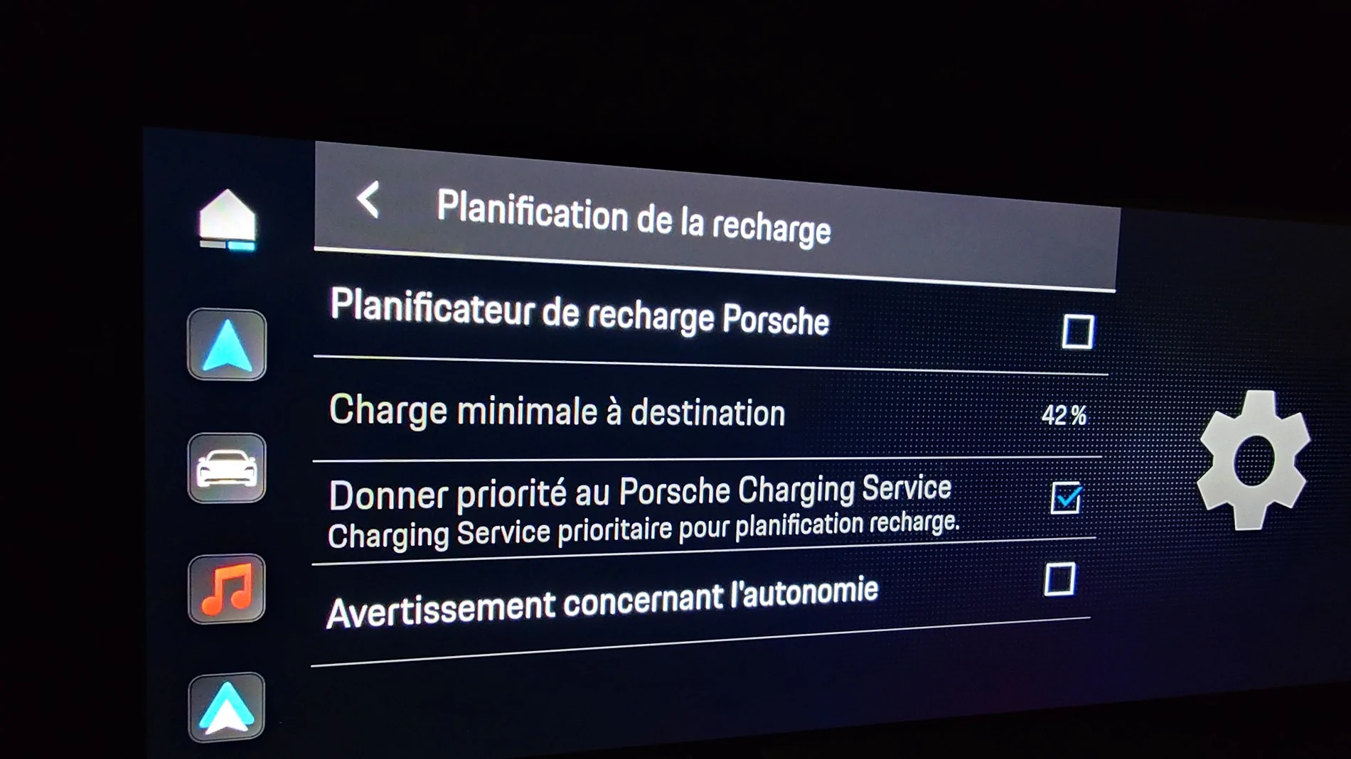

I have a trip planned in 2 weeks with 3 stops and do like you said. But you don't need the charge planner at all it seems, at least if you plan to stop once. I just tested it now.
1/ charge planner is off and will stay off for the whole procedure

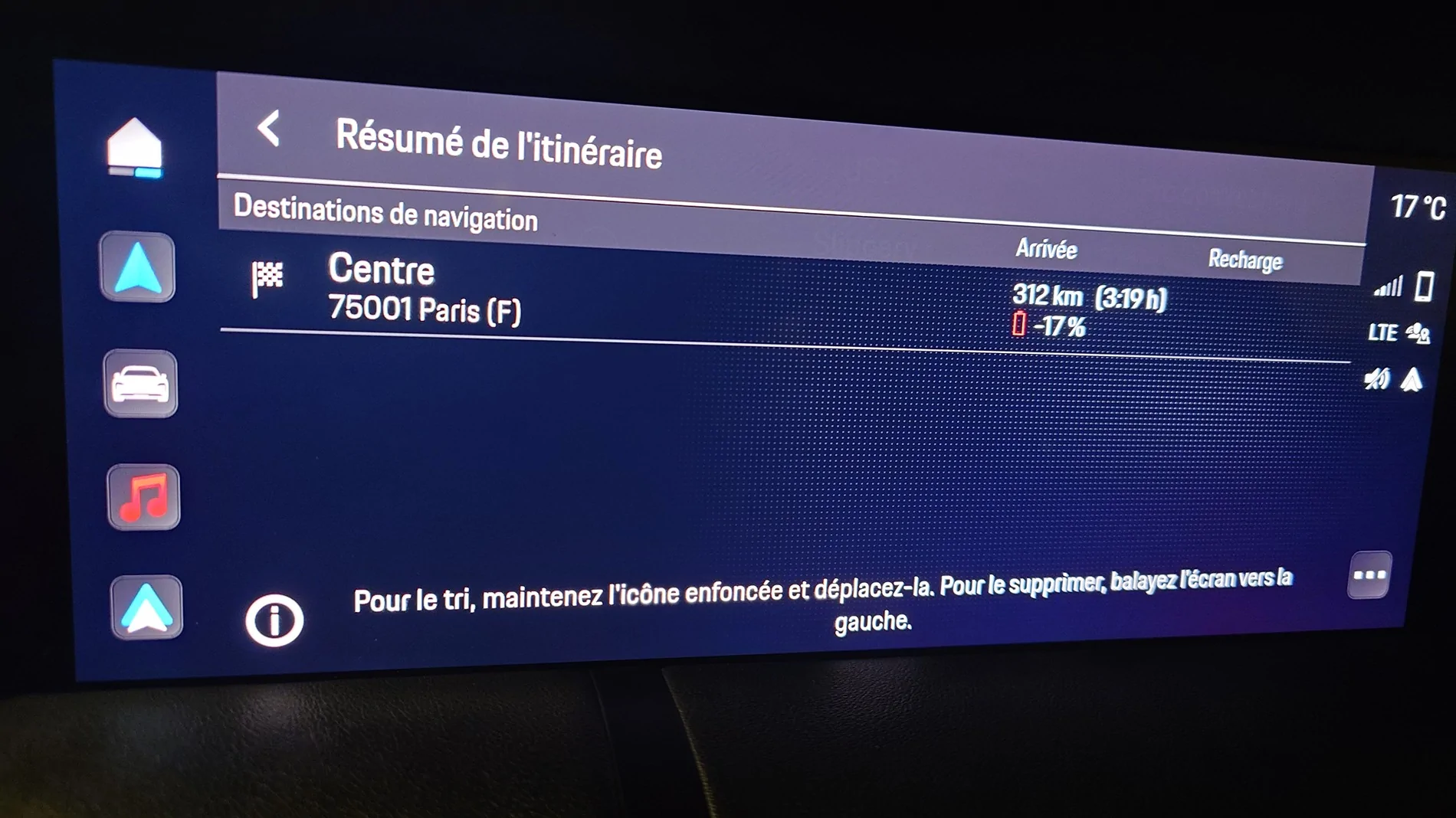

2/ I set a destination. NAV tells me I will reach it with -17% left. That's normal since the charge planner is off.

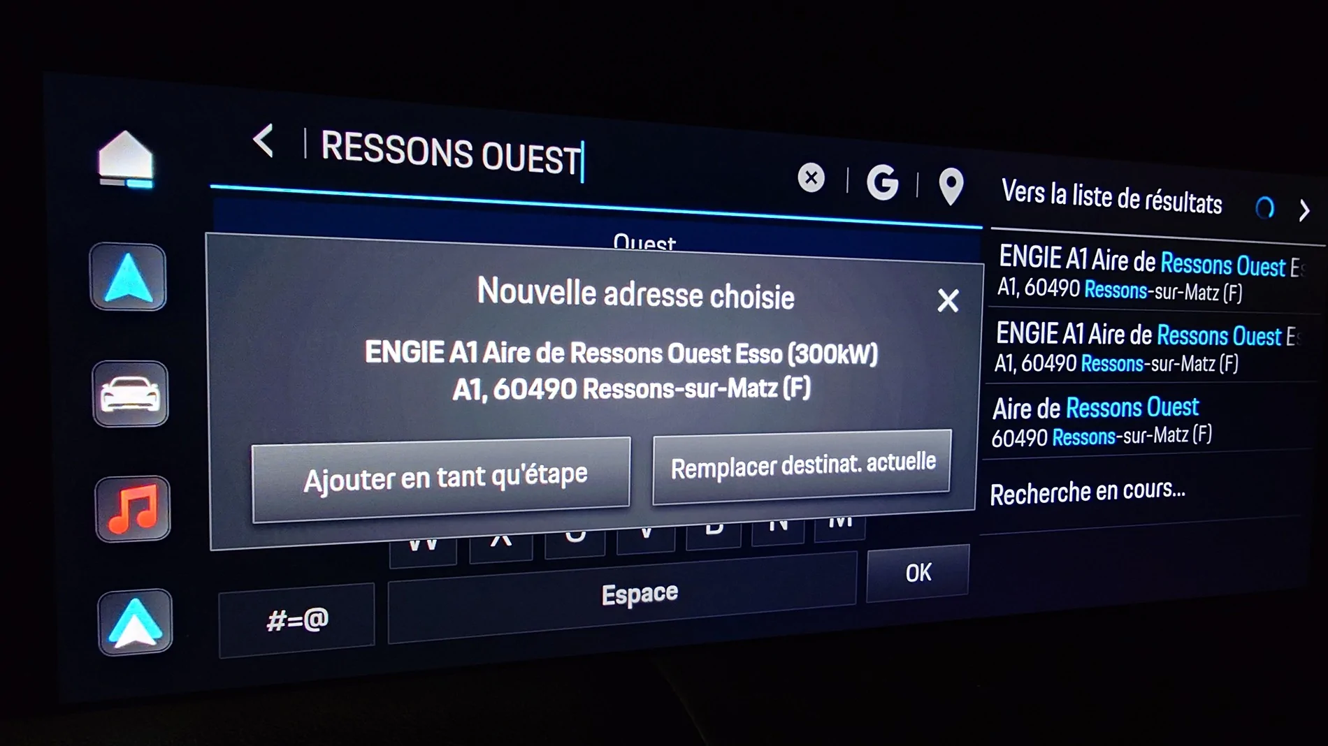

3/ I look for a rest area where (I know) there is a charger. NAV gives me the possibility to chose the 300kW charger, that I introduce as a stop. I do not have the possibility to set it as a charging stop since charge planner is off

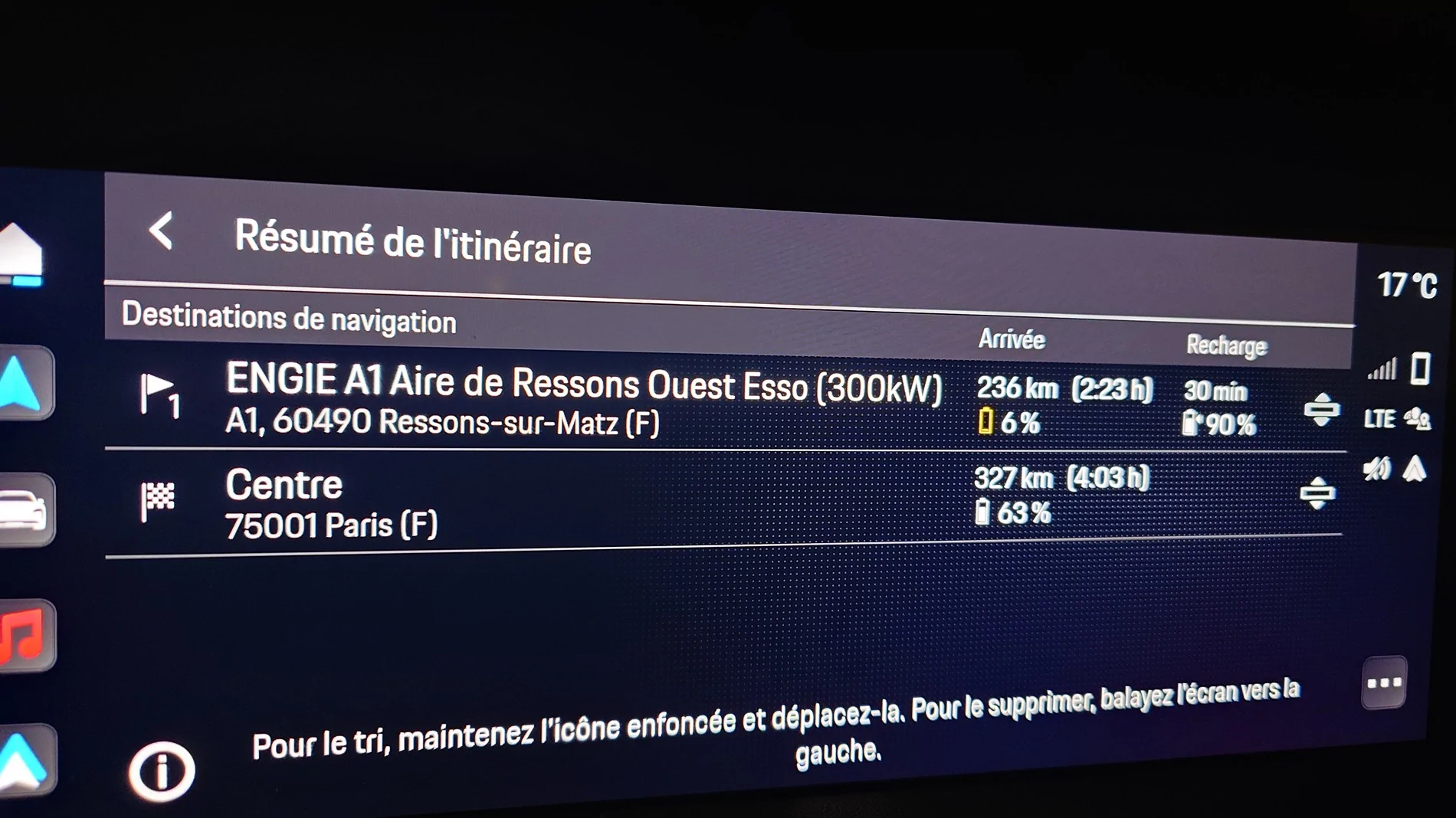

4/ NAV recognizes it, and will suggest to charge the battery to 90% (why 90% ? no clue ....) and will as well precondition the battery as I noticed yesterday.
Porsche Taycan EU/UK: Ongoing navigation issues [Solved with PCM v3892] 20260226_141035201
all this with the charge planner still off.
