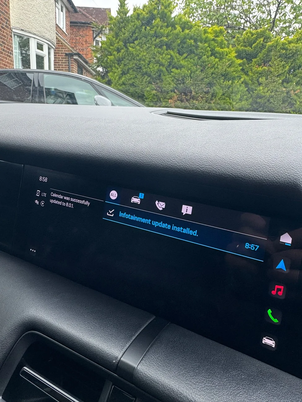

Leccy61
Nov 18, 2024
334
250
Taycan Cross Turismo, 986 Boxster S, VW ID.3 Pro S
Great result @Rollep reminded to me to report that a 2 finger salute encouraged update of calendar app to version 8.0.1, the weather app is also at this version. Looks like the error I saw after WTG1 was the legal notice app, that’s still at 7.1.16, but OTA seems to be working ok.
