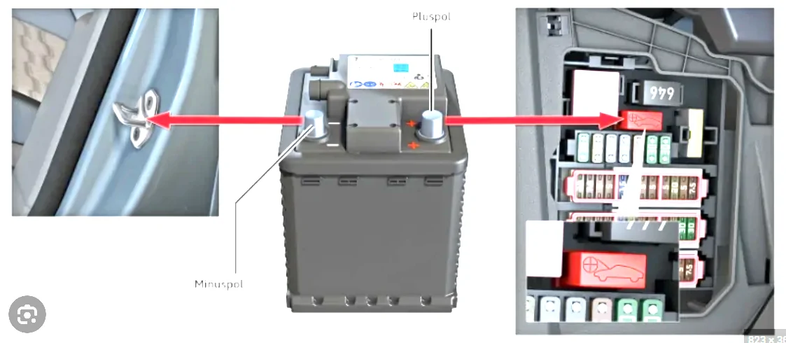

In addition to this issue, i was awoken at 5am today by my car alarm going off, followed immediately after by a phone call from Vodaphone, informing me that my 12v battery was dead. Long story short... Porsche assist came out within the hour to jump the electronics back into life so that the frunk could be opened to access the 12v and jump that. The car then proceeded to behave in perculiar ways, turning itself off when ordinarly it wouldn't, locked itself with the key inside (had to get my spare key and manually unlock it

Thanks :) All the instructions I have seen start with "open frunk" (and there is an elaborate procedure for that). The quoted premise is different, hence my curiosity.

How did they do that?
There's a port in the drivers side fuse panel (panel pops off next to your accelerator pedal) Its a small Red connector with a picture of the car/frunk on it. Connected to that and neutral to the bodywork. Key was then enabled and allowed the frunk to be popped
Found an image online. Pretty much sums it up
Porsche Taycan EU/UK: Ongoing navigation issues Frunk Jump Connection
