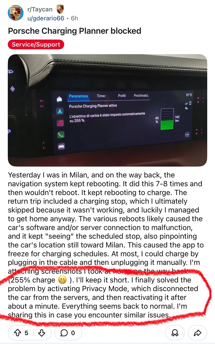

If that’s the case (and we’ve had a few of us speculate it’s a memory issue), then I sincerely hope there is some form of compensation for the 9-12 months of useless software which is well below that expected of a premium brand.

I reckon it’s to do with the huge number of charging points available and (as I think Jasper mused) a poor software implementation which tries to display too many of them at once, constantly updates irrelevant charging point usage and probably has a very poor route recalculation algorithm.
It would be interesting to see where the most affected rays and are located and also see when and where different people were affected

My car was returned from service yesterday...they updated the PCM as over Christmas I was getting the rebooting more and more to the point where over the last couple of trips it was unusable.
I asked if it could be updated to J1.2 s/w...no response and it hasn't been.
I now have
  • UI = release-37.17-2147-SNAPSHOT-17.09.2024-15:50:44 (so am assuming no updates for 15mths)
  • s/w vers = MPR3_ER_POG46_K3885
  • PCM vers = 3885
  • Hardware = H9J1035070AG
  • Text vers = MIB3_GUI_37.32_20230215
  • Nav package = V03959808RM_P1320_EU_2024.06 (so am assuming no updates for 18mths)
  • Gracenote = Region=EUROPE-Version=8 (for completeness - music searching :))
Will see how it goes.

There are newer UI releases. I have newer.
There are newer navigation packages. I have from December 2025.
And there are also newer Text vers.
So make of that what you will. They likely only did the 25min TSB for updating from PCM 3882 to 3885, and nothing else.
In switzerland porsche mobility / support stopped recommended 3885 update for this issue, and now instead only say: it is a known issue and engineers are at work. My dealer said they have cars weekly coming for this issue, and since there is no official TSB from porsche, they cannot tell owners to not come and wait.

Interesting, when I went through the nav software version with the guy from Porsche smart mobility (following his instructions over the phone), my version ended EU_2025.12 - so I guess more up to date than yours and that was before any attempt to address the issues in my car.
seems strange that yours should go in for an update - with nav related issues, and come out with an older (UK based) version than a non-updated version....

@chun Is your Taycan still ok, no nav problems since ecu update?
No, post a bumper replacement which involved re calibration of sensors and cameras, the issue has returned - around 3-4 weeks ago. Could be just a coincidence, could be related.
Dealer doesn't know. In the absence of any TSB, he proposed rolling back updates, and re applying them. Doesn't inspire confidence, more of a shot in the dark.
My friend that got the same fix 2+ weeks before me still has his maps working.
