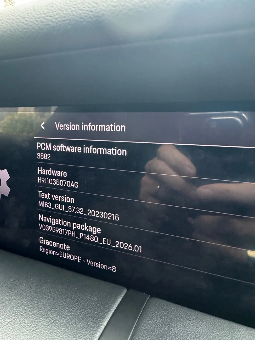

I note that a previous poster on this thread received an update via their OPC, and now has nav pack 2026.1 ......Mine is 2025.12 ... not sure if that means 2026.1 has a fix?...
but most people seem to find the update becomes useless after a few days/weeks .. I guess I will go through the motions (in both senses) without any expectations - and report here afterwards...

You have the December map overlay, and I have the January one. It’s just map data, not an update to a navigation app. There’s nothing to worry about.
Thanks for the clarification J - good to understand what that pack number means thanks...
I'm not worried at all .. it's not so important for me, personally - I hardly use nav or planner - charge at home and mostly just pootle around ... last long trip was around a year ago. Cheers

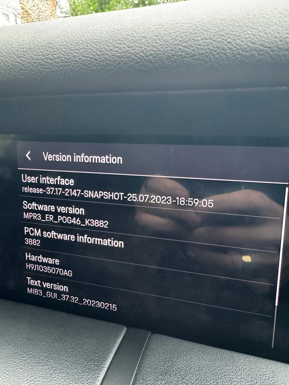

@Matt-Taycan says his is now working fine, but his car has no meaningful different versioning with mine which has not been in for this issue and is crashing at will. The big difference is he believes his had a new PCM, if that’s the solution great, but surely it would be different hardware (e.g. with more RAM).
Iā€˜ve pushed back on smartmobility asking them to confirm that the TI for a software update with bug fixes/stabilisation they say mine should be booked in for really is the solution, pointing out that for others it doesn’t seem to have been. Interesting to see what they say.
Great stuff - very interested in their reply!

When the Porsche Centre contacts me I'll ask about the solution...like what the software update consists of, is it a first step before hardware. Car was in for 4 year service 6 weeks ago, seems the PAG TI isn't a proactive thing.
"I appreciate the concerns you have and whilst I cannot guarantee a permanent solution, this is the information provided by the necessary team in Porsche AG. I have reached out to the Service Manager at your preferred Porsche Centre and asked him to contact you to arrange an appointment. At the same time, I have provided him with the instructions from Porsche AG."
EDIT: Good reminder that Porsche is not set up for the new world. Flagged issue using the app, picked up by a smartmobility agent who gets instructed by PAG, they come back via email a day later, they pass it on to a booking agent for the group my centre is part of, they know how to make bookings but vague on what it's about, repeat it all to them, car eventually booked in. At least they told me an outstanding 12v battery recall will be done at same time.
In the new world this could have been an app service chat, issue resolved remotely or booked for service visit at my home or in a service centre.
I guess that's reasonable since the advice/instruction comes form the source - thing is - if you refuse to take it in - I guess you have no come-back for continuing issues... so its a Catch-22 - hope it works out for you (and us) - cheers
