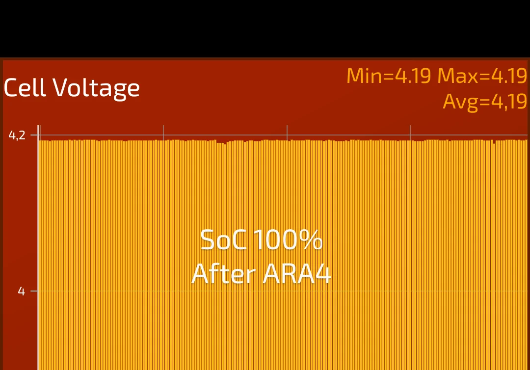

Sure, we're all speculating here but normally, if a battery has been under a certain amount of load in a certain timeframe, the difference in voltage is a good indication of health, that's just common knowledge.
You can monitor that yourself.
Within a tolerance there's no need to mark a module as "defective", that may be around ±0,005V (5mV), which is ridiculously steady imho.
Porsche Taycan J1.1 Taycan High Voltage Battery Reliability Survey Screenshot_20250704-162559~2
Forgot to add that some modules are (possibly) shorted out by water ingress due to leaking seals.
