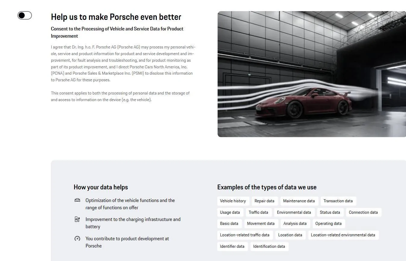

I don't know about PCM, but
From MyPorsche website page https://privacy.porsche.com/us/en_US/consent
I also have that disabled as well, as soon as I purchased my car. Not sure if that means our cars are not counted as part of the recall since they are using ML on vehicles in the field.
The key question is: What vehicles are considered "in the field", all Taycans or only the ones that are still opted-in to collect data?
