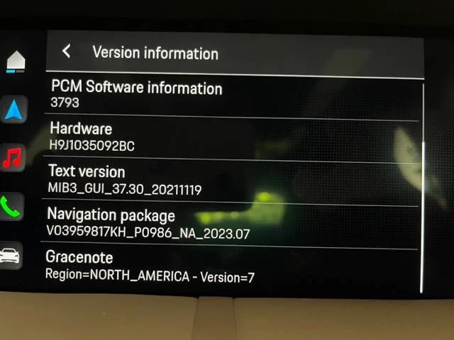

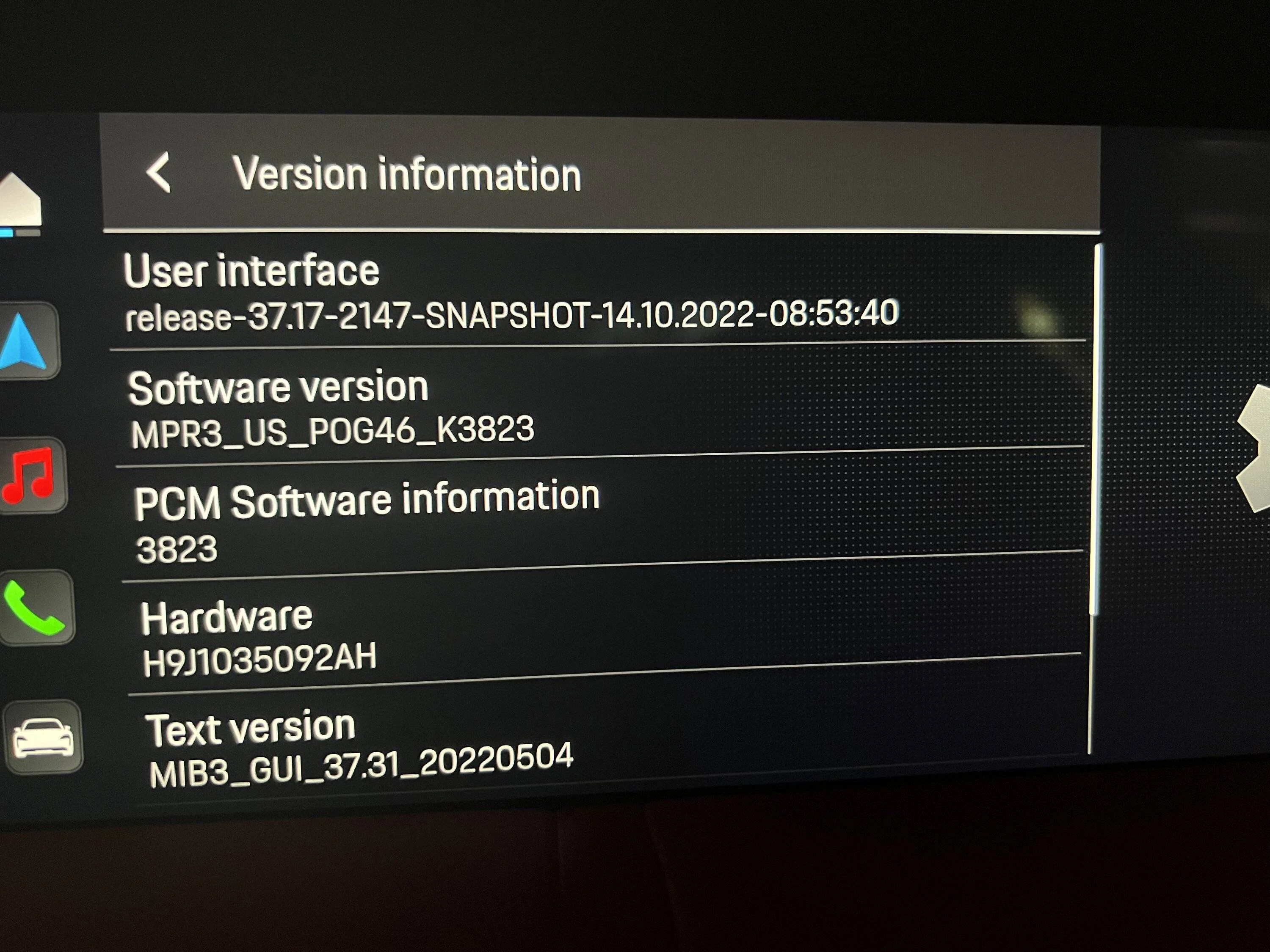

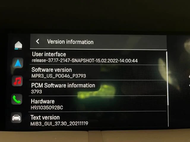

My current version 3823 ....
I'm more interested in how you got to become a prerelease tester for the UI software.
Because of course there's no way that Porsche would have released a SNAPSHOT version to the public...right?
I think Porsche delivers/pushes updates progressively rather than holistically as perhaps a safeguarded approach to anticipate and react to any unforeseen issues or simply to avoid overwhelming servers.
I’ve def experienced this firsthand in Tx before with forum members in Dallas for example receiving an OTA before servers in Houston. This just may be another example.
