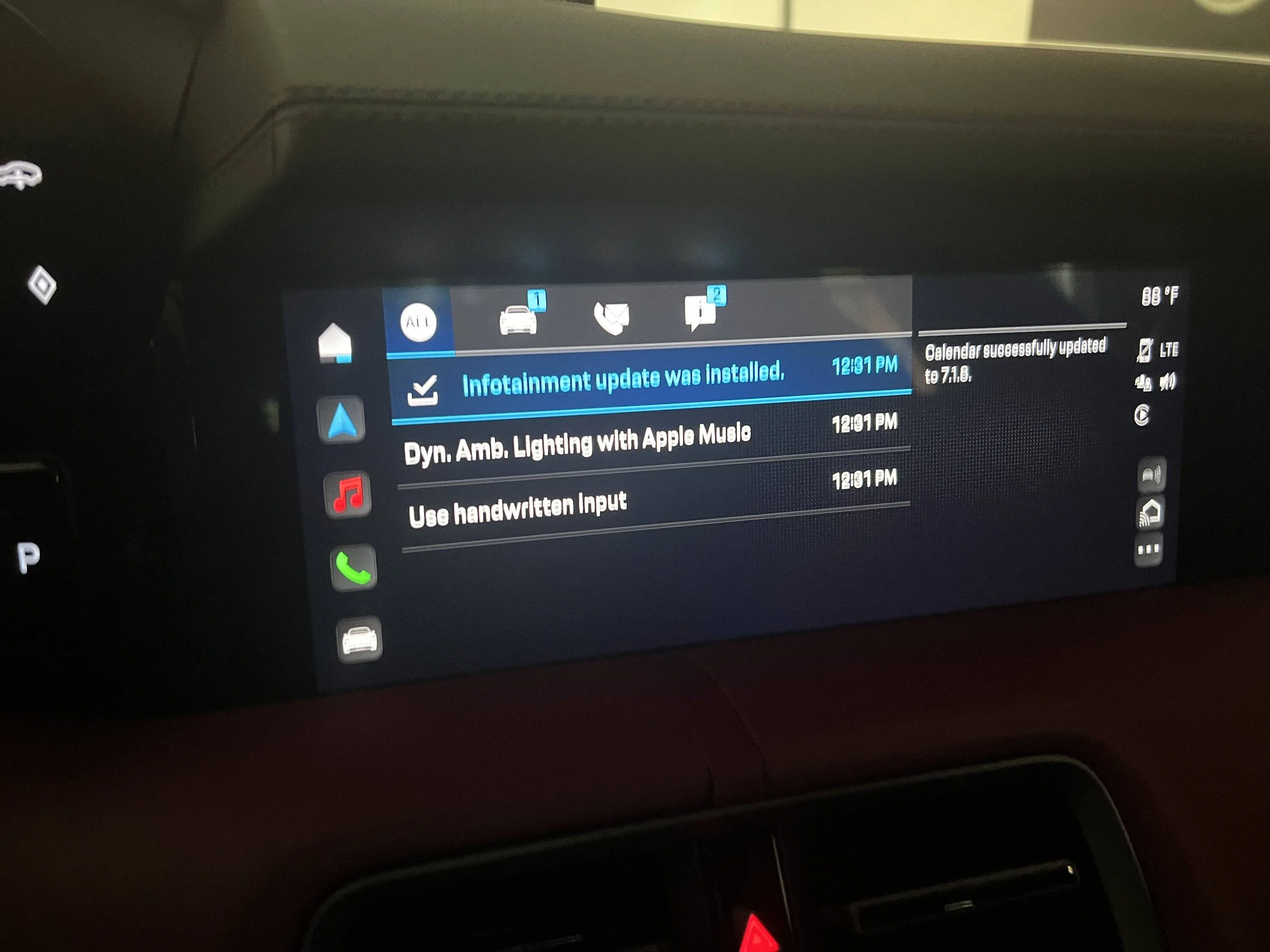

BTW - here is that notification re the separate unrelated Calendar update - new version. 7.1.8 - apologies re out of focus but grabbed it real quick!
That vehicle notification popped up but forgot to tap it and when I came back to review it it was gone! Now they're just taunting me :), or maybe it referred to one of the others listed (actually yes as of course All notifications listed! - more coffee).

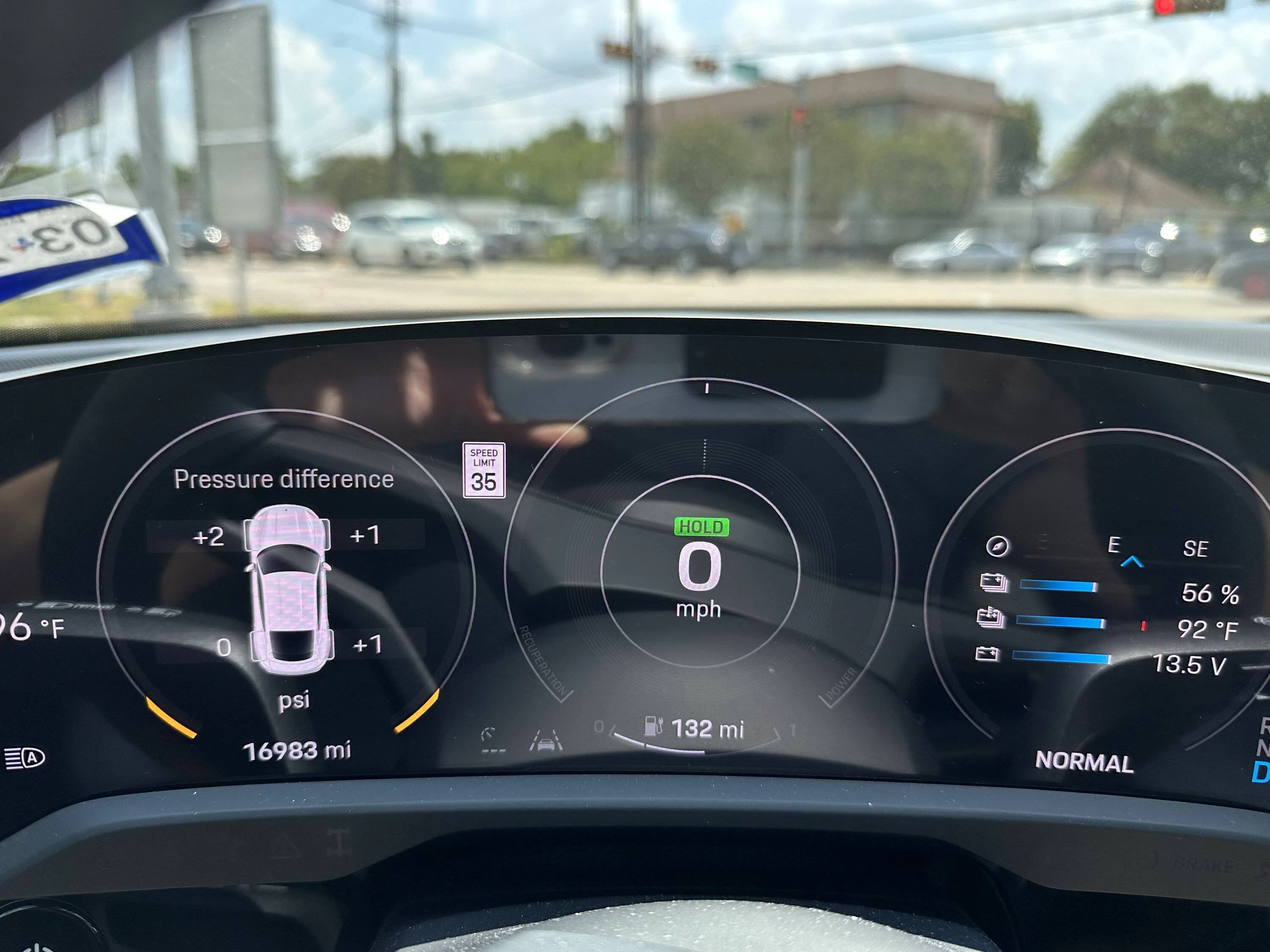

Did I already get the update because the tire monitor displays the difference in psi, and only while stationary?
If the OTA we're chatting about is indeed a future 'systems' update vs an infotainment update then no as the former will require your consent, stationary parked vehicle and for you to initiate after download to your vehicle.
If you're asking did the most recent infotainment Calendar update somehow change the settings on your Tire P display - don't know - perhaps? Can't recall but have you tried resetting its parameters back to what you had?

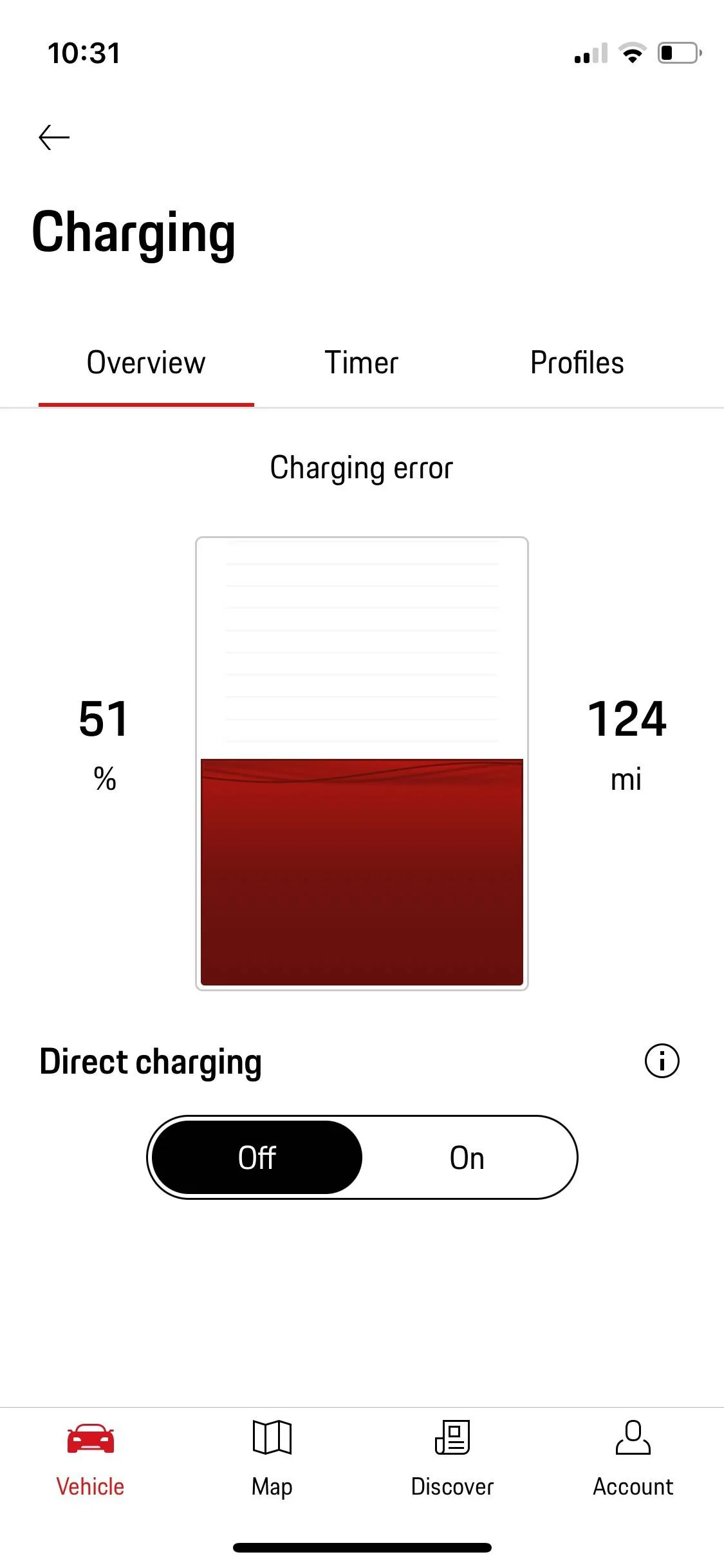

I got the charging error two more times. Charged to about 50% and then stopped. Tried in cooler temperature also. Took the car to the dealer for a service appointment today. They said they had to do a software update that was from 2022 and not an OTA update, which was surprising since my car was delivered in June 2022 and I hadn't received any notice about it.
Bigger issue is that beyond my screen shots of the charging error, the dealer wants to replicate it. He wants to either drive the car or have me drive it until it is below 40% and then they will charge the car to see if it happens again. I was surprised they don't have a diagnostic system or the like to figure out if the charger or battery is the issue. He also seemed to suggest the car might have to stay at the dealer for "awhile" while they figure out the issue. Curious if anyone else has experienced this same issue and I could point the dealer towards how others diagnosed and resolved? Thanks.
Do you happen to remember if the icons in your PCM UI are monochome or color? There was a monstrous update in that general era that (among many other things) made the icons color, which is why I ask.
All color. I think mine was one of the early ones that came after that update.
