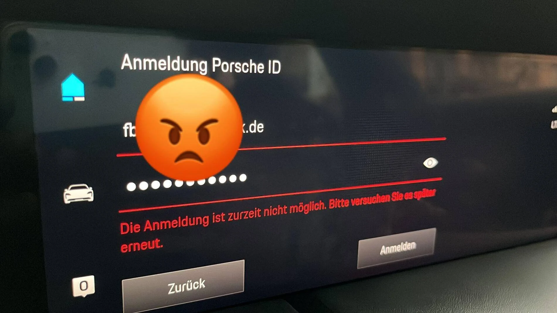

I also run into exactly the same problems here.
Porsche+Dealer are informed but clueless, writing tickets, but nothing happens.
Before deleting the car account I had traffic updates, streaming data, weather app, but NO data updates like SoC to the App (cloud profile). interestingly enough I was able to send destinations to the navigation.
I did virtually everything before like reset 12v battery, log to guest account, privacy etc.

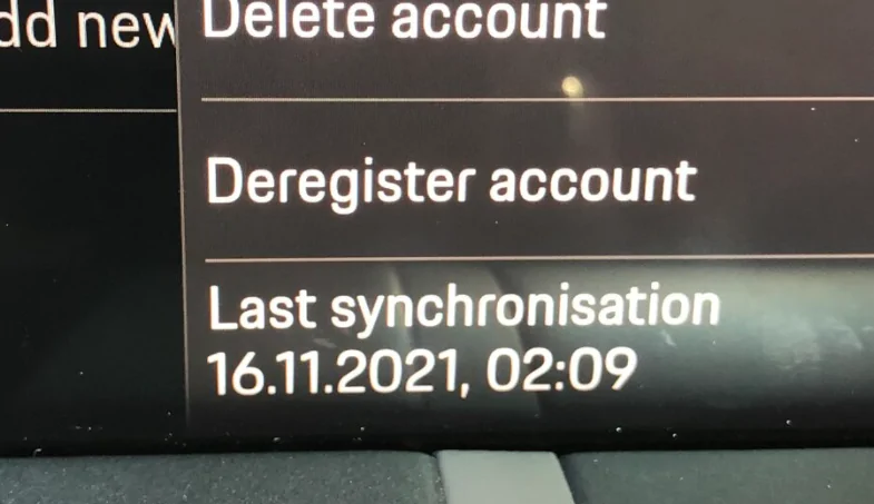

I never noticed the "last synchronization" tag of the account's drop down menu. Is it new?
Porsche Taycan PCM connection to Porsche Server 1637395686390
Will check this, but it was obviously more than 2 days ago.
The idea with the key fob is new for me. Will try that very soon. But you never know if it's coincidence as many glitches heal themselves after 1-2 days.

login successful today, no changes, only waiting a day, some struggles with Apple Music login, PCM 2 finger reset helped.
I intentionally did not use the 2nd key fob as I wanted it not be mistakenly see it as cause.
Will try it next time, when the errors happen (and they will).
