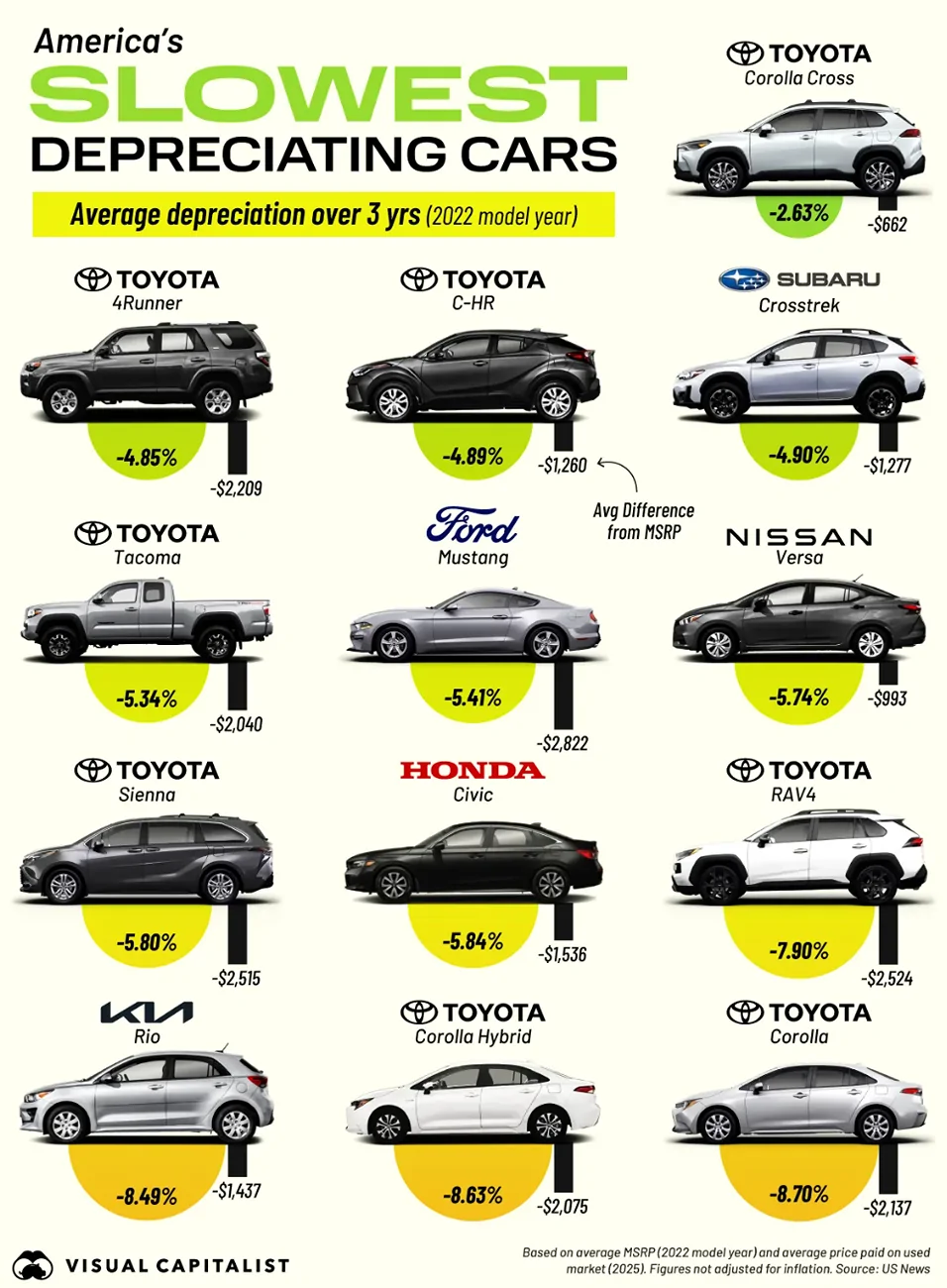

Back in the day bought my Audi S8 with 60000km for 33k, it was just under 5 years old. The new price was also 140k.
Seems completely normal to me, I'd say the Taycan did better than my S8.
If you want appreciating assets, buy real estate or gold or something. Cars are just a waste of money anyway - except perhaps the collectors cars, but Taycan is never going to be one of those.
You are correct. Cars depreciate, higher end, new 4-door cars especially. My 2001 911C4 depreciated 50% in just two years. I sold it in 2003 so way before EV boom and Chinese competition. Some people’s price perceptions got skewed over COVID, and internet is using this to hype up "massive depreciation". Or, perhaps Porsche is now attracting customers from cars like below, and those customers scaled their depreciation expectations from say a Corolla to a Taycan.
Porsche Taycan Porsche Taycan never again 1760783846529-vn
