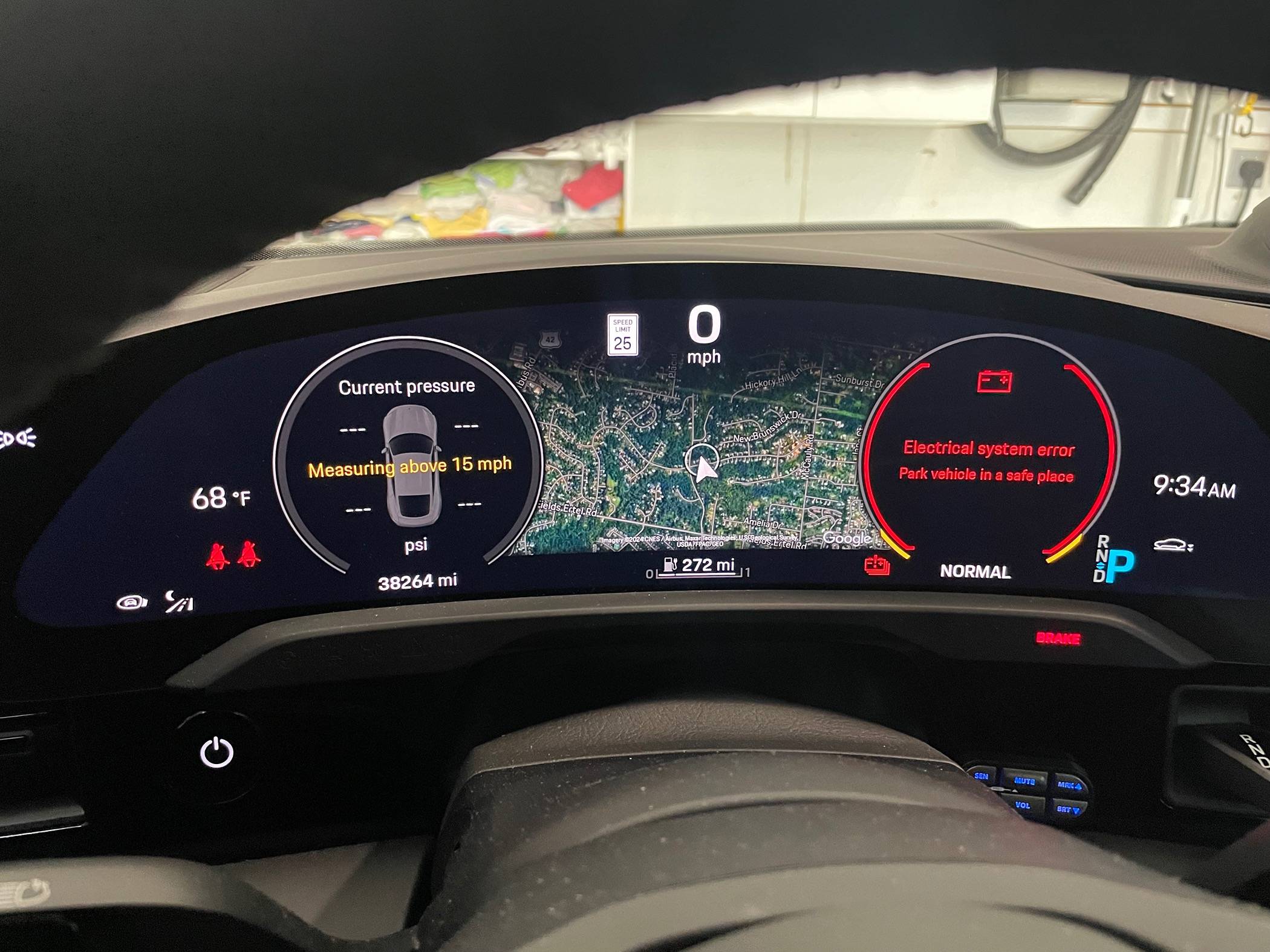

I'll just restate what the Porsche Battery Technician told me so we're clear on the specific Porsche battery rebalancing. There is no rebalancing unless the car is in the 'idle' mode - (car is off and not charging), and it takes several hours to do a proper rebalancing - this the reason to let the car sit, disconnected from the charger, overnight. The BMS system will balance the cells at whatever the charge level is.
For a 100% charge, the battery will charge until the highest charge cell is fully charged, and will discharge until the lowest charge cell is 'empty'. This means if the cells are at different voltages, charging the battery to 100% will only charge the highest charging cell to 100% - all other cells will be somewhat lower. Similarly, the battery will discharge until the lowest charge cell is 'empty', meaning all the other cells will still have some charge.
Balancing of the cells will insure that a fully charged battery has the highest charge in all cells at the maximum charge, and will discharge to the minimum level of all cells when fully discharged.

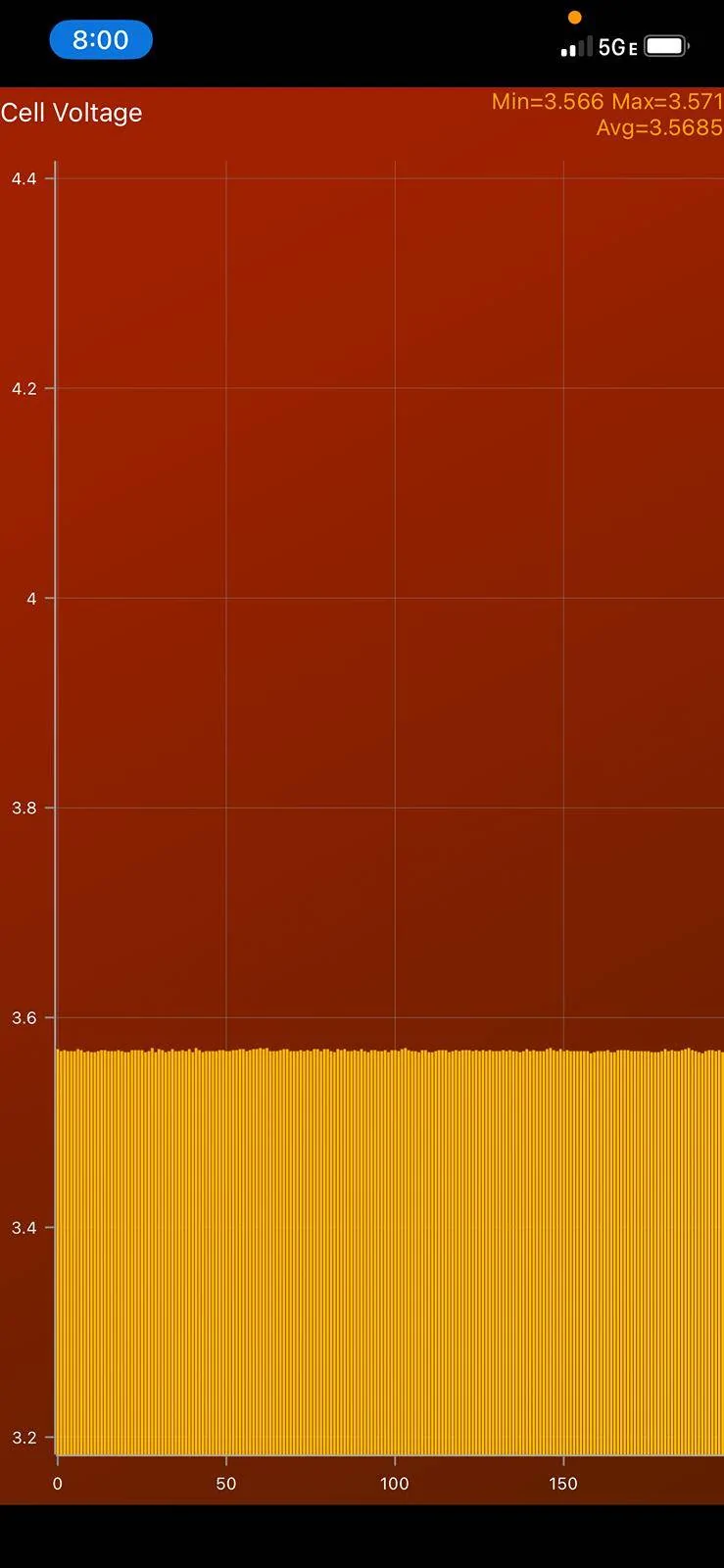

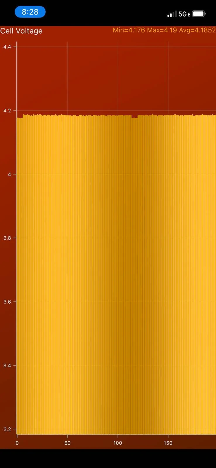

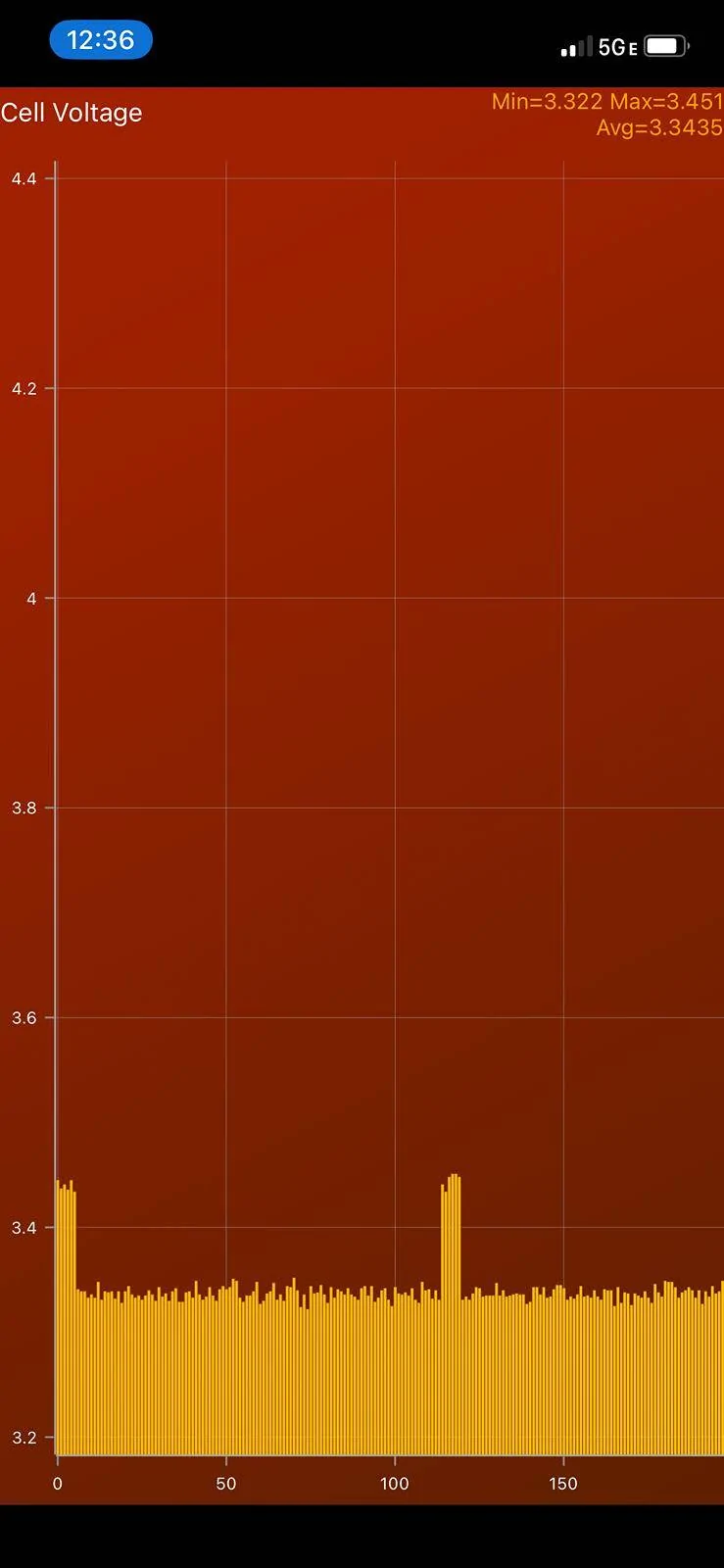

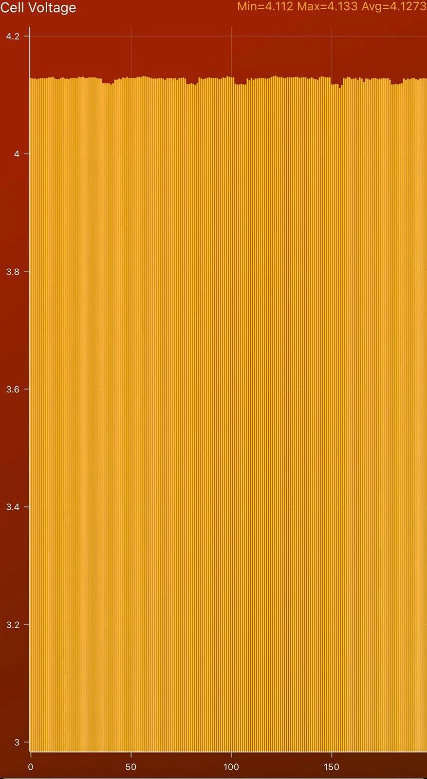

I do not have inside knowledge about the Porsche battery management system specifically. But I do build lithium batteries, and in doing so commonly start out with not-quite-balanced battery packs, and I have a technique that may apply to the Taycan.
The Battery Management System (BMS) has a "balancer" function to bring each of the cells in a pack to the same voltage. It does this by drawing current from the highest voltage cell and stuffing it into the lowest voltage cell until they are all at the same voltage. But there are limits to this process:
1) It only starts when the battery is fairly full but not entirely full. Balancing generally DOES NOT happen at low states of charge. The exact start voltage is a configuration item, but balancing might start at 80% or 90% charge and it might or might not end before the pack is at 100%.
2) The amount of current that the balancer can draw from a battery is typically VERY limited. It works nicely to keep a well balanced pack fully balanced, but the current is likely too low to bring a not well balanced pack into proper balance under typical conditions.
Because of the above, balancing your pack might best be done by:
1) Draining the car to say 70%
2) Charging up to 95-100% at a VERY low rate so that you give the balancer plenty of time to work. As in charge at 1KW or even less, not your typical 9.6KW to 19KW.
3) Repeating a few times if the voltages don't fully converge.
The above said, your pack is only ~0.01 voltage off of balance, which I doubt would itself cause any type of error to be thrown, much less one with "death" in its nickname. I would guess that your problems are worse than just a slightly off balance battery pack.
By the way, I take back what I said above. That is called "top balancing" and it appears that Porsche instead does "bottom balancing". With top balancing the BMS works to equalize cell voltages when the battery is nearly fully charged. With bottom balancing the BMS works to equalize cell voltages when the battery is nearly fully discharged.
So the way to let the Taycan balance the pack is to discharge the battery quite a bit, to say 10%, and then let it sit there NOT charging for quite some time - typically many many hours to a few days depending on the level of imbalance and the capacity of the balancer.
