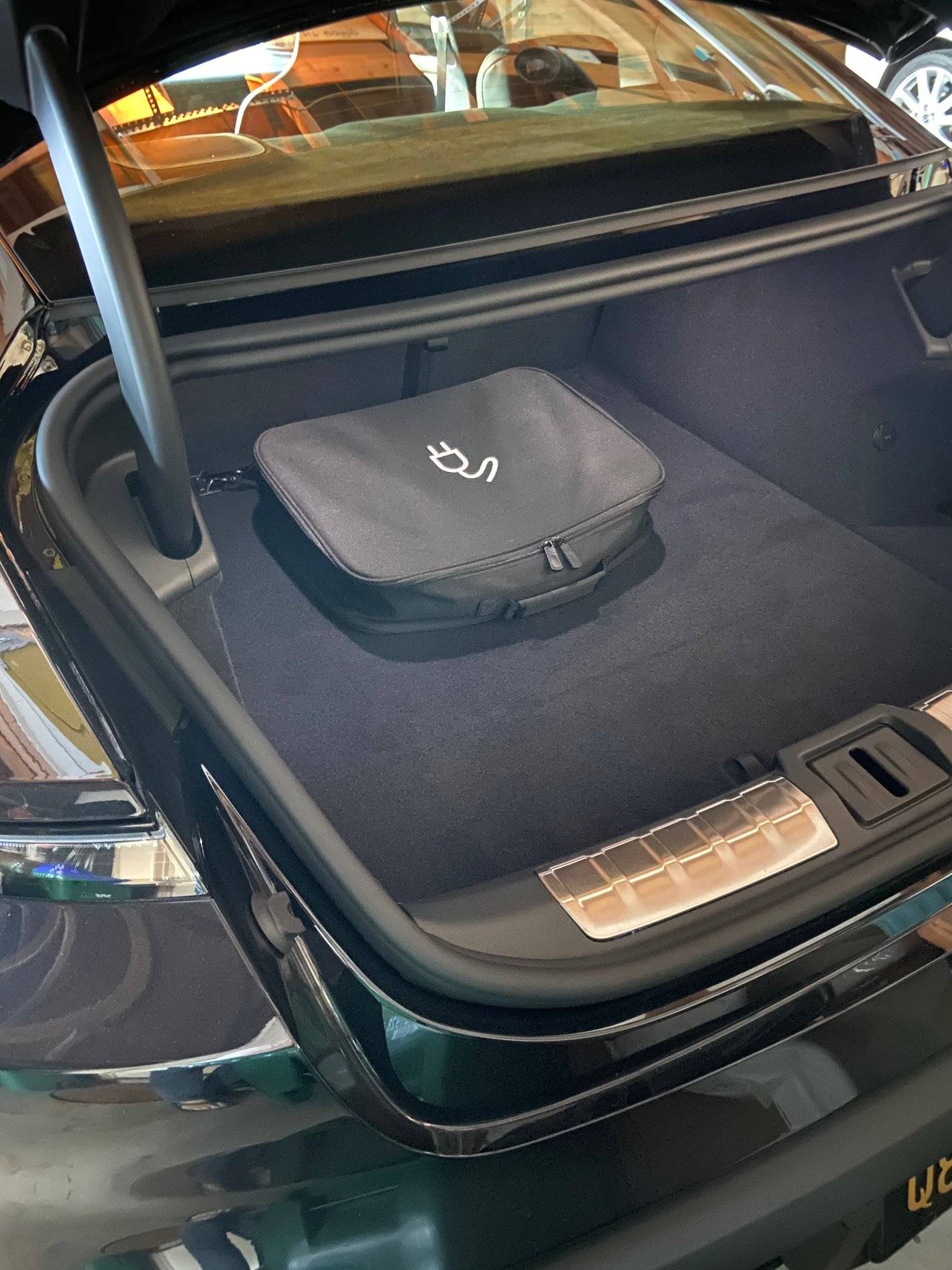

Being the local test subject for owning a Taycan, I have had to learn the whole charging subject from scratch. This has been a great discussion, and Ron you definitely have a handle on the subject. My car came with the Porsche Mobile Charger Connect, the brackets, a couple of cables and two thick books (manuals) on the subject. All of which were in this heavy canvas bag clipped into the back of the trunk.
The 25 ft cable was not part of the package, and having decided I needed one to be able to charge while up at my brother's house, I asked if I could get one as a "no cost option" as it is shown in the build page. Because it was not part of the original build, no, I'd have to order it.! Yikes! It is beyond pricy!!
Order the 25 ft cable while you can!! As a no-cost option, it is a no brainer, and believe me when I say you will not want to buy one later!
So here is the cool bag you get with the Porsche Mobile Charger Connect.
