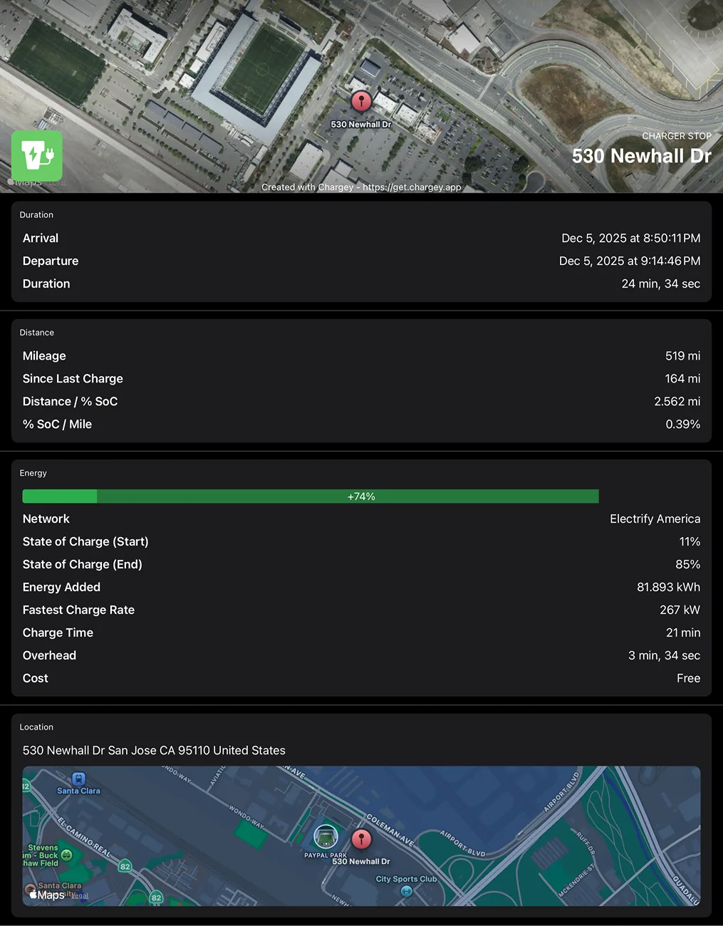

I recently sold my 2023 GTS and acquired a new 2025 GTS.
I flew to Ontario (California, not Canada) and drove it back home to Los Gatos.
I was very impressed with the range improvements. Shockingly so.
First, the trip report:
I started the trip with a visit to Starbucks down the road, where friendly forum member @Zcd1 met me for a great chat about EVs, life, the universe, and everything. Thanks for meeting me!
Fueled up with caffeine I started the drive home and was surprised to see the PCM routed me through…a Tesla Supercharger! Electrocute America was next door, but I decided to tough out the Supercharger out of curiosity.
This is how that charge session went:
Of note:
- The charge was initiated with the My Porsche app
- Speeds were comparable to the J1 with 150kW/400V option
- I tried to see if Plug and Charge worked, maybe I didn’t wait long enough but it didn’t look like it was getting past “initializing.”
- This session was not free, so the free Porsche Charging Service does not extend to partners.
But that was it! This was my only charge of the trip.

- Fast charging deeper into the curve. I tested an EA station after dinner tonight and went from 11% -> 85%. I was quite shocked at how long it held 260kw+ (which was station-limited). It held that rate all the way to 70%.

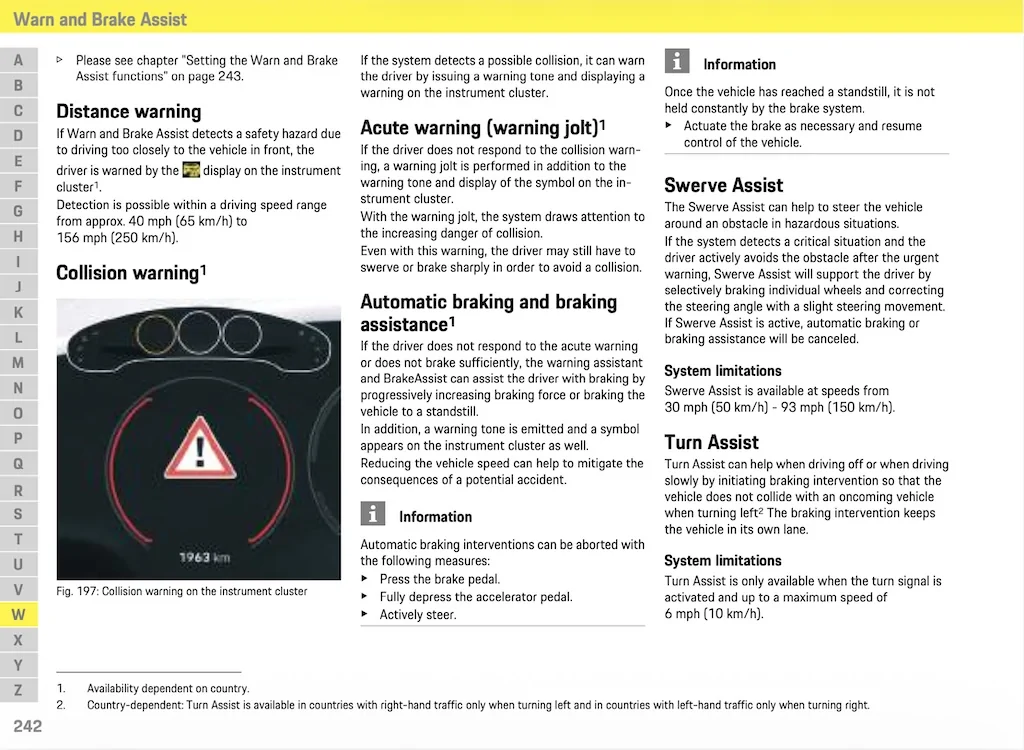

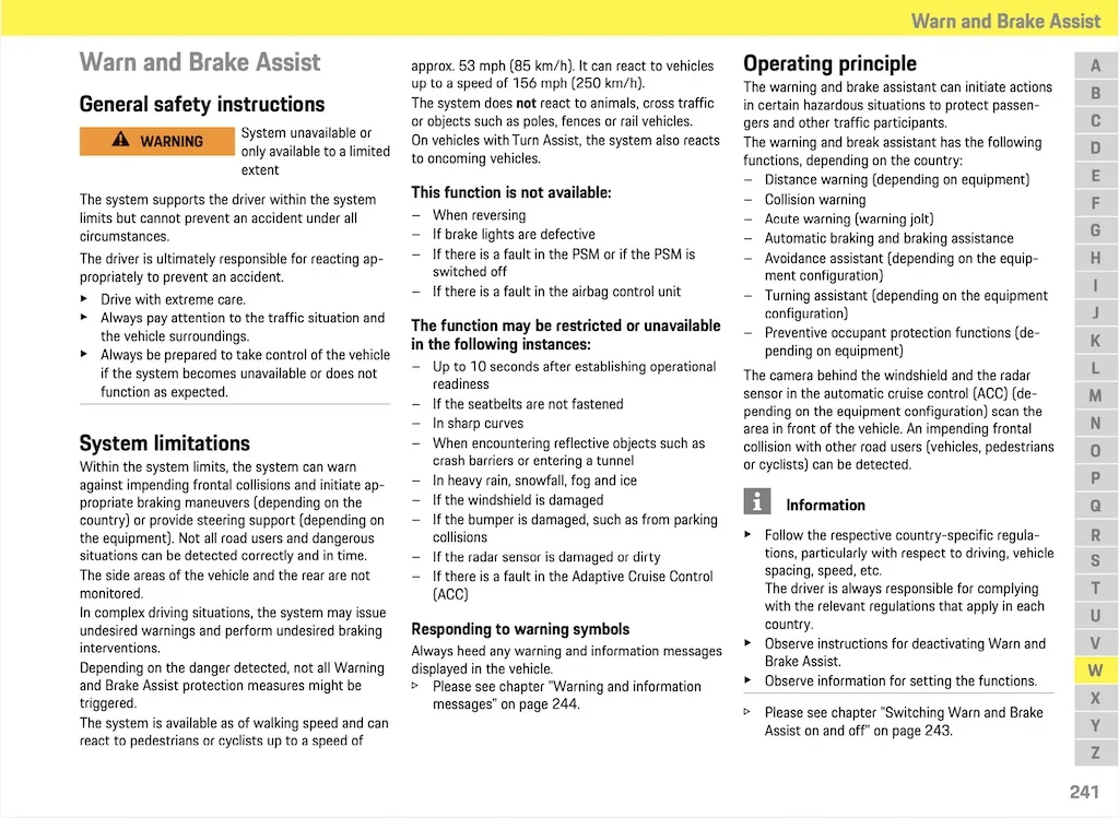

Night Vision Assist is just the visualizer component to the standard Warn and Brake Assist, which can brake to a stop.
I've triggered it coming around a corner to see a stopped line of cars ahead, also the 18-way Adaptive Sport Seats pulled in the side bolsters.
The feature works both with the standard camera and optional radar (ACC) systems.
Not sure what you mean by NVA "is just the visualizer component to the standard Warn and Brake Assist". You participated in this thread where someone needed to replace the Germanium window over the optional night vision assist infrared camera, which is not included with warn and brake assist:
