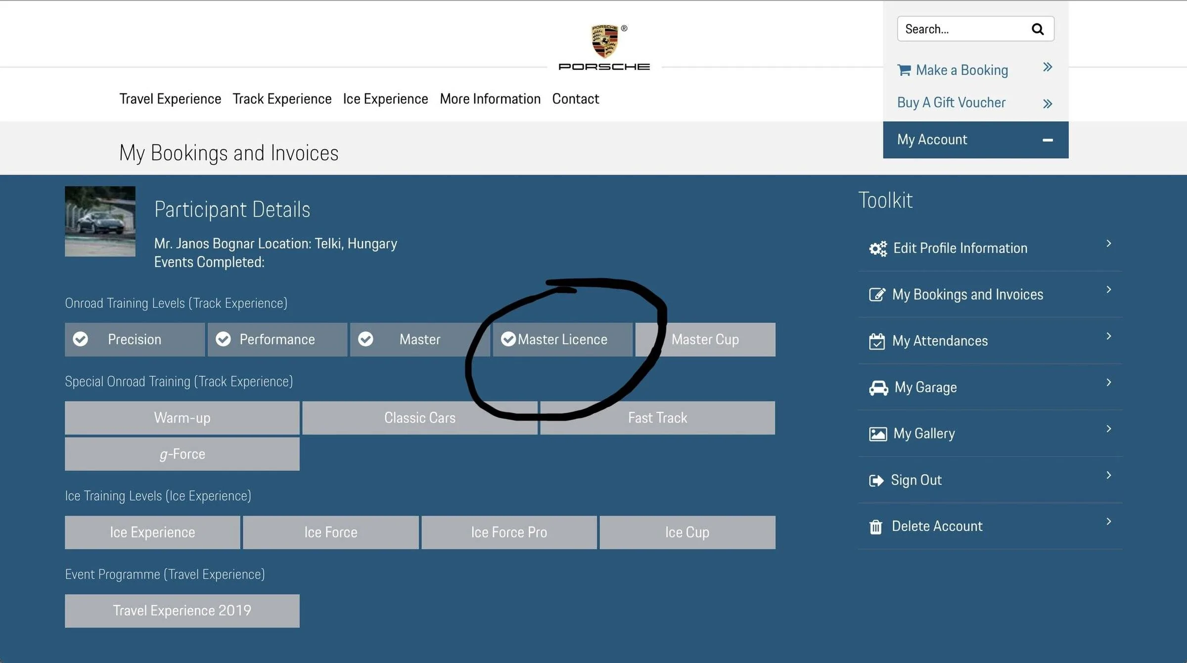

(I am a German racing car licence person by Porsche)
Porsche Taycan Taycan GTS - to PDCC or not? 3765274E-9F3D-4E6B-9D4D-03793C7CFB7F

I know, I know... You do not get the sarcasm of it although emoji is there.
Just shared my experience with the OP that is it. Forums to collect information and pick up what you want. I am sure you are a fantastic engineer, and more.
OP asked value per money information PDCC, I shared, that is all. As I see people come with preconceptions and only want to see verifications. As soon as see opposite become nervous. So why make a question if not interested pro/con....
I have close relationship with Porsche, have approach to track tests road tests all the models and have access to Porsche factory engineers. Informed well with future things, see my posts on GTS as date of introduction, kW etc.
But will be quite from now on for sure, that is what I've learnt.
