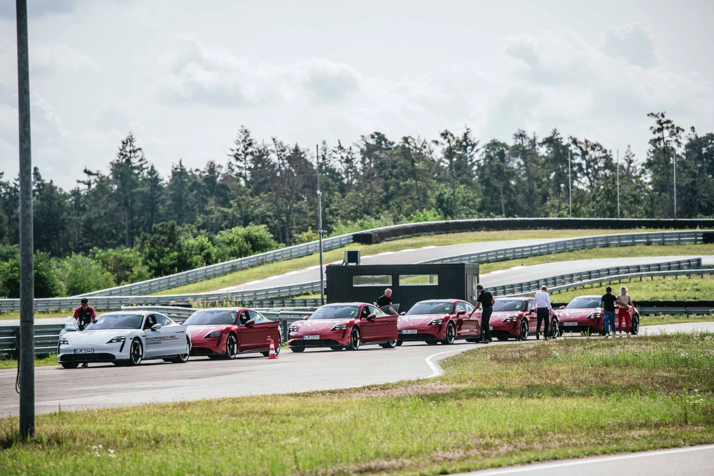

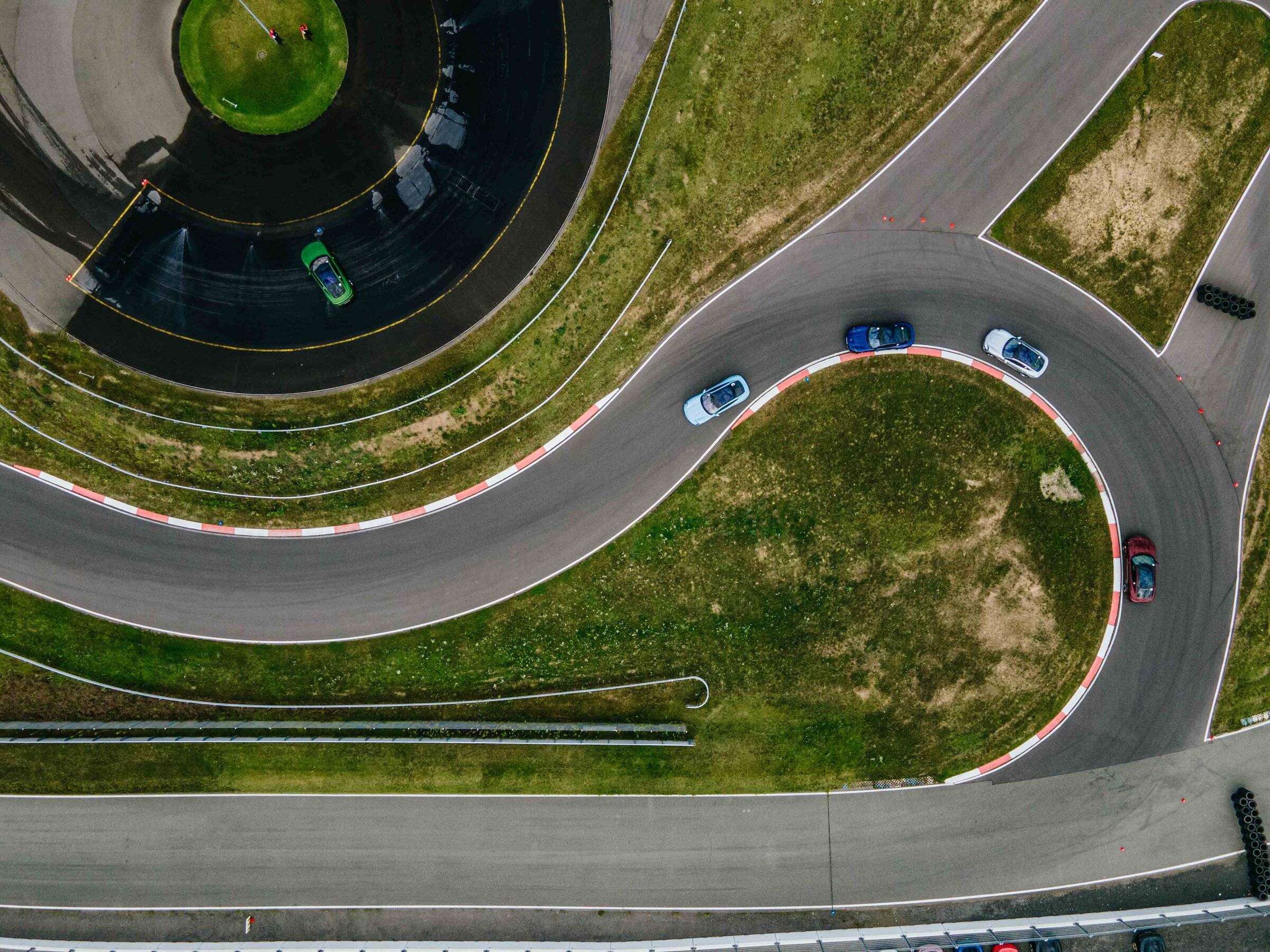

PEC is good, but according to my experience (PEC Hockenheimring E-Warm Up) they will have cars only with PDCC and -maybe- only Turbo S-s.
Can't compare, I am afraid.
