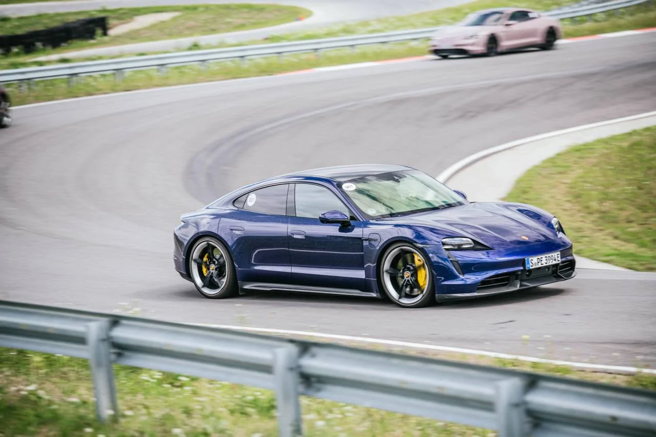

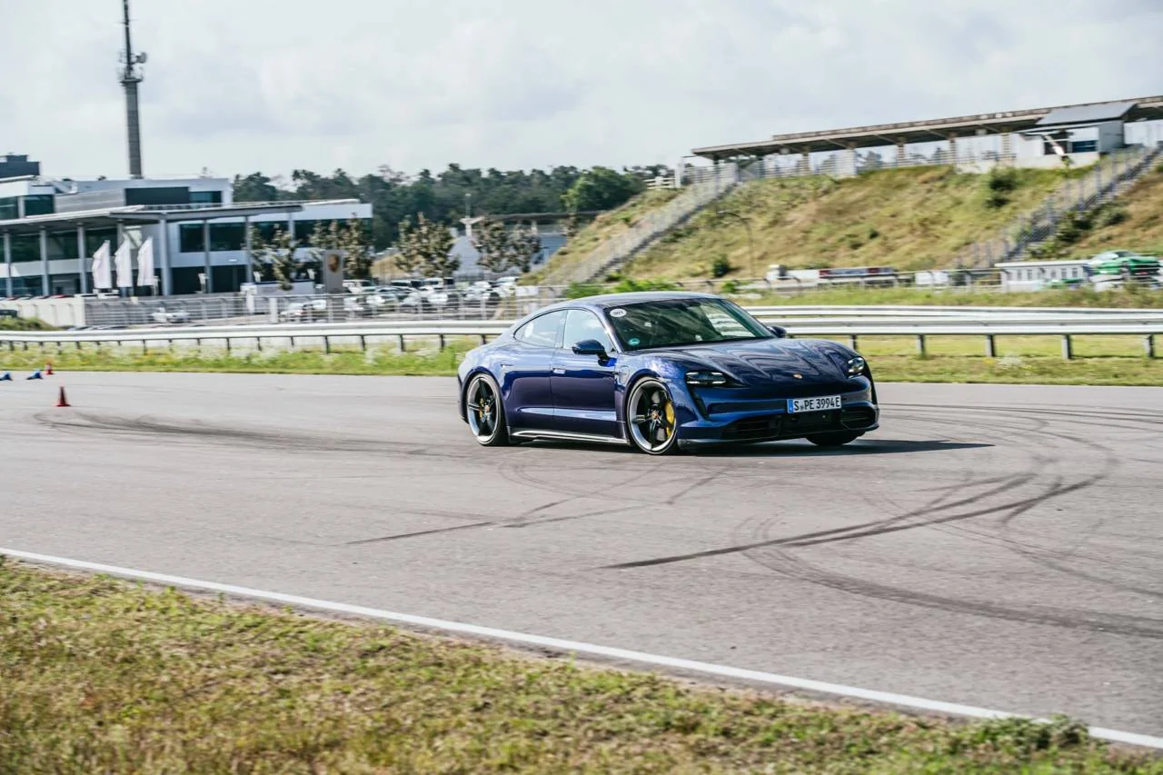

I am sorry but Taycan is a very safe and stabile drive car even without PDCC. This feature is simply not able to "bring a LOT", it is not true. As you subscribe your driving style, you should feel nothing. It starts to become sensitive on spirited drive with relatively high G forces. Otherwise it has no function there is no body roll to dynamically compensate. On NORMAL mode it lets more or less the same body roll than without it. It stiffen up in SPORT and SPORT+ modes (offering higher stabilization forces on the ARB).
The attached 1st photo shows my drive testing the PDCC system on PEC Hockenheimring in a Turbo S NORMAL mode. You can see significant body roll against of PDCC.
Than 2nd photo on track (much higher speed/G-force) in SPORT+ where body roll is less. This is when PDCC is working on "full". NORMAL mode/normal drive it is simply not noticeable.

i can see on a display, how PDCC works….
i can feel in every bend that I’m going through….
i can also monitor G force…
… and you are saying that’s not true.
OK, I rest my case, you won.

As I mentioned it at very first, I offer PDCC on higher ride/center of gravity cars. CT is a little bit on that end. For that (CT) I rather propose it/would choose.
But come on, this post is about GTS ...
Overall feeling a "lot" in every bend normal drive (compare to same car w/o PDCC) shows extra high sense of drive. I am not on that level honestly.

Keep in mind that the suspension spring stiffness is also adjusted with the drive modes (this is the multi chamber at work), so your overall roll stiffness is not only due to PDCC.
My CT has PDCC optioned and it actually feels pretty similar to the non-PDCC sedan I wrangled through the canyons. An owner/engineer who is sensitive to suspension frequencies and damping will feel the difference for sure. For me it actually feels a little under-damped in the normal mode which I’m more sensitive to than the wheel rate honestly. They’re both smooth, but the non-PDCC had 19” wheels which may have contributed.
I don’t think the difference is too large, but I will say that my PDCC CT corners flatter and is more responsive than the non-PDCC sedan in the canyon setting. That said, I’m a little old school and I actually appreciate a little bit of roll and settling into corners.
